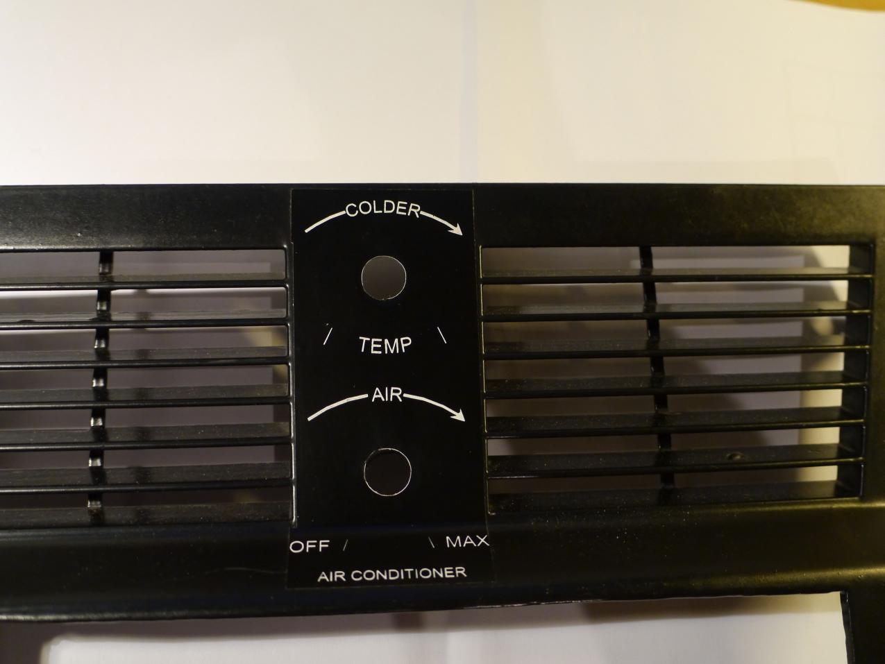

Has anyone tried painting the AC vent plate and/or heater face? Can you buy or has anyone made replacement stickers?
I've been trying to upload pictures but I cannot get these to upload. Will try and post later.
I believe the lettering is stenciled on, making this more difficult
Console sides and dash now back from Bucket Stitch and befitting of the dash from Bela. I'm not sure how well the stitch matches what was original, but the vinyl match looks perfect. Dynomat installed along with the evaporator and heater box. Coupe King supplying the switches for the AC and Fan and hopefully I can clean up the knobs.

Hi!
I made a replacement sticker for my AC console. It's made in matt black and white letters and it's hard to see the difference between the original and this one.(Can supply with photos later this month).
The sticker where made with a laser engraving machine.
Henrik
I had Troy send it back. He could have done the artwork but creating a stencil and then painting each piece was too much work, especially with the uneven surface.
Mine are now at the painters. They are going to see if they can make a stencil. I'll post updates in another week once I get some feedback from them.
Hi!
Here are a few photos of the sticker on the AC bracket. I think it´s very discreet and close to original. AC is not original in my car so I do not know the history of this console, but it looks like it has been powder coated one time or another.
Anyway, it has the same surface as the sticker ....
At first I thought I would make a stencil, but rejected the idea when I found the result was satisfactory. It is not difficult to make a stencil once the engraving machine has been programmed The laser can be adjusted to cut through the label instead of stopping halfway through. I´m not sure this is the way to go if the AC console surface is uneven.
