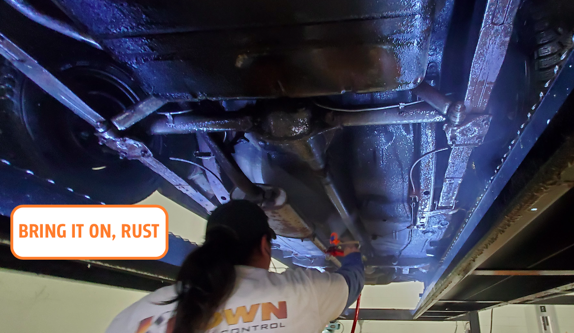

I like the idea of an oil undercoating to prevent rust. I’ve seen guys use chain saw oil. Key is that it thickens after it’s applied so it won’t easily wash off. The article describes how the oil goes on hot and thickens as it cools And they recommend annual application. One of their claimed side benefits is that it lubricates moving parts.

Anyway it’s an interesting process and seems preferable to the spray on tar-like undercoating.
