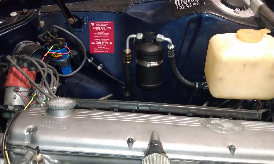

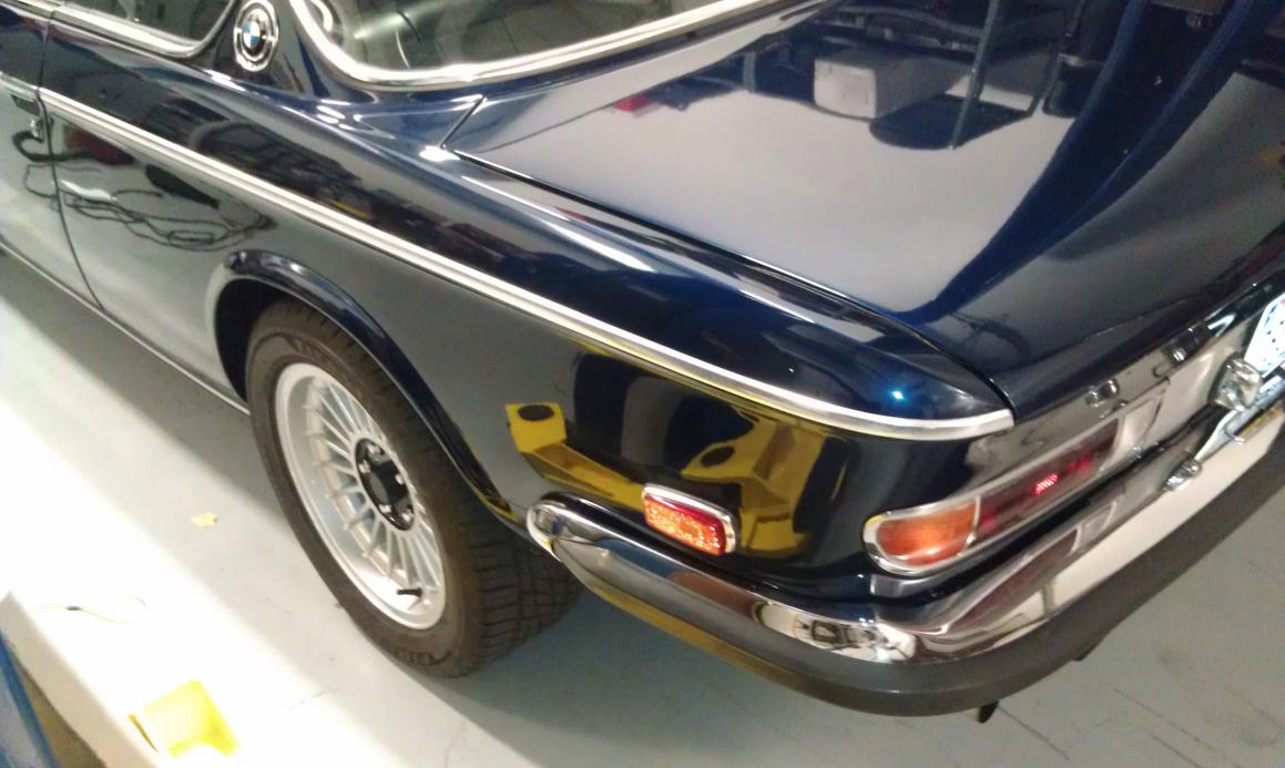

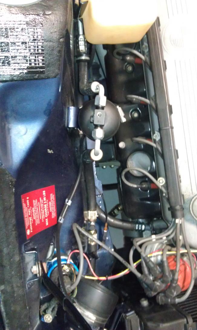

I'm sure to elicit lots of opinions on this but I have a dilema; I just had my A/C "overhauled" by our local guru -Terry Sayther's guys- It was all but replaced after not functioning for ???years. The A/C works great and on the 25 mile drive home my right arm had goose bumps while my left leg felt like it was under a magnifying glass. The outsidetemp was a balmy 101F. I hate the idea but I may have to have the windows tinted. This car is supposed to carry me to and from work every day so interior comfort is really important. Before I start shopping for tint I thought I would ask for suggestions/opinions. I included a shot for color.

I would look into the clear UV coatings they have now which would help a lot but not darken the glass which I am not a fan of.

Are you running R-12 or R-134? It will never cool you off if you have 134.
I'd recommend doing the heater bypass first, that removes a lot of interior heat.
