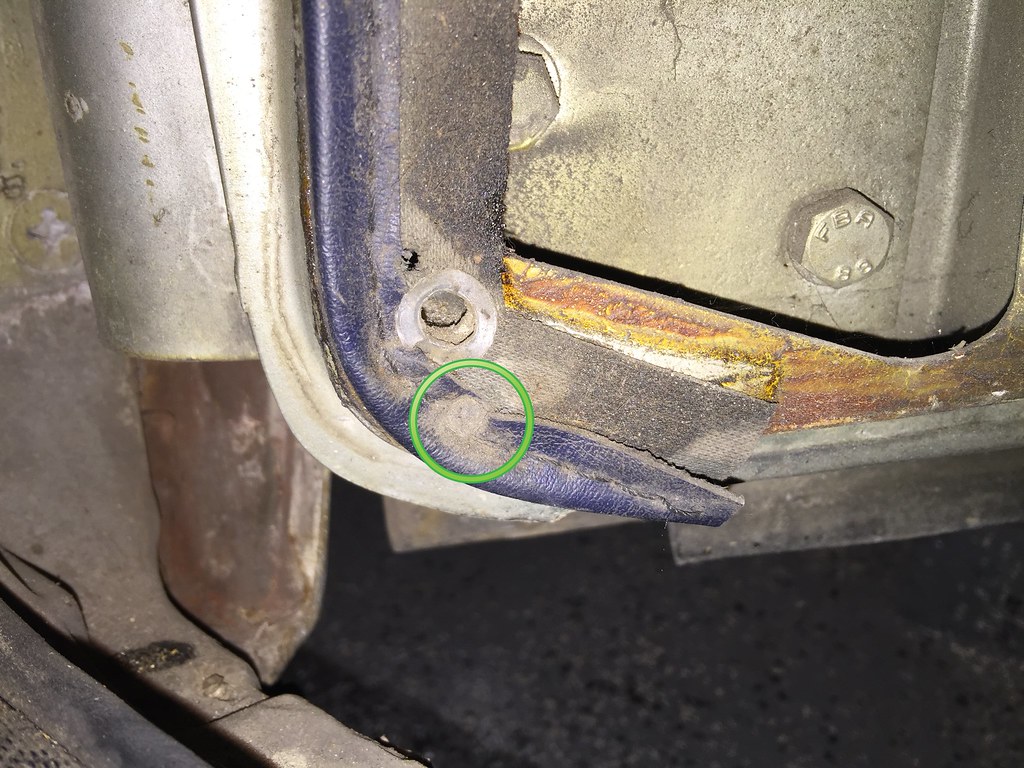

The door welts are held on by tiny black screws and adhesive. I took a pic in my deconstruction thread.

Working on the CSI tonight. I took a pic of the tiny screw that holds the welt in place. There is one at each corner of the door.
I just got my CSI back from coupeking and the reason it was there was due to the welt

I always thought it was attached to the door card but seeing the screw and placement in your picture makes sense. I think the welts really add to the quietness of the interior, my blue coupe is without them and the polaris coupe has them. There is a noticeable difference in the way the door sounds when it closes.
