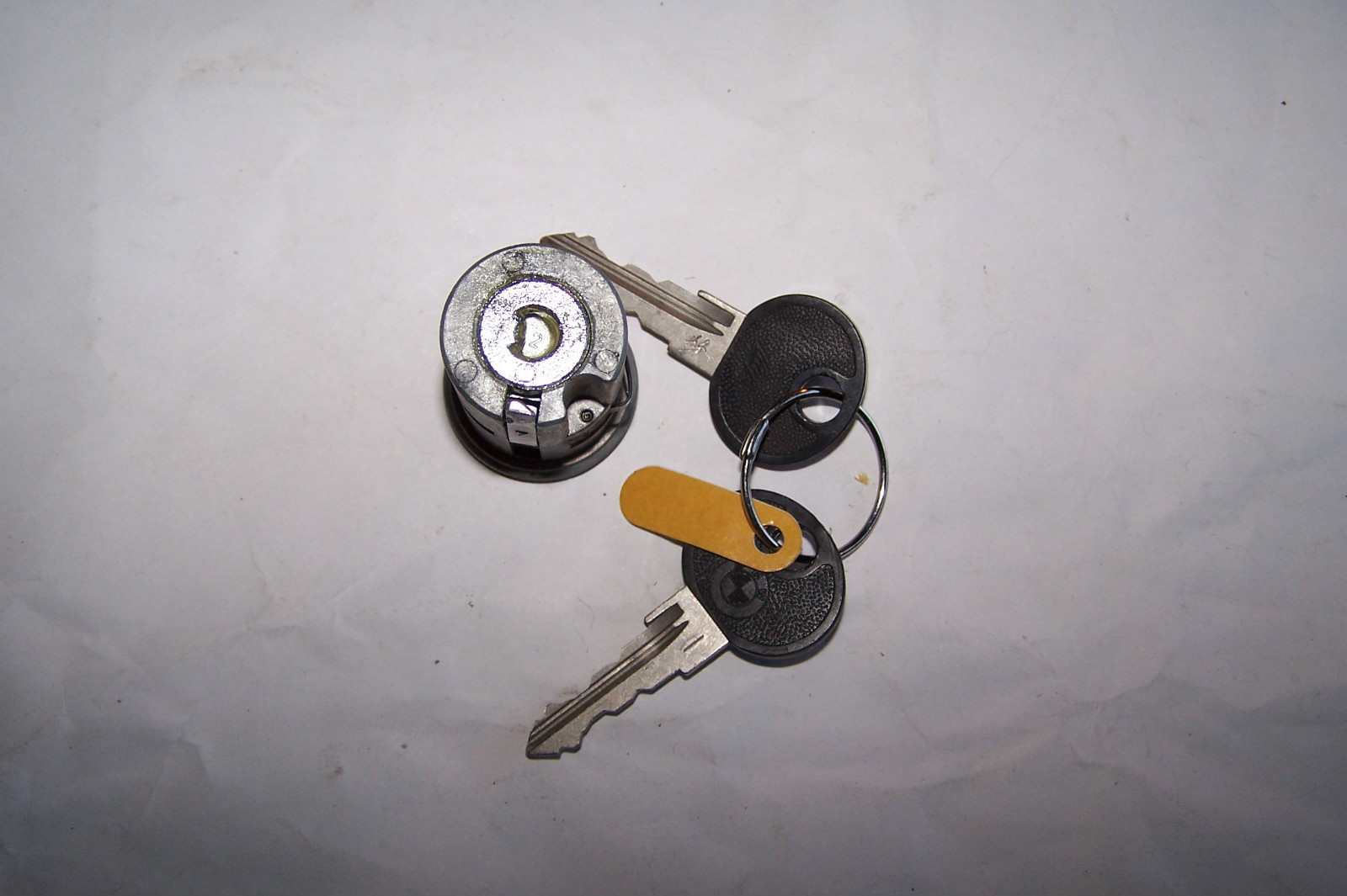

So after receiving the updated intermediate section, it is now completely clear that my ignition tumbler is also worn out. Compare the female section of my tumbler with an E24 tumbler from Ebay. You can see how worn it is.
Looking at the tumbler, it appears like it could be disassembled further (for re-keying). Is this center section available somewhere? Does anyone have experience repairing this issue? I'd rather not spend $200+ on a new key/tumbler from BMW for such a small part.
I buy and install new e12 lock and key sets.
55 bucks
Order a new lock and make a new key with the code on the lock
