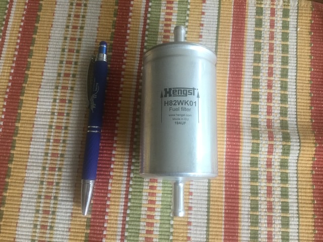

Here is a new one, pretty compact. You can breathe through it if you wish, very little to no resistance.
That’s the one I have too, new one seems to be working fine. Didn’t think of trying to breathe through it!
