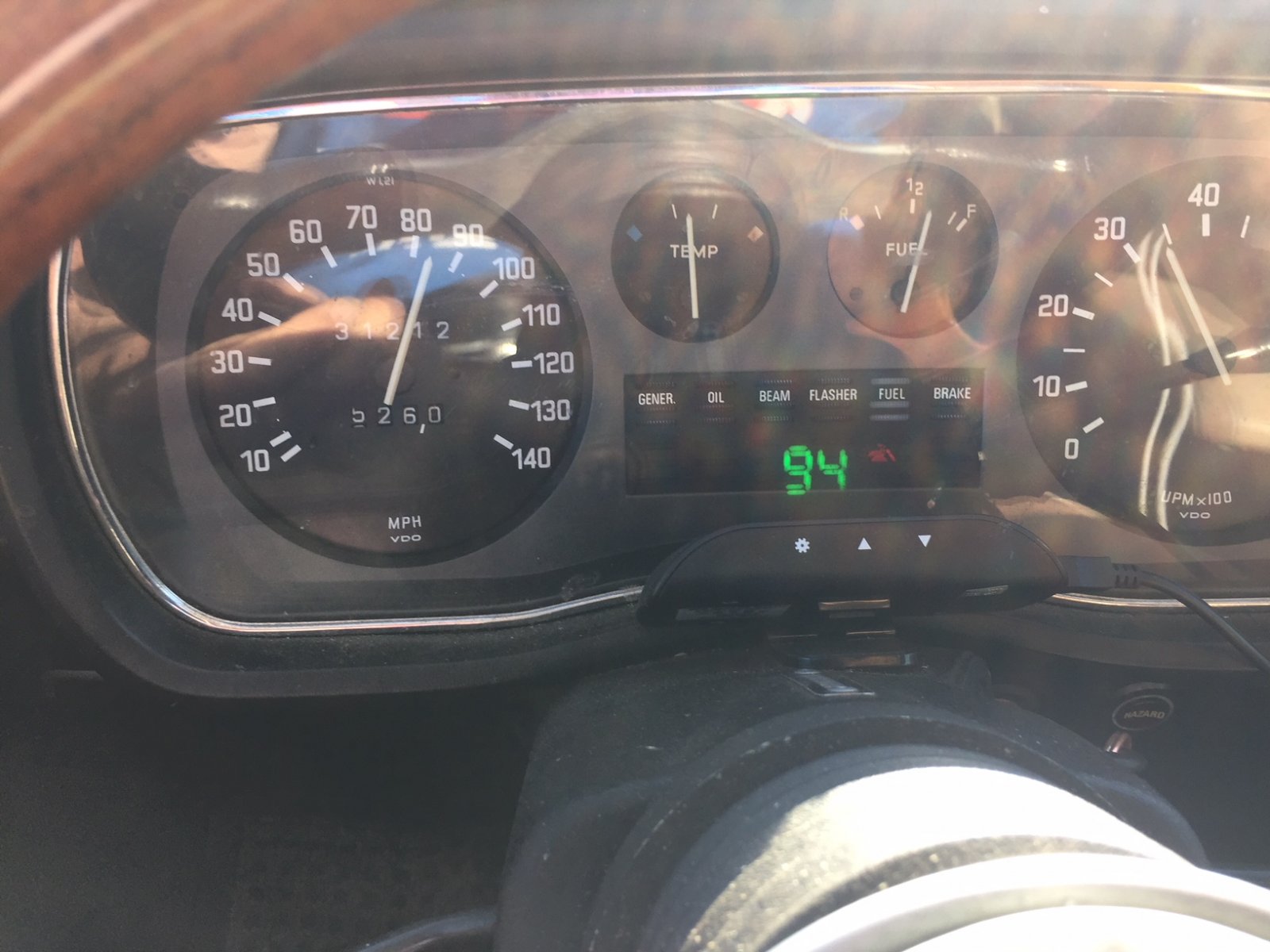

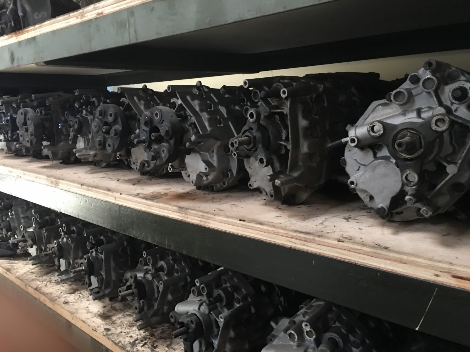

I got most of my trannys from the car’s sitting in the yards back in the day also, but that day is long gone now. When a car hits the dirt now at the yard, the tranny is stripped out by the prep guys. They know they will get 200 bucks easy out in the parking lot.
the good news is that they weren’t crushed- they are on racks waiting for an install.

Are those your racks?
