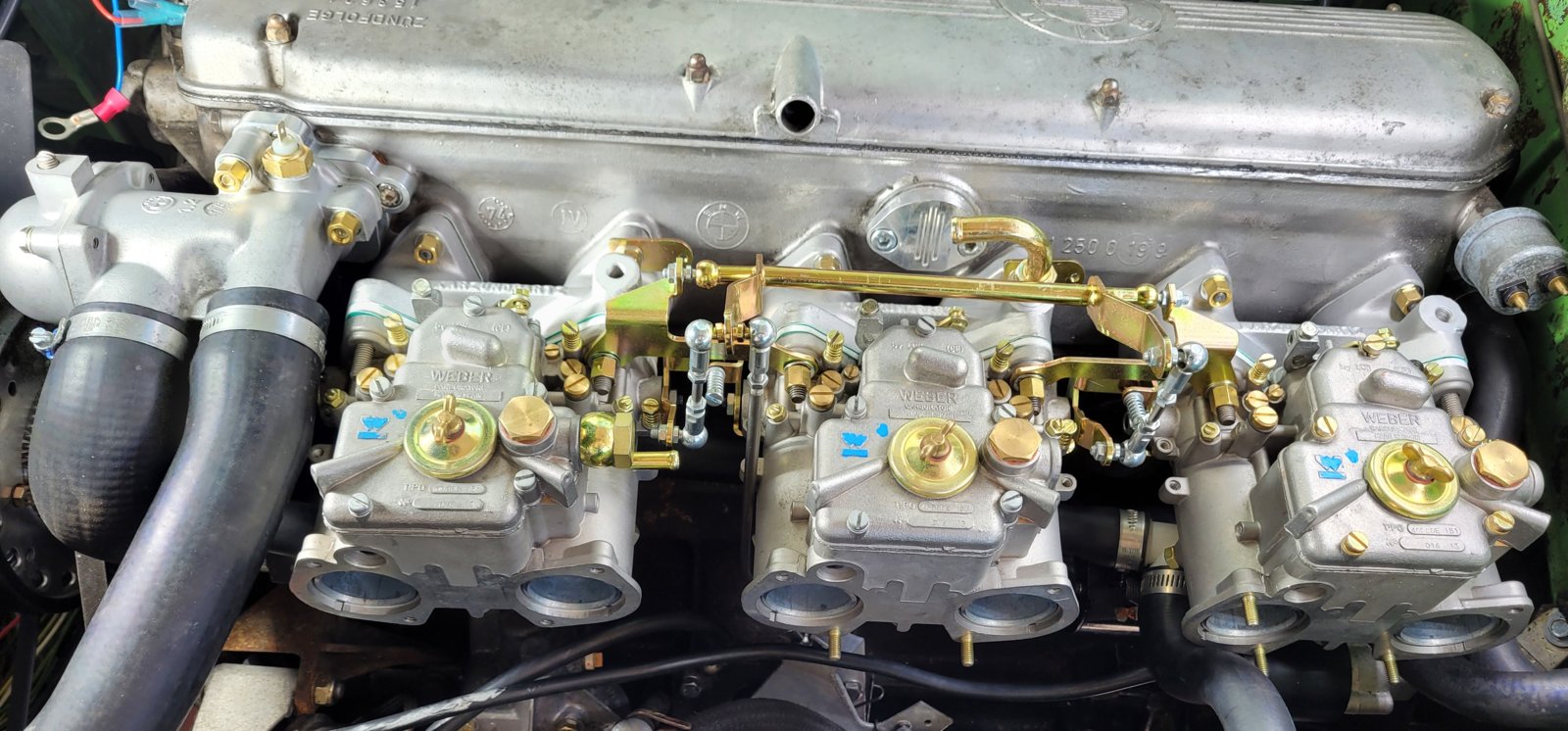

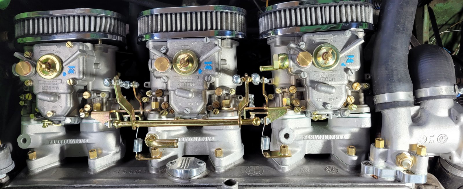

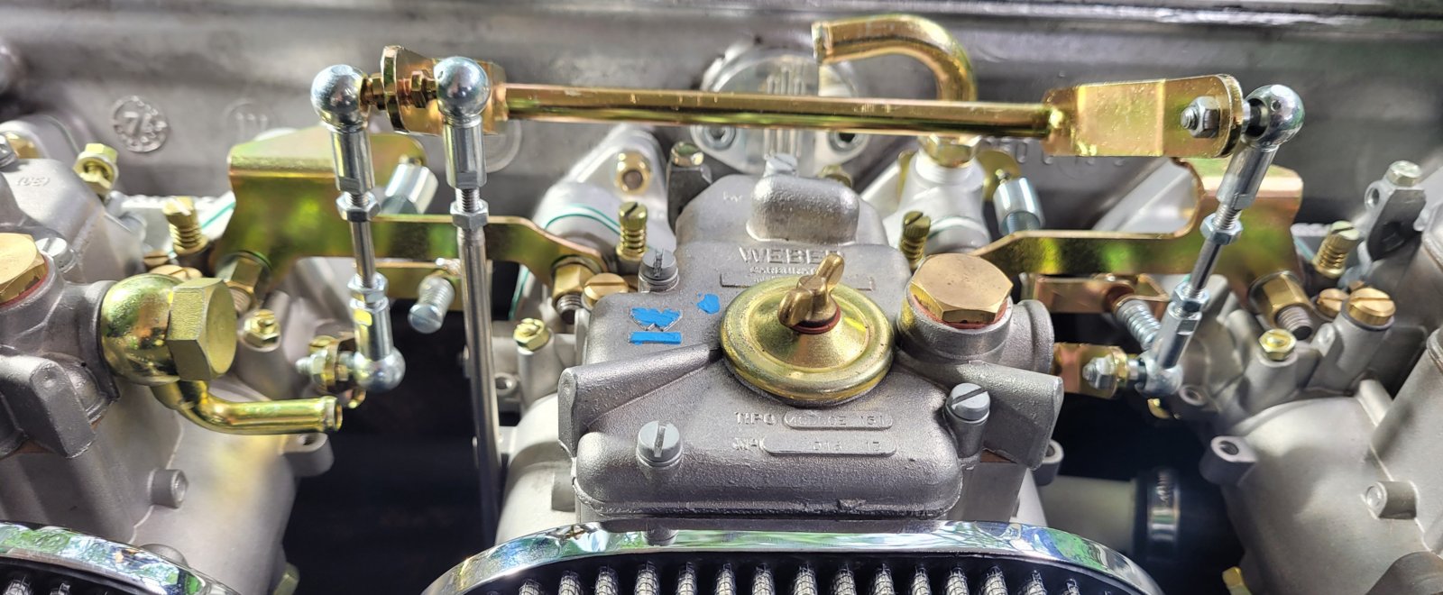

When you get to that point, be sure to check out our side-draft linkage system designed specifically for the M30s. Based on the 2002ti side-draft linkage, it is complete from the bell crank to the carb throttle shafts so no other parts are needed. And all synchronization is done on the carburetors, not the linkage so that once installed, no maintenance or adjustment is required.
We've been selling this kind of system for the 2002s for many years with great results. Here's some pics.
