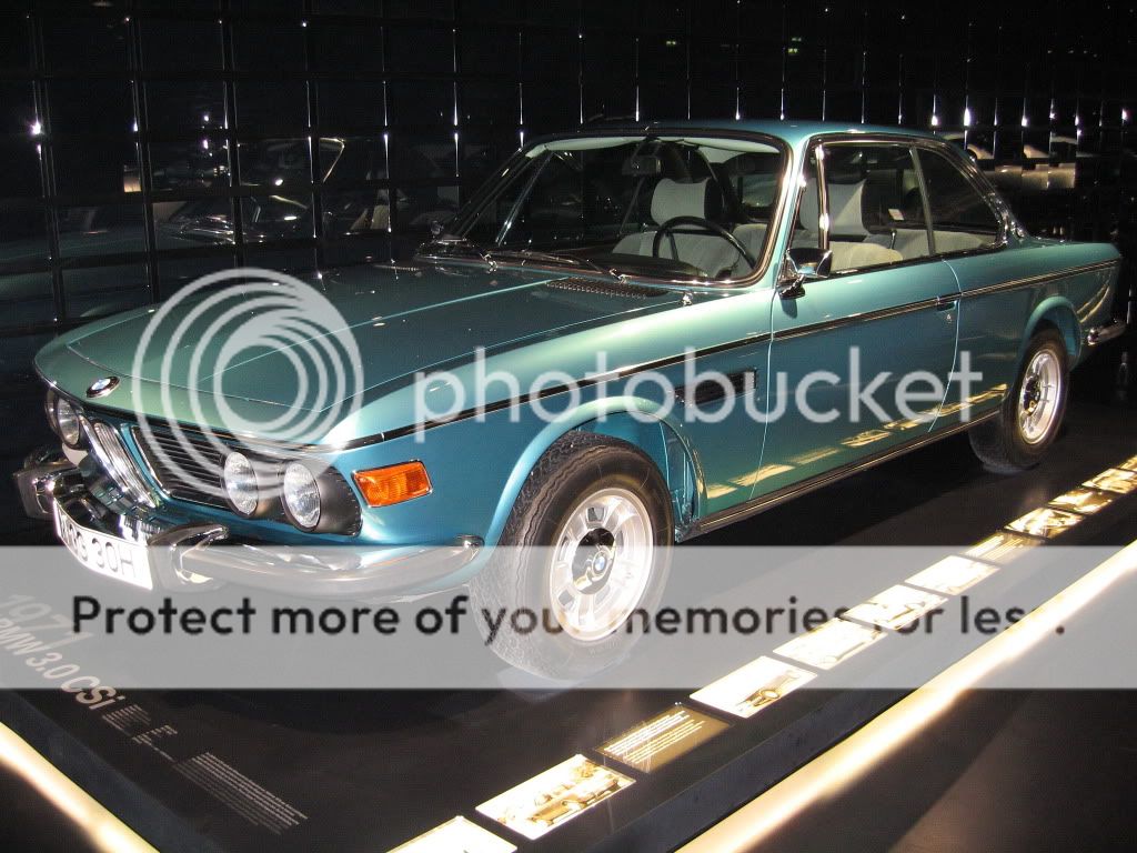

There are three examples of the Turkis color with black fender and hood / bonnet grilles, including an example displayed by the factory. I am not so sure these examples are definitive of any rule or reason as I am personally aware of a Turkis model (csi) that was delivered new from the factory - with chromed grilles, like this one:

It may not be obvious, because the room of the museum was dark, but the grilles are chromed.
Sehr gut! or is it Très bon?
Thanks for the clarification! The pictures are deceptive. I thought the grilles of the car you posted were black and that was the reason for the other posted pictures. :wink:
