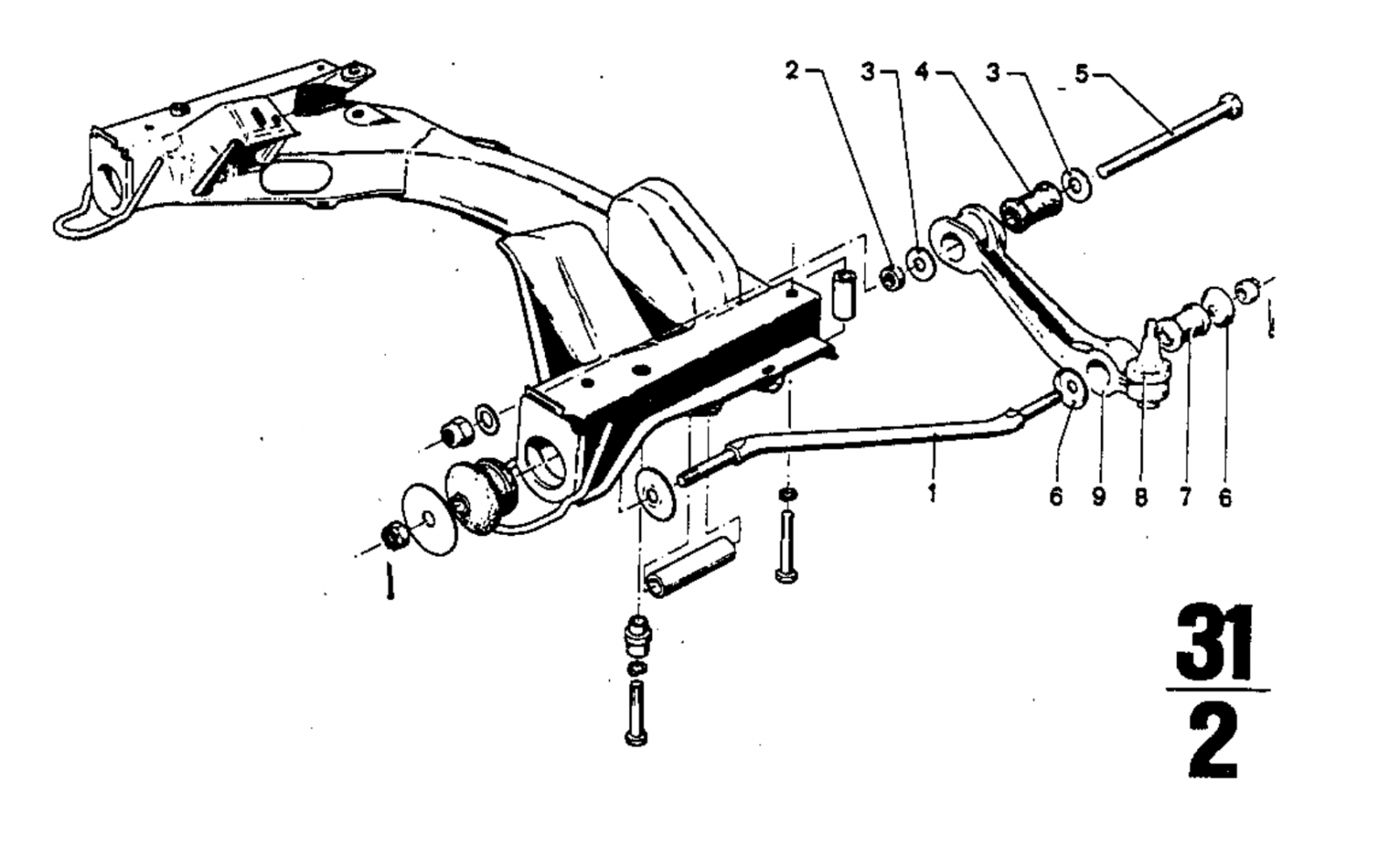

Is the RealOEM control arm diagram accurate?

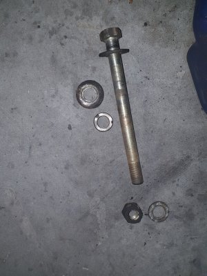

I am replacing my control arms and I have a pic of the dirty hardware I think in order when I took them out but can anyone confirm that the order is (from the back to front):
-long bolt
-big washer
-control arm bushing
-big washer
-short pipe spacer
-into the subframe
-into the long pipe spacer in the subframe
-out of the subframe
-small washer
-lock nut

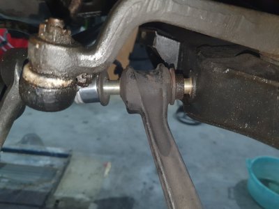

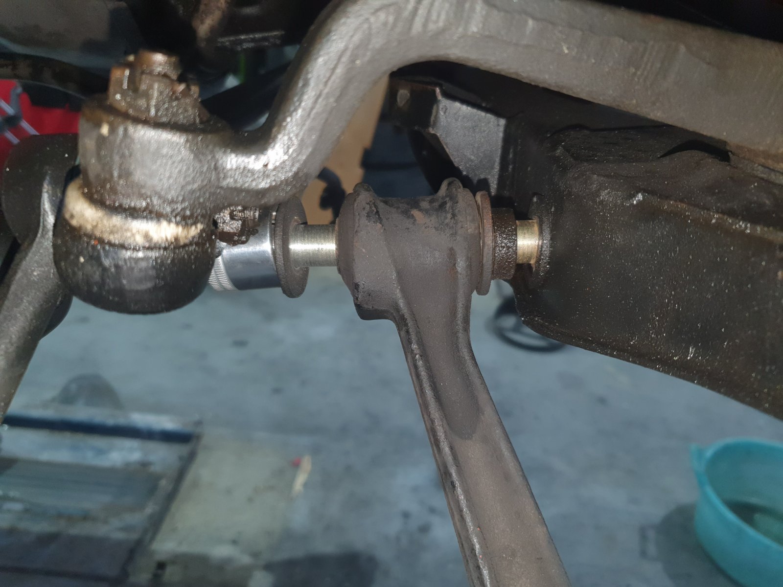

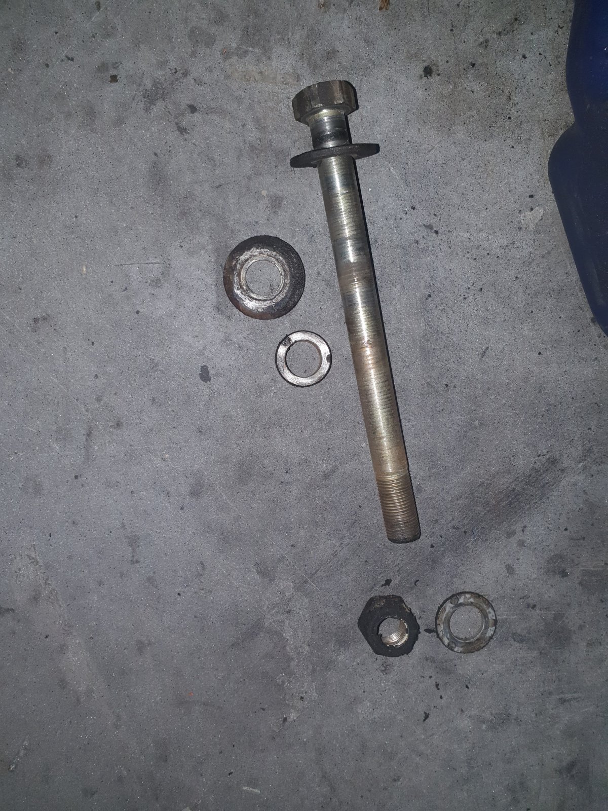

see the pics:
big spacer not shown on that.
