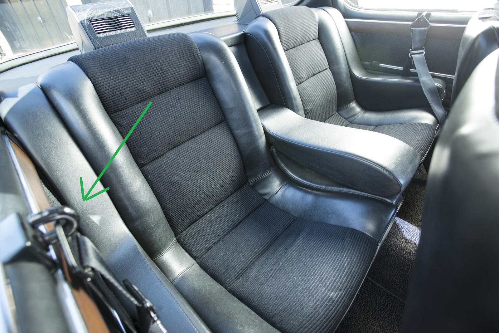

Hi there!
I happened to stumble upon a front seatbelt picture when I was actually surfing something else.
I have never seen such "hook" for hanging the front belt on. Is it BMW original?
Since mine is attached to the ceiling I'd like to move it down, for a cleaner look :) Any downsides to that?
I read the thread about the Paul Cain mod, but the one I stumbled upon also looks ok.
Have a great time!

the hanger is not 'structural', just a place to hold it when not in use!

I would agree with you if the reel of that seatbelt was at shoulder level. The seatbelt reel appears to be inside the fender, so that hanger better be structural. The factory setup would place the reel near the upper portion of the rear armrest.
To answer the OP’s question, this is not a factory setup. Edit: see correction below
Mark, you are right, I didn't look at it closely enough, I was just assuming it was the regular hanger, which is further forward
I wonder what you would tie into at that location to make it strong enough? And the hook looks like it is 'open'

Cool! Can you post a pic? The only setup that I have seen similar to this is on 1974 models. The pivot point is drilled into the wood, not above it. I have never seen another seatbelt setup like this. If it is in fact an original BMW setup, one would expect to find the part numbers somewhere.

Thanks for keeping me in check. I spoke too soon!

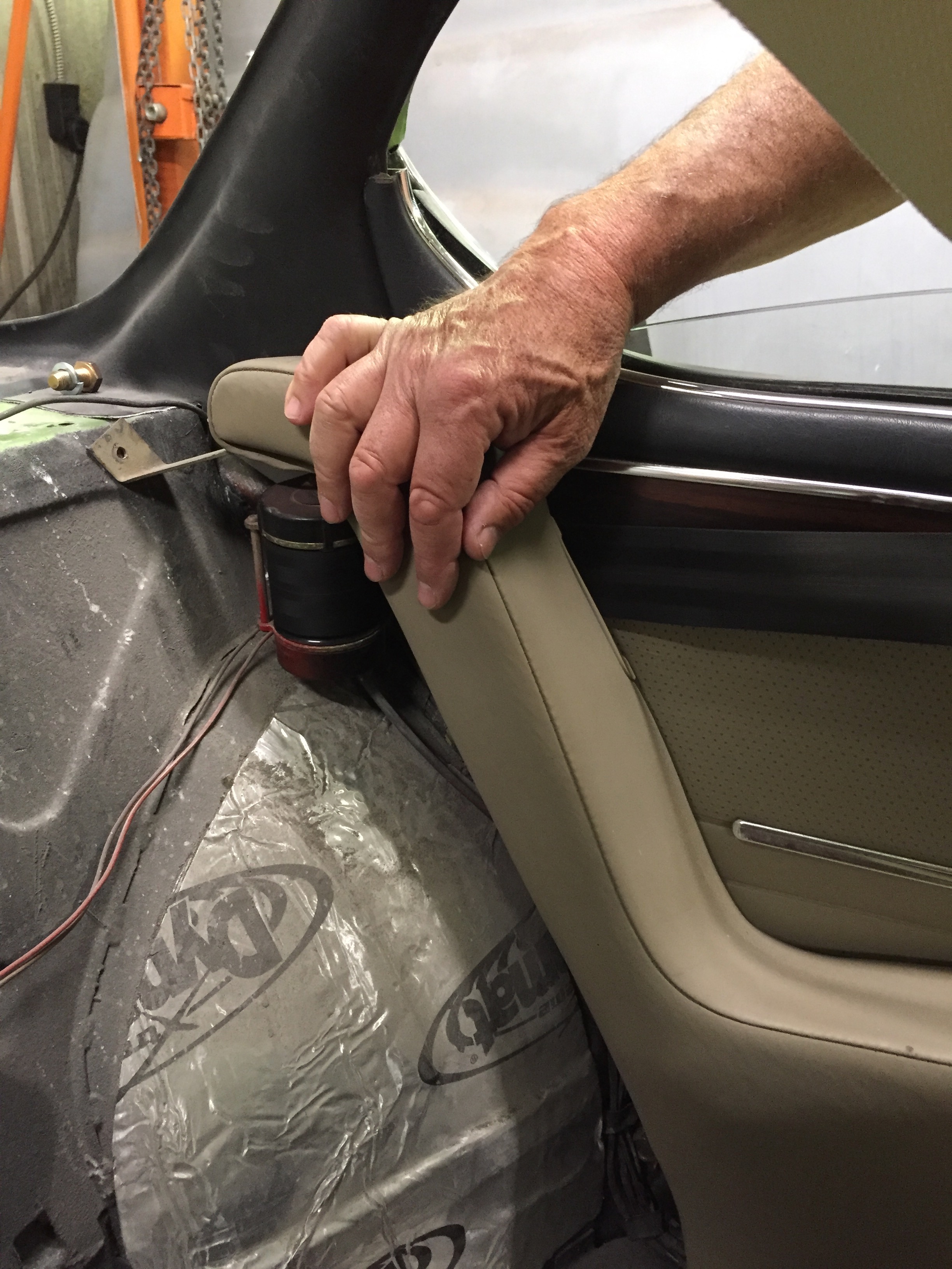

This is good stuff. I would love to learn more about this setup and what is happening behind the door panel. This is the nicest what-appears-to-be-factory-setup I've seen IMO.
Agreed, I have not noticed that one before, I would like to see it all works!

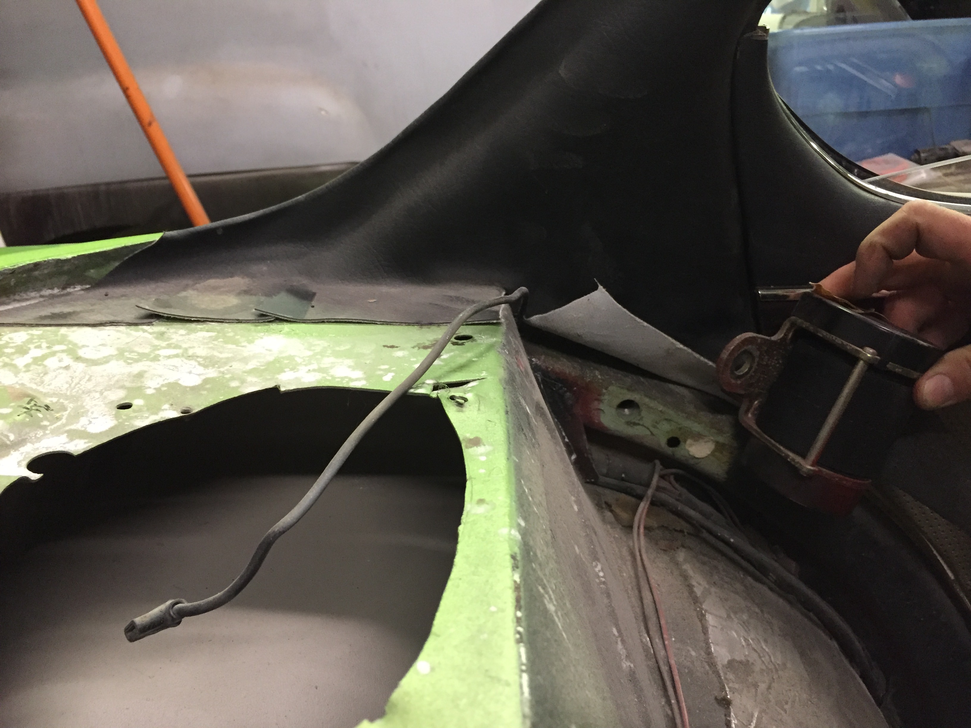

Thanks for the "behind the curtain" pictures Adkfrank. But the thing with my OP picture (and some of the others) is that the hook is above the wood and the belt continues from there downwards, not back. It's still strange because I can't find anything close to it in online parts catalog.

I’m really curious about the innards. Not just the pivot point either. There isn’t that much metal in the area for the reel to grab onto. I don’t know how it would clear the window if it is inward facing. I wonder if the reel is outward facing inside the armrest cavity.
The reel appears to be on the floor/rocker under the rear seat. I put a retractor there in my 69 2002 but a bit further forwards.
