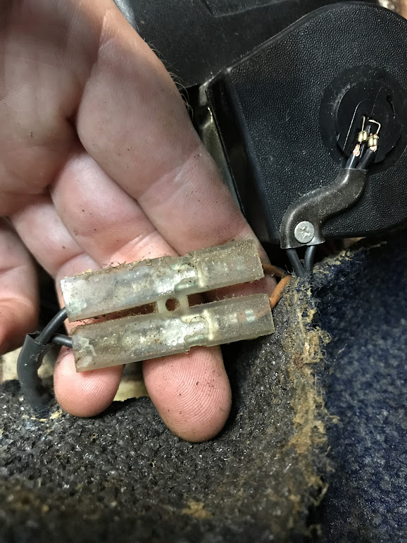

Or does one side come out? I don't want to break it if not. Thanks.

It pulls apart. I can't recall exactly but I think the male terminals stay put.
I think the female terminals have little tabs in them that snap into a grove in the male terminals, making them difficult to separate.
If you look really carefully there is a place to insert a small screwdriver or pointed device and release the connectors.
It's like a flap in the plastic cover.
Same way for heater wire connector.
Honestly I just pulled mine apart. I will look at the female terminals. This was for the power windows up front.
So there's a tab on the female connector inside the clear insulation housing. If you look closely there's a spot (look at the black arrow) where you can depress the tab then slide the connector out of the housing. You'll need to pull the tab back up when you slide the connector back in to the housing so it will snag and stay in place.
Mike, I think you are pointing to the male side which is longer. The female should just pull out unless that tab was really bent outwards. Just a thought.
Yes, thanks, when I got in there to inspect I couldn't see any tabs and it looked like the female side was unlocked so I used the needle nose pliers on them and they came out so for the record the seatbelt warning connectors under the belt reels are not locked with tabs lol. Appreciate the help.
