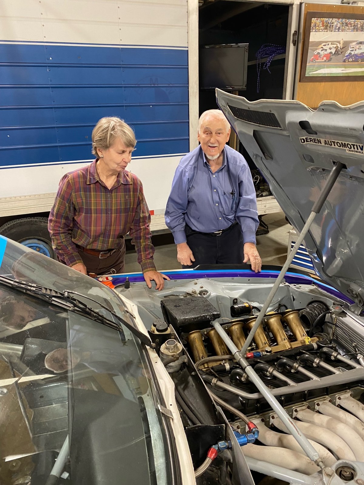

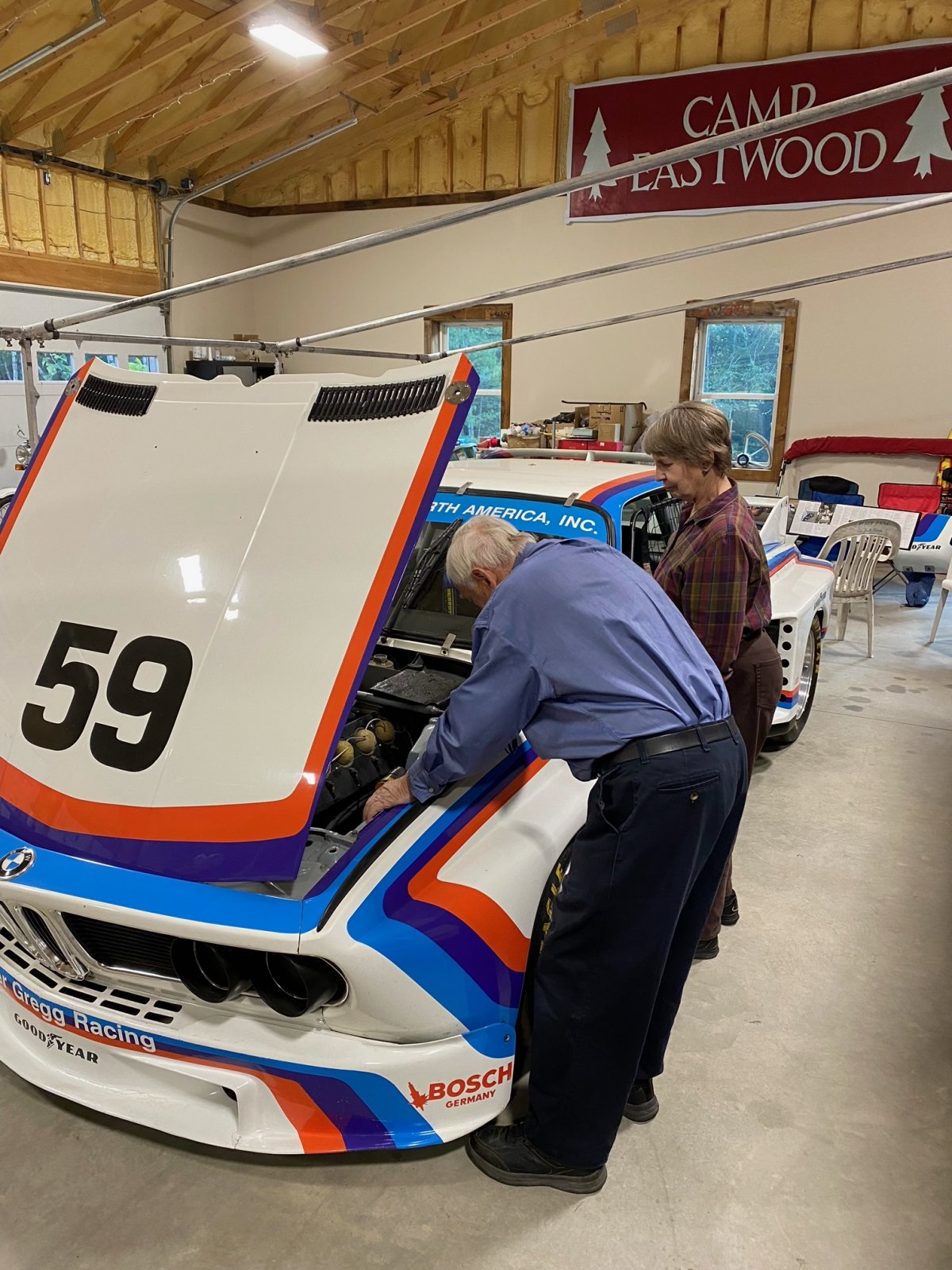

The next morning Jack was hot to trot. In literally about 4 seconds he had the hood off. Jack is all about accessability and he had the hood attached via two pull pins - no tools needed. Jack claims the entire nose of the car comes off with just 6 bolts and he could remove an engine without removing transmission, headers, etc. I believe him!
After cracking a bunch of fuel lines and finding pressure nowhere, we soon focused on the feed tank. The feed tank is a cylindrical tank standing on end that holds maybe 2 gallons. A pump runs constantly, pumping fuel from the bottom of the main fuel cell into this feed tank. A return line from the feed tank dumps back into the main cell. With this setup fuel goes round and round and the feed tank should always be full unless of course the main cell runs dry. I always thought the purpose of this setup was to prevent cavitation during high g turns.
But a dipstick indicated the feed tank was only 2/3rds full. We had two different problems: why was the feed tank not filling and why were we seemingly running out of fuel when the feed tank had plenty of fuel?

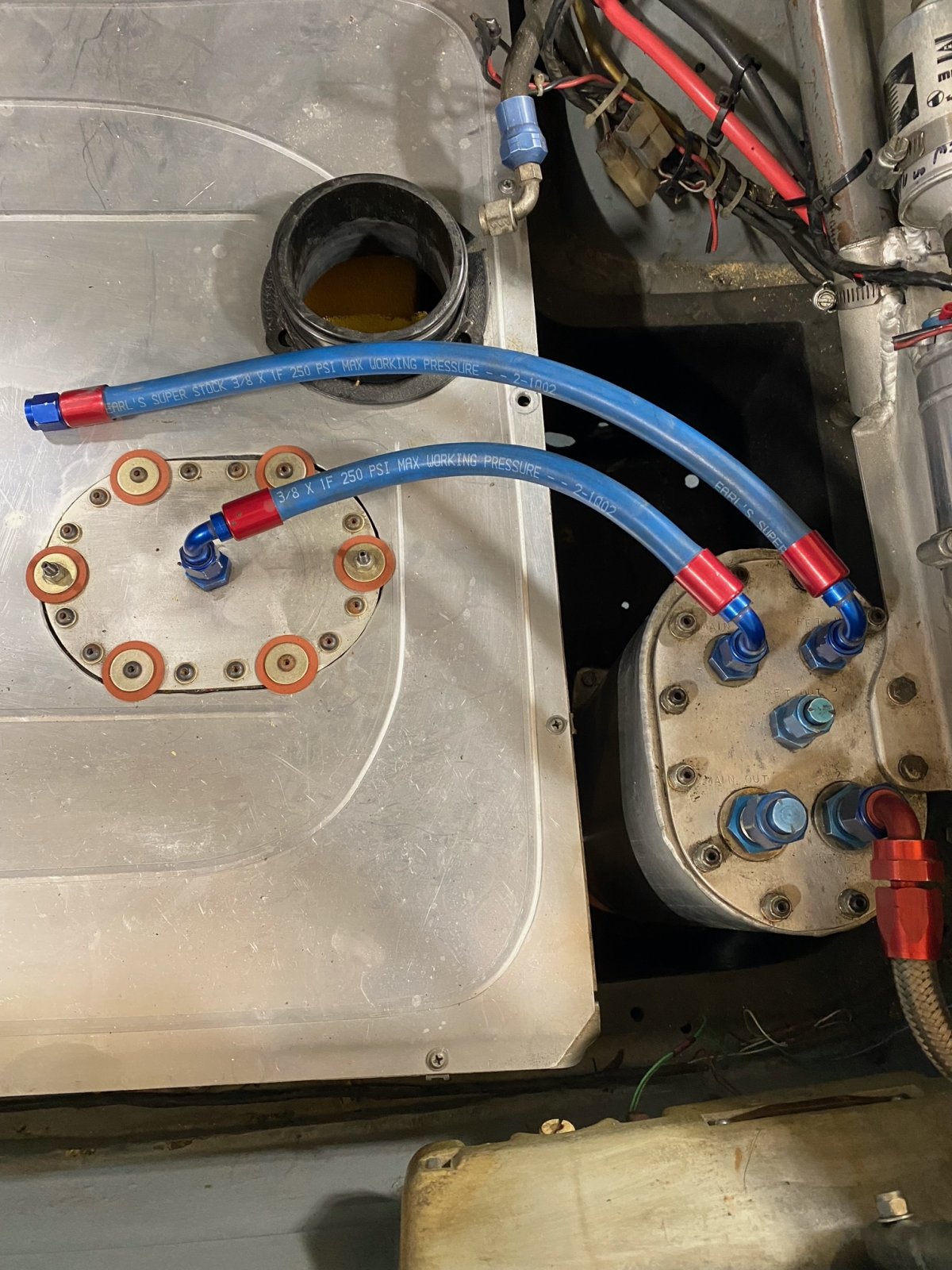

In the picture in the previous post the feed tank is shown on the right with 5 fittings. The center is the dipstick. Upper right (disconnected) is the input from the feed pump. Upper left is the return to main cell. Lower right is the fuel pickup which feeds the pressure pump to motor. Lower right just capped? We removed the 12 cap nuts and pulled the top off the feed tank. Suddenly Jack had a flashback. Here's basically his explanation:
The feed tank was a Peter Gregg thing. He wanted a reserve fuel tank such that, if he started sputtering out of fuel on track, he could hit a switch and have enough fuel to make it back to the pits. He implemented that function in an unconventional way with the feed tank. The feed tank had two pickups. One pickup went to the bottom and the other pickup only went 5" down. Peter somehow had a switchable valve to select which pickup was active. Default mode was the 5" pickup and if he started to sputter out of gas switch to the deep pickup and head to the pits. The advantage of this "virtual" aux tank is that it is always automatically filled and always has fresh gasoline.
When Jack restored the car in 1992 he apparently felt this setup was overly complicated for a now track toy. He capped the deep pickup and used the shallow pickup and tossed the switchable valve. Jack has forgotten more about the 59 car than I will probably ever know!
I would love to talk to some Brumos mechanics to see if their Porsches used the same setup.
Anyways we filled the feed tank, buttoned it up, and the 59 car started!

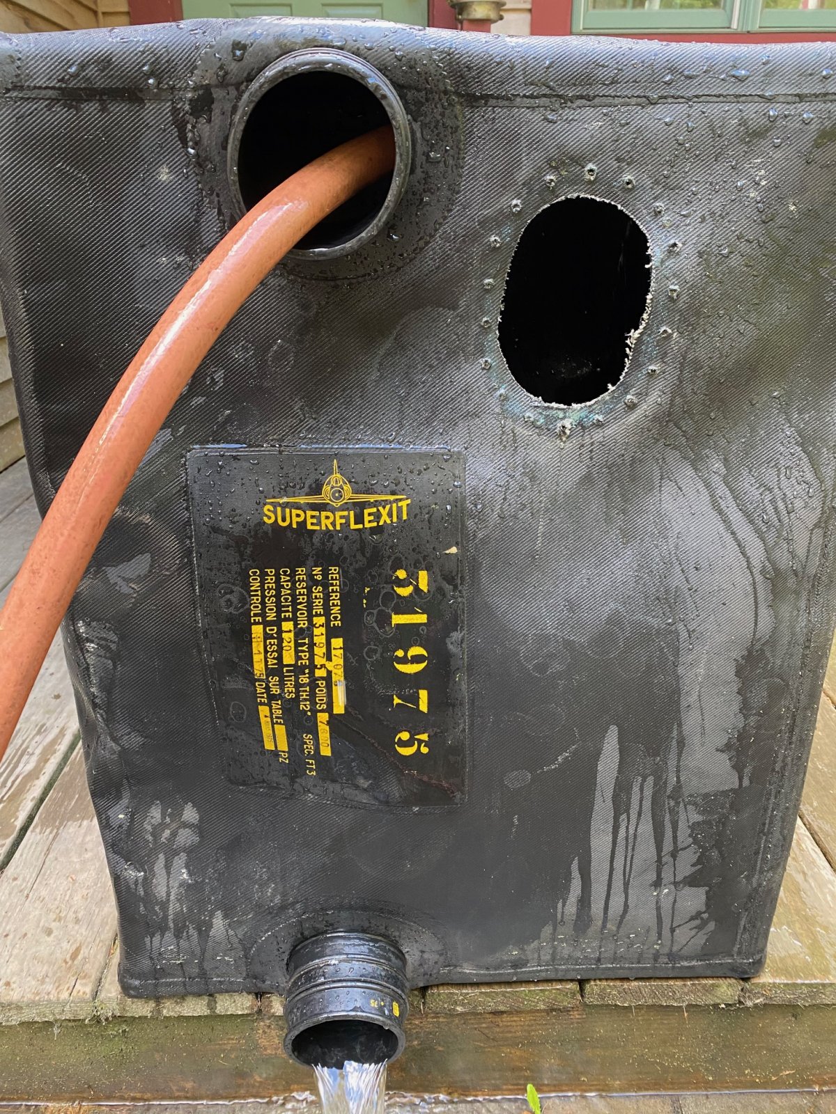

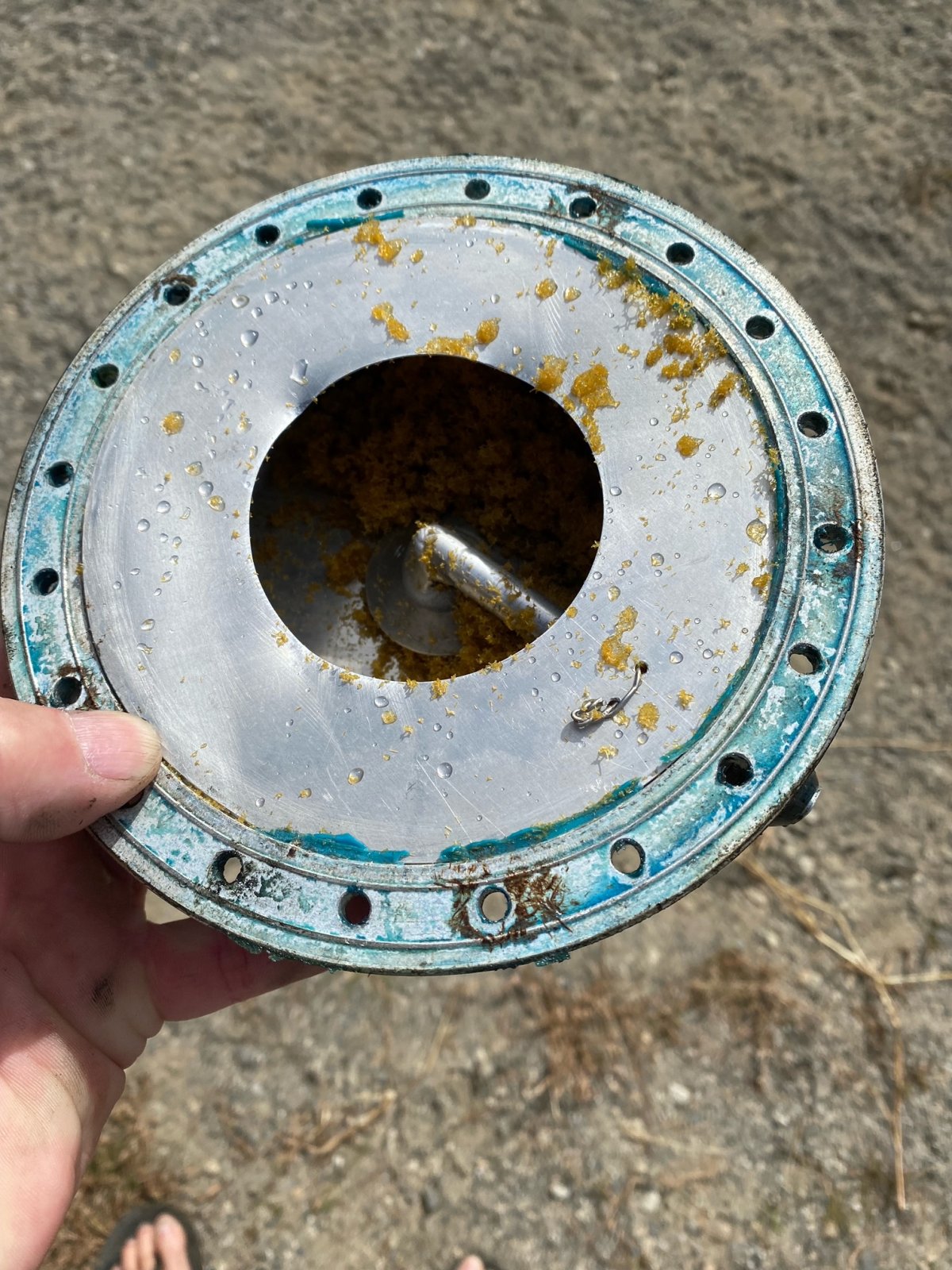

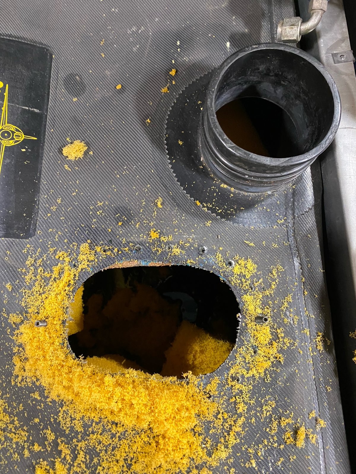

A few days later I got under the car and disconnected the main fuel line. Only a little fuel dribbled out. A call to Jack and we decided the fuel cell was probably foam filled and it had disintegrated. I took the cell apart and sure enough it was filled with yellow foam dust. Took the bladder out of the car and rinsed with a garden hose. Today the car is entirely put back together and running, just without any foam.
