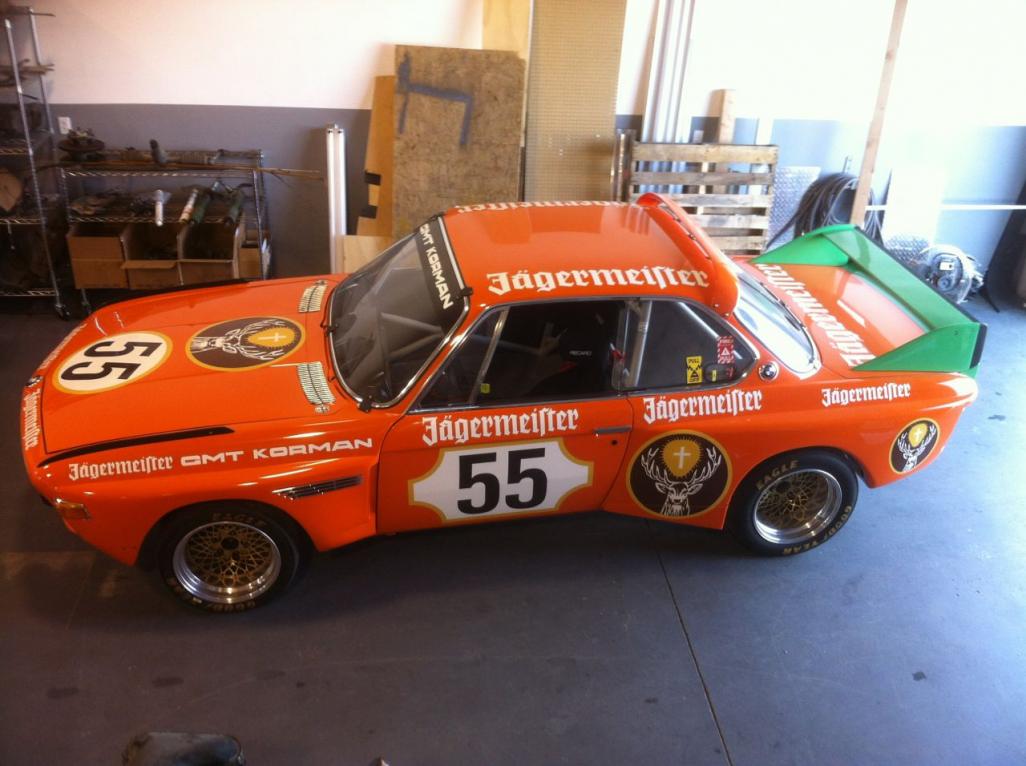

Here is the car arriving at Tim's shop:

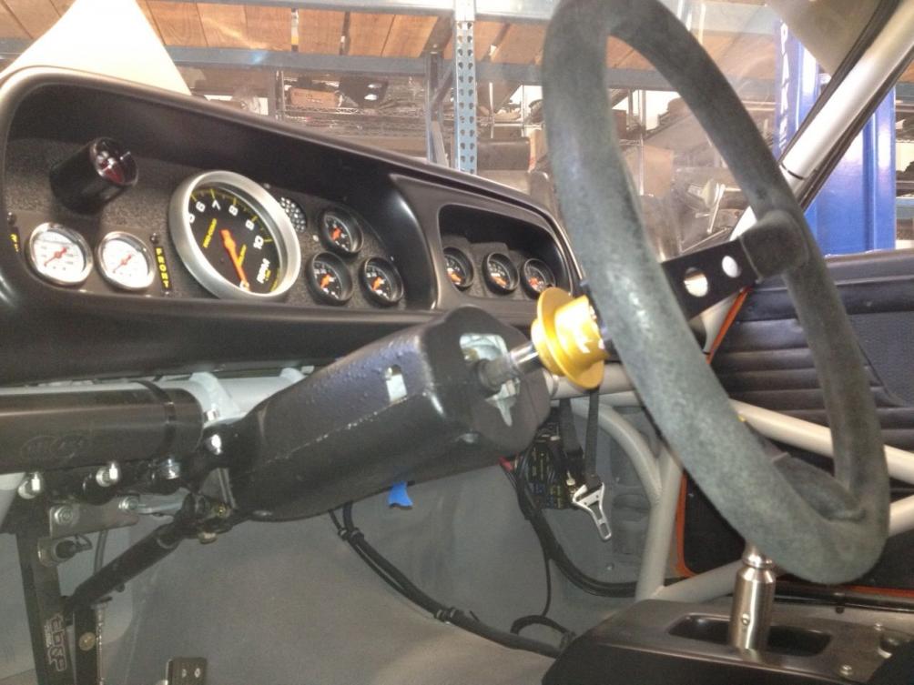

They got right on the work, and by 10 AM they had the disconnect installed on the steering shaft:

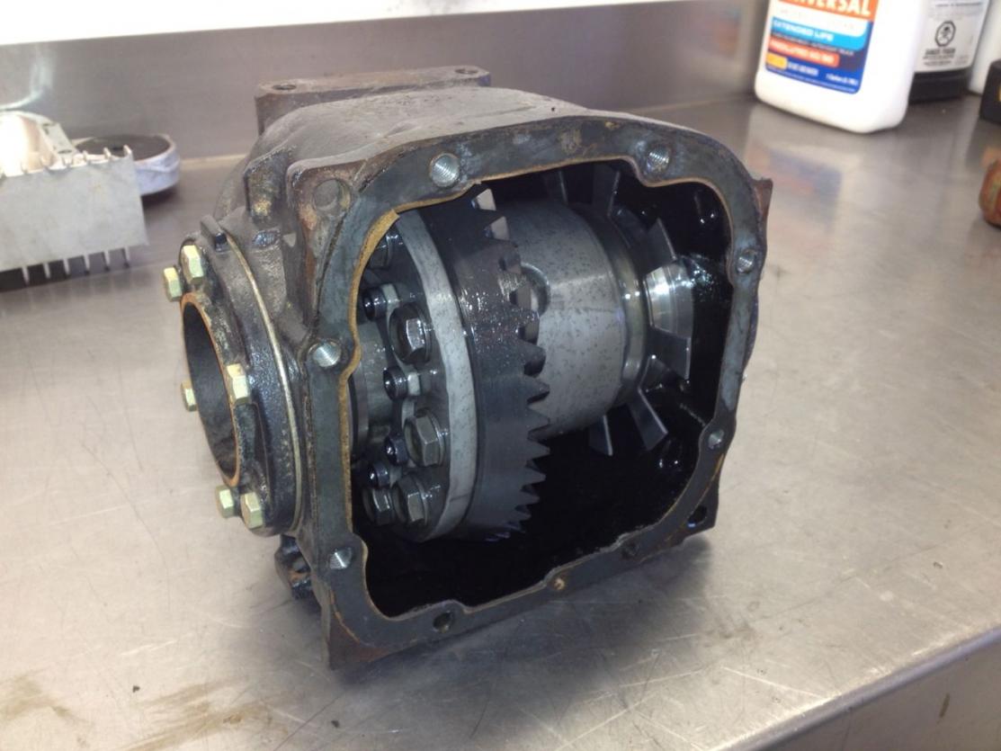

Next, the diff came out:
Everything looked fine, so the new ring and pinion were installed and the updated diff was back in the car by the afternoon:
It should make quite a difference in acceleration off of the corners. I will also have all 5 gears useable at places like Laguna, Sonoma, and PIR.

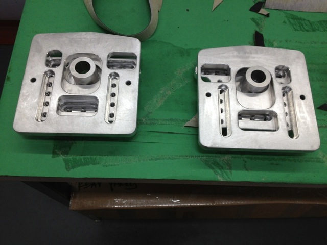

In an attempt to get a few more degrees of camber in the front we had a local machinist make these new mounts to go in the strut towers. They should give us an additional 2 degrees.

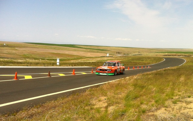

Test Report
We made it out to ORP last Thursday for a shake-down prior to Sonoma. The major changes we made were to the suspension and the diff.
Tim was able to get both front and rear to 2 deg. camber. What a difference! Tire temps were nearly perfect across the face of both front and rear tires. Turn-in is crisp with no initial understeer. Add power and the car sticks and goes. Very predictable, and consistent through all our runs.
The new 4.45 diff makes the car jump off the corners. I was just shifting into 5th at the end of the straight, which is not long at ORP, so it should be just right for Laguna, Portland, and Sonoma.
We did have one small engine issue. The engine was loading up coming off the corners, especially left hand corners. We suspect a float level issue. Tim will be checking that this week. The O2 meter we had on it showed we were running just a little rich, but since ORP is at about 2500 ft. we decided to leave the jetting alone. When we get down to Sonoma, Laguna, or Portland, which are all near sea level, the mixture should be spot on.
Over-all the changes we have made have really helped the car. It handled pretty well before, but now it is outstanding. The extra Oomph off the corners is very welcome.

I'd be interested in what you use for camber adjustment, do you have camber plates on the front? Any adjustment on the rear such as the eccentrics on the cross member?
It sounds as though you are running quite alot of negative camber at the front?
