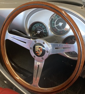

It comes with an adapter but it is for a porsche.
porsche adapter / hub won't fit on an e9. you will have to buy a hub with a brass ring for the horn - you can also remove the horn ring from a standard e9 wheel and put it on the nardi / momo hub.

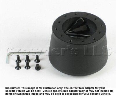

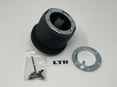

check on ebay for an e9 hub - crowders generally has the new style. you will probably want to get a different horn button unless you want the porsche crest on a bmw. here are a couple of things i saw on ebay - the one from crowders seems to be something new.
