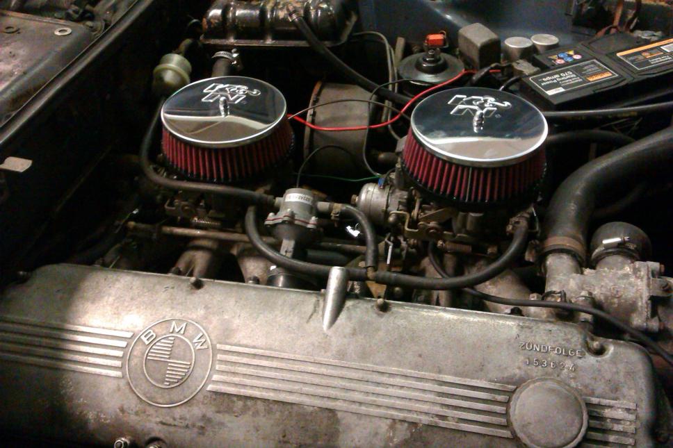

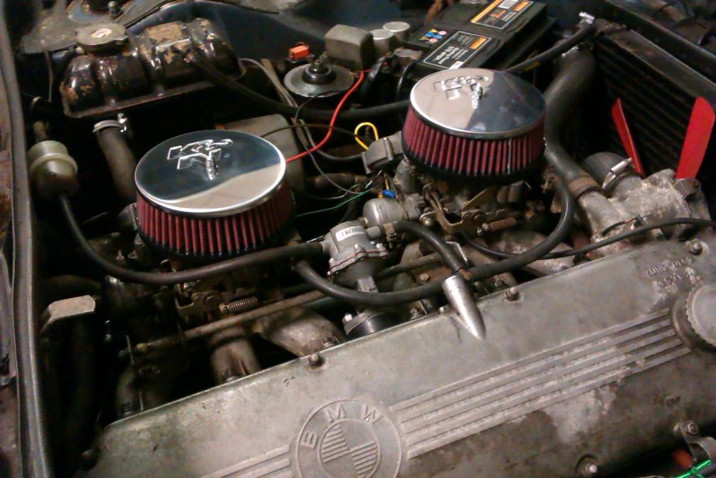

Hi guys! I would like to share some pics from K&N filters on my CS.
What do you think?

not for my personal taste,
but if you insist on them, please place a long hose from the tube that comes out from the head cover, and thus send the gases and oil emulsion far away from the engine bay

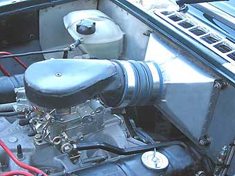

I went through this on a similar set up. While the K&Ns will flow more air, it is pretty warm air from the engine compartment. The original airbox as you know, is pretty much what you have but ducted around the radiator to take cool, denser air from outside to the engine. We did a couple of dyno tests on a 3.2 liter engine on another make of car and there is a measurable difference in horsepower; that denser air just has more oxygen molecules. So, on the other car I went back to a ducted airbox like stock with a K&N filter. I would bet that the stock airbox with K&Ns will actually outperform your (and it was mine as well) set up by a good margin at speed. That said, it sure is easier to tune with your set-up. :)
Everything is a trade-off.
Best of luck with what ever you decide to do!

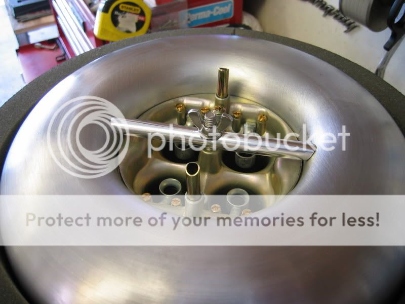

We did some air cleaner dyno testing several years ago for a 2-bbl V-8 setup used in the Lacarrera Panamericana and found that the most effective device was not the style of air cleaner but the carb hat we put inside it. It was worth about 8-10 rwhp compared to running without it, while the brand of air cleaner made little difference.

Results are mixed about whether oiled cloth is a more effective filter media than paper. Even if it is more effective at filtration, is it also more restrictive? (I recall advertising claims that certain media “combed” or “treated” the airflow so that it was more effective or efficient, but effective at what? Tornado? Twice the power with two inline filters???) Economically more effective, maybe. As part of this theory, I agree completely with M.Gobel regarding the internal contours of the filter or as he called it a carb hat. There is more than just a cosmetic reason for intake horns. Same logic applies to size and shape of plenum chambers. But of course, none of this makes much of a difference if the "combed" or "treated" air must traverse a throttle plate that is closed or partially closed. Simply stated, few street engines spend much of their time at wide open throttle.
