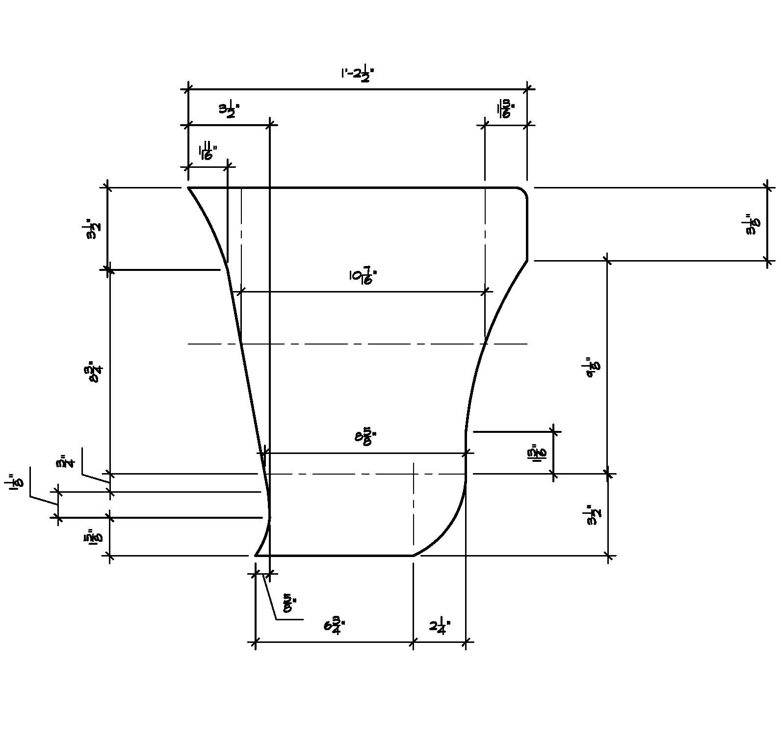

it seems a did a drawing on the kick panel
for reference
could be markos ill check

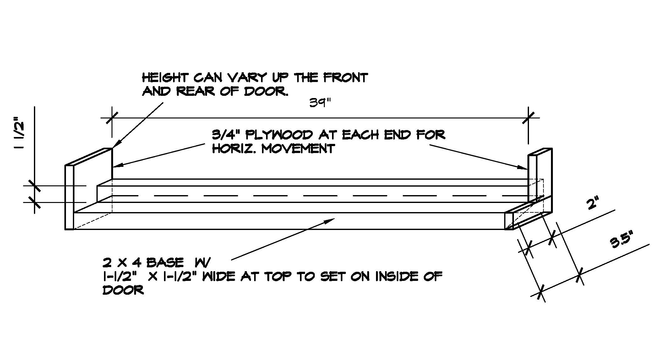

im going to make a door saddle tomorrow so i can adjust the doors eaisier
ill see how good it works as i tried with just jacks and it was a real task.
