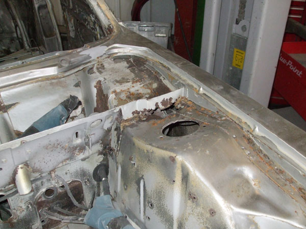

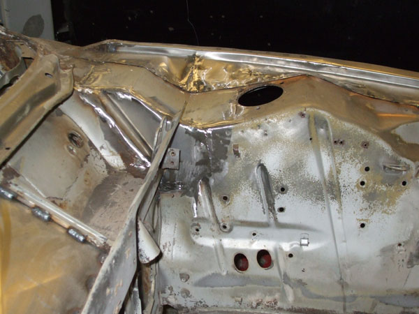

We set to work stripping it out completely ready for shotblasting and repainting but could never have guessed the amount of rust and filler that was revealed (and we thought we'd seen it all in the classic Jaguar business)....
It doesn't show up very well in the fourth picture, but the white bit is filler which was a 1/2" deep in places!!

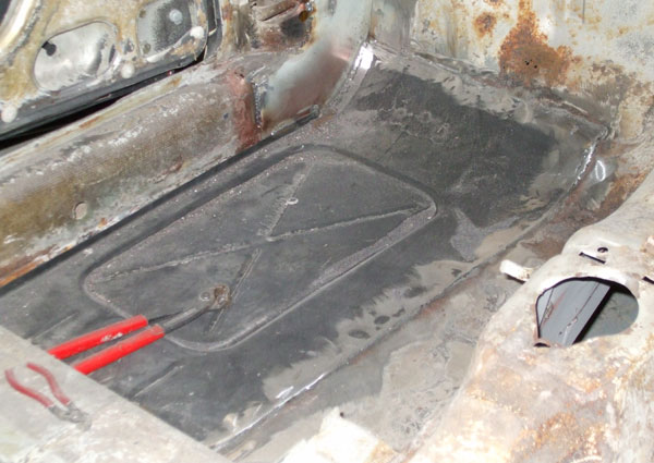

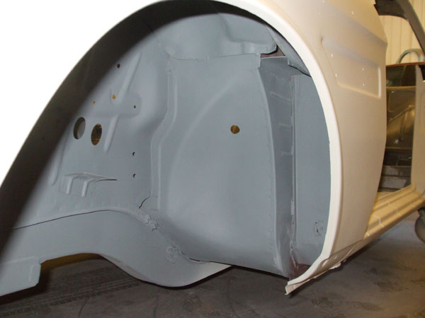

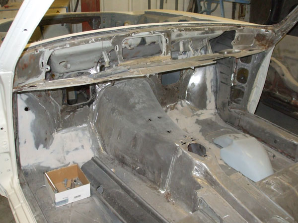

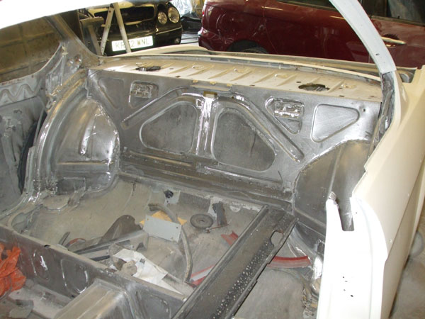

After shotblasting the shell went off to the bodyshop for repairs & painting. It needed many new panels including all the floor pans, the spare wheel well, door skins, bulkhead boxes & wheel arches. It also underwent some alteration in the bulkhead to enable a more modern air conditioning unit to be installed (purists look away now)....

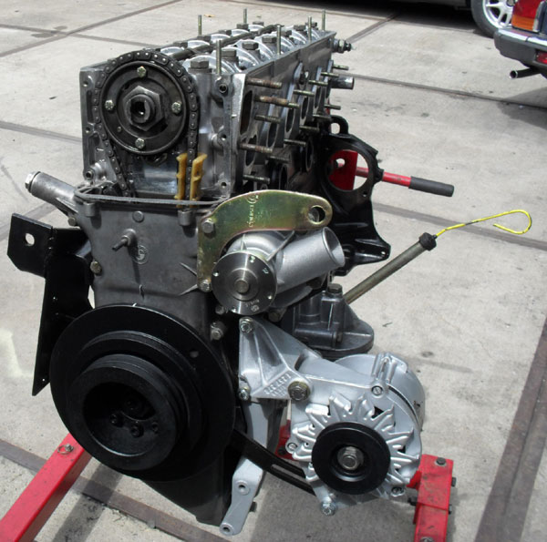

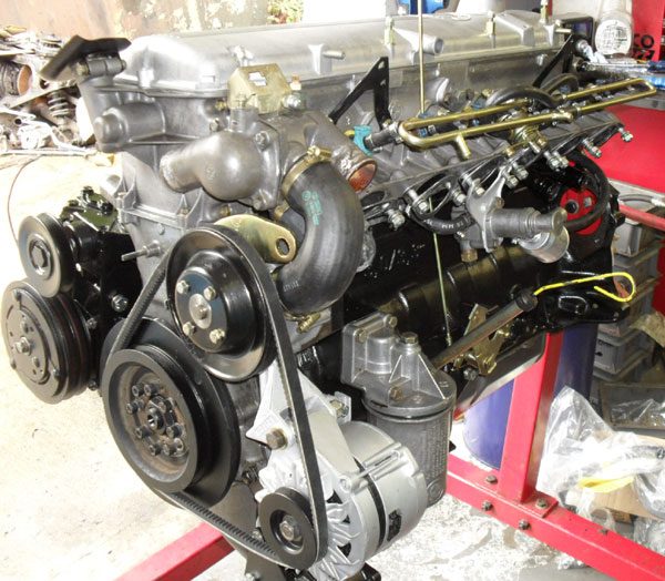

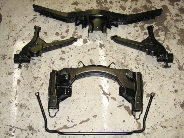

After many months we have the shell back from the bodyshop and have started the rebuild process. The customer wanted an automatic gearbox instead of the manual and we are fitting a digital engine management system so some modifications to the engine have been required. We have also fitted a new electric fan cooling system, so as you can see this is no simple restoration programme!

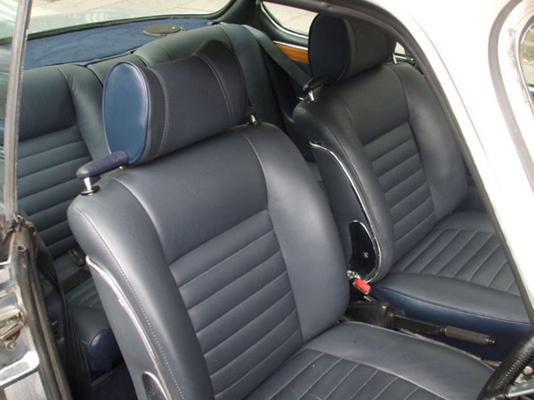

There is still a long way to go before the car is completed. The interior will be renewed in an oxblood leather and the new seats will have electric adjustment, heating and lumbar support. The dash will need to accommodate modern audio equipment as well as the uprated a/c system.

I really like what you all do with the Jags. While I do think originality is important, I generally think it is important in cars that have not already been modified. Mine, for example, came with a blown engine, a trunk AC unit, and a sloppy resto done by a BMW dealer in the 80s, so the originality was already shot.
Since you all already started with what appeared to be a modified example, I'm all for making the car a driver. I'd much rather see them on the road than in a museum. I am rather curious what EFI system you are planing on using and what automatic gearbox. I would guess you'll be going with a mechanical 4HP22 for the auto, given that is the easiest automatic swap by far.
