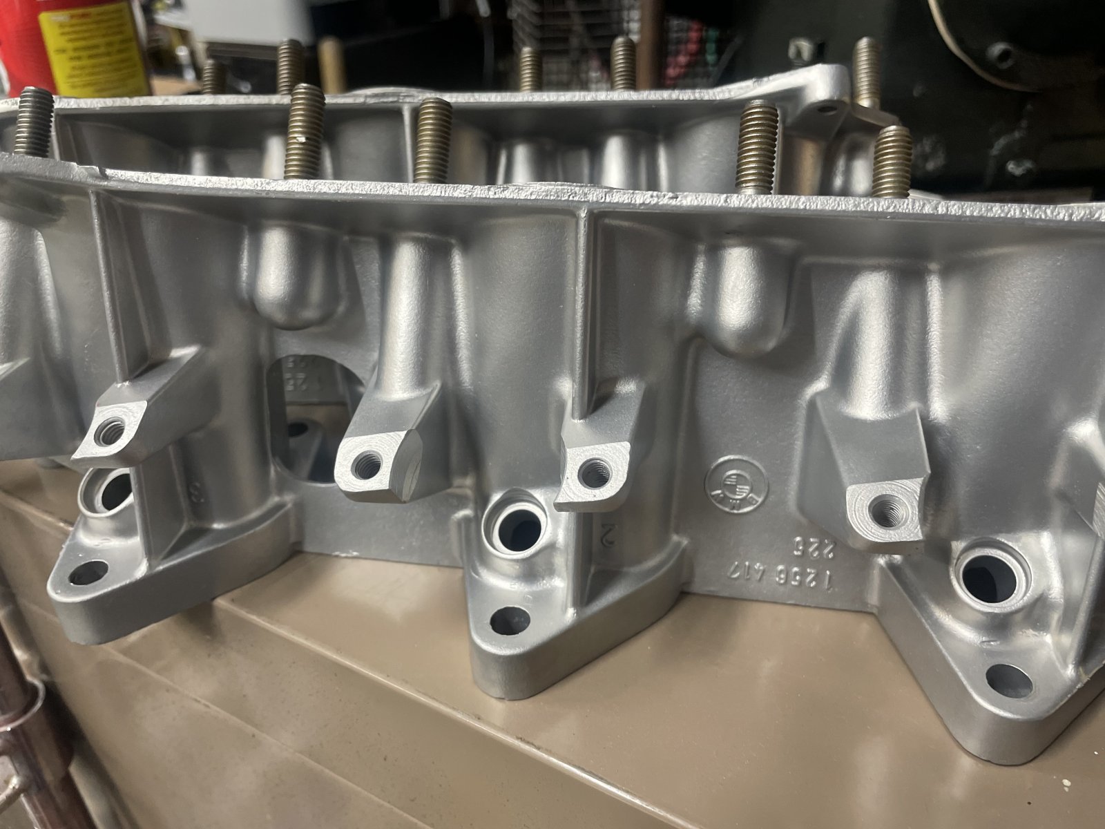

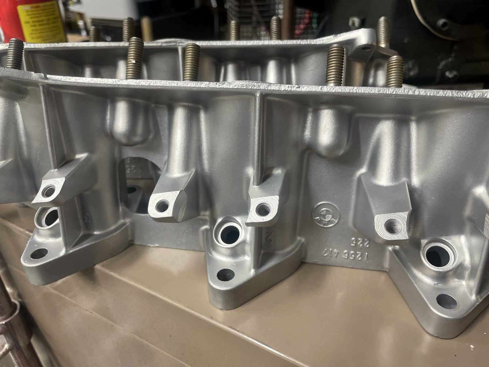

Also, you can’t beat vapor honing for cast aluminum parts!

Vapor honing is something you can definitely do at home. It is a modification of a traditional media blasting setup. Both guys that I use operate out of their garage with a basic media cabinet. There are plenty of youtube videos that cover this stuff.
I have a vapor hone cabinet at home and love if for its convenience. My better half hates it for the room that it (and the zinc plating rack) take up in the garage.
As @Markos says, it is really the way to clean cast aluminum parts. they come out factory fresh with no blast wear or hazing.
