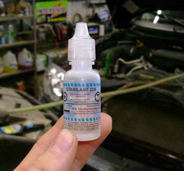

Tail light and turn signal connections generally do not get stronger over time, and in some cases, dissimilar metals and moisture also make for poor electrical contacts. This even includes the metal connections that are integral to the bulbs. Having said that, - this is not a personal endorsement - but some owners of off road vehicles that are exposed to moisture extremes claim electrical connection problems are minimized or prevented with the use of something called Stabilant22 or Stabilant22A. Of course, there is always good 'ol dielectric grease on clean connections.
http://www.fixhybrid.com/stabilant-22a/
