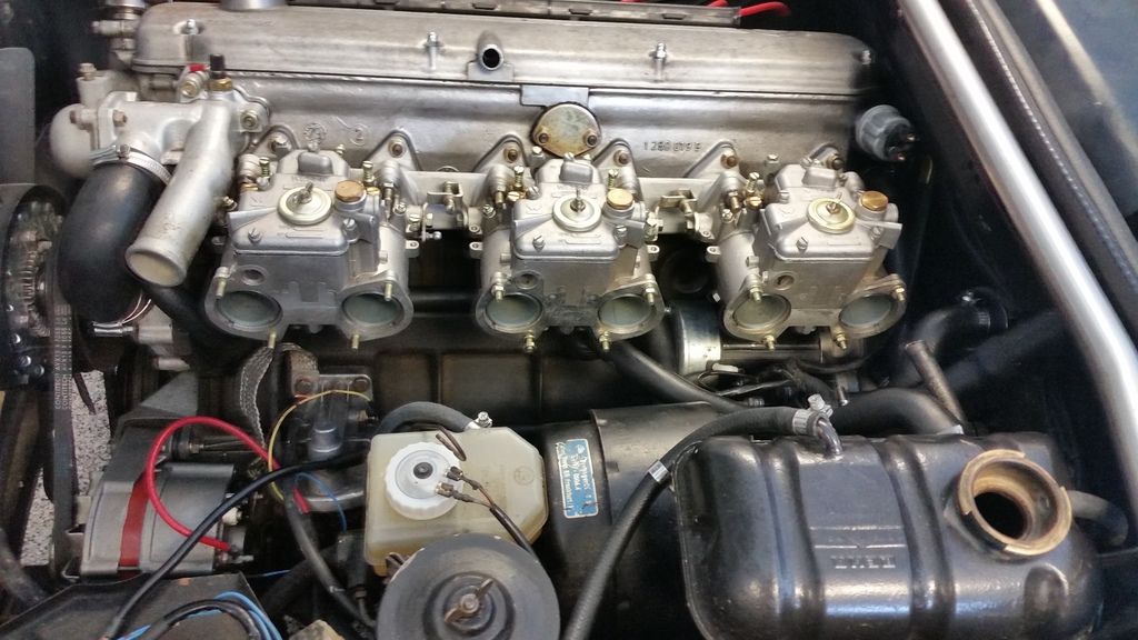

Out of curiosity, which bypass method did you choose? Several options have been discussed on the board at various times...
An excellent question, and one which consumed a large portion of the day today. It turns out that the nifty curvy hoses I originally installed cleared the carbs, but presented problems when the horns were in place. Thus, I moved to plans B, C, D, E ... until I arrived at this:
I used the Delco bypass valve (http://www.amazon.com/ACDelco-15-5533-Original-Equipment-Shut-Off/dp/B000C9DDIA) Rob and others recommend in the really excellent thread on this (http://www.e9coupe.com/forum/showthread.php?t=10824&highlight=bypass). Obviously, I removed the vacuum solenoid and can only actuate it by hand. The hoses from the heater core connection on the firewall were cut from this: http://www.summitracing.com/parts/gtr-63912
The hoses from the bottom of the valve were all cut from a straight hose and joined with 90 degree brass fittings (Yes, I know. Lot of potential leak areas there.) I am not sure about the part number for the hose from the top back portion of the valve to the gooseneck on the back of the head, but I believe it was a BMW hose I removed from the car prior to installing all of this.
Basically, I installed the valve as close as possible to the firewall. I even cut the valve arm in half to allow the valve to be placed farther away from the number 3 carb and tighter to the firewall. This means I will have to squeeze my fingers right along the firewall to open and close the valve, but I figure I won't be doing this a lot so its not a big deal.

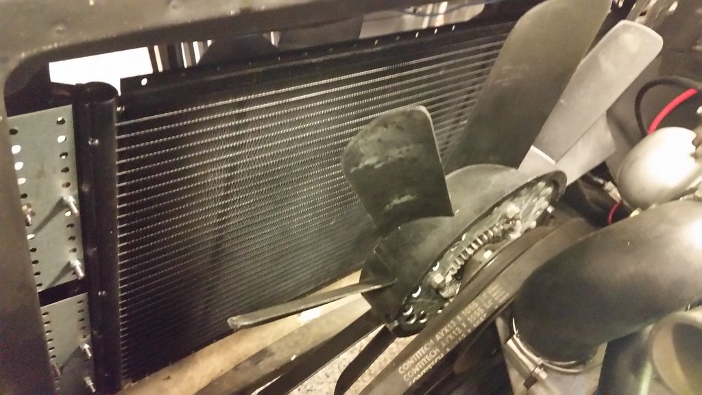

Oh, and whilst wrestling with all of this, my air conditioning parts arrived, so I decided to rough in the condenser:
Hence, huge progress has been made and I am about to retire to my deck to ponder physics, shadows, curves, beauty and other mysteries.

Removing that old York compressor seems like such a great idea.
Was there any particular gotchas on that removal or was it pretty much "detach the hoses, unbolt the thing and toss it in the metal recycling pile"?
That pretty much describes the process. Some bodily contortions are required to get to the rear top bolt, primarily because the head of the 17mm bolt holding the bracket to the engine block is in the way. And my bushings are pretty shot, allowing the compressor to wobble, which means the bottom shackles were chewed up in places, but in general it wasn't too bad. I put a bottle jack under the thing which I had to work around; I did not want that boat anchor falling on me.
