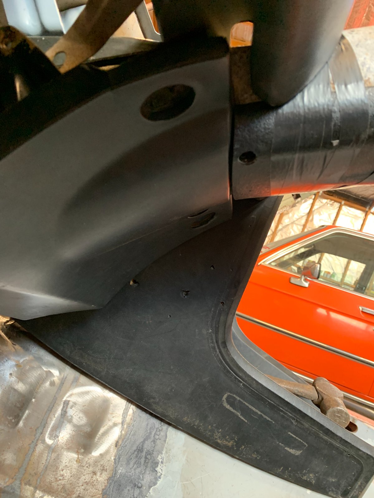

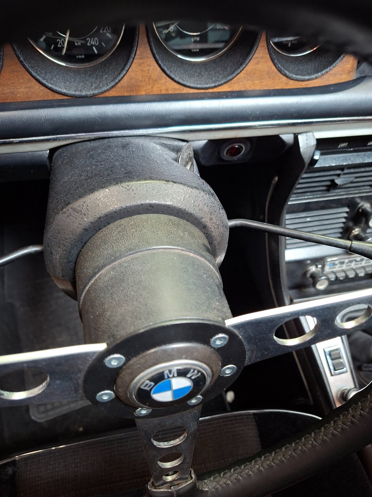

Ok brains trust what am I missing? I'm doing some work on a 1971 car and for the life of me I can't get the 2 x panels that seat underneath the steering column to fit. I have a 20-30mm gap between the top of the under steering column cover and the bottom of the grab rail - for both cover panels.
The car was in pieces and missing some parts, so I'm open to all ideas as to what's going on.
I also realise factory fitment wasn't great. In no order I see the following as potentially the issue, or an interplay of a couple of issues.
As can be seen in the above pic the cover panel is snug but I have a massive gap on either side of the steering column.

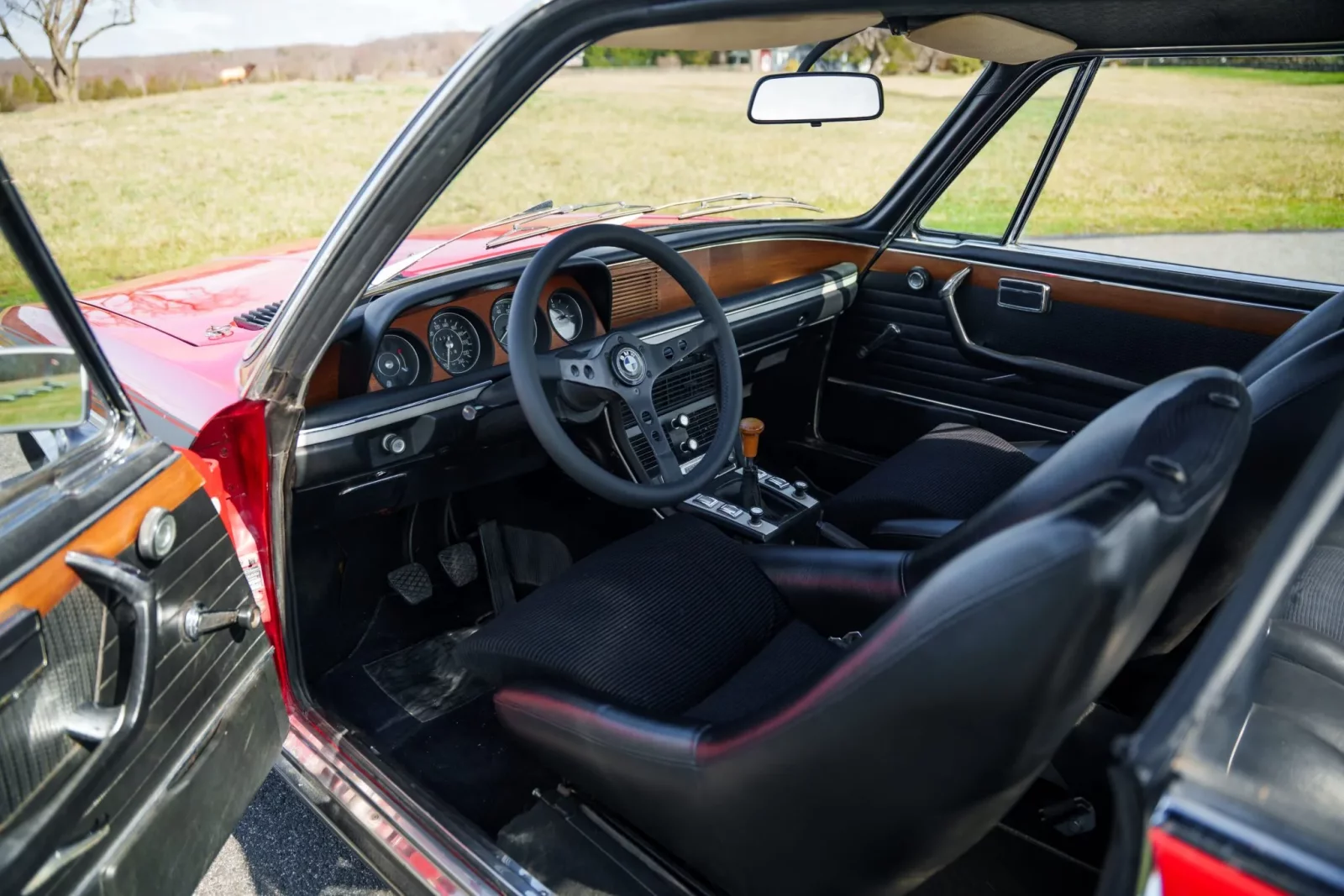

I'm thinking the grab rail may be the issue. The below pic shows one in another 1971 car. Note how the rebate for the headlight switch has the angular rebate.
And yes that's a factory flame orange e12..
The car I'm working on doesn't have a grab rail like this, I'm wondering if it should?
It simply has a round hole with a circular rebate around it for the headlight switch above the button to open the panel for the fuse box.
I'm wondering if this grab rail i(in the picture) s also deeper, as that would solve the issue.

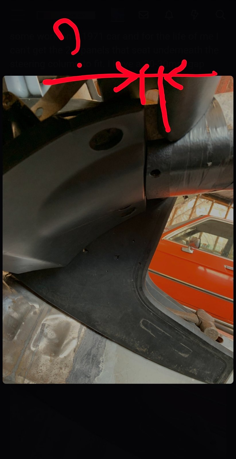

I'm struggling to understand where your gap is; is it this:
There are some differences to the grab rail and the non-adjustable under steering wheel cover but as far as I know the differences are only in placement of knobs and switches, and not their overall shape/size.
My car is not assembled, so I can't check, but as this gap (in my pic with red lines) is completely hidden from view, can't it actually be the right condition?
Can other members with an intact car take a similar pic?
You have identified the gap correctly. I have a degree of adjustment for the steering column via the 4 bolts. I also also have some adjustment for the glove box cover but the vinyl under steering column cover is a mile out of alignment.

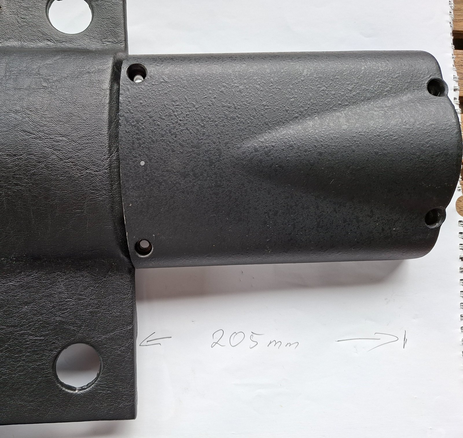

The lower metal cover should have a length of 205mm. It's metal, not plastic!!

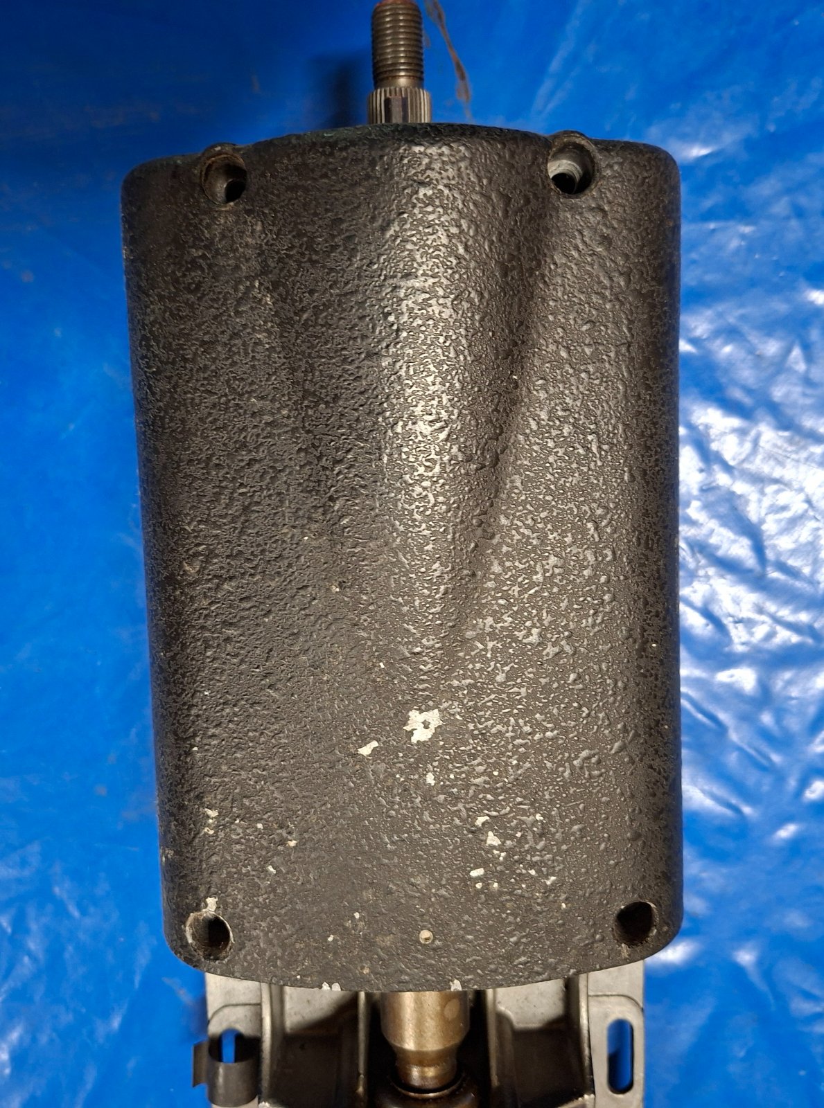

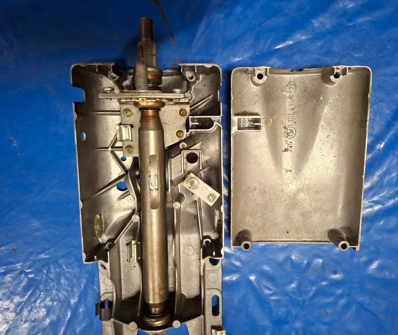

I know that (at least) 2 versions of the under dash panel exist; one for the fixed steering column and one for the height adjustable steering column. Both are a metal plate with foam and vinyl skin. As far as I know they are interchangeable.
@TomHom , do you know if there is a third version of that part, with possibly different dimensions?

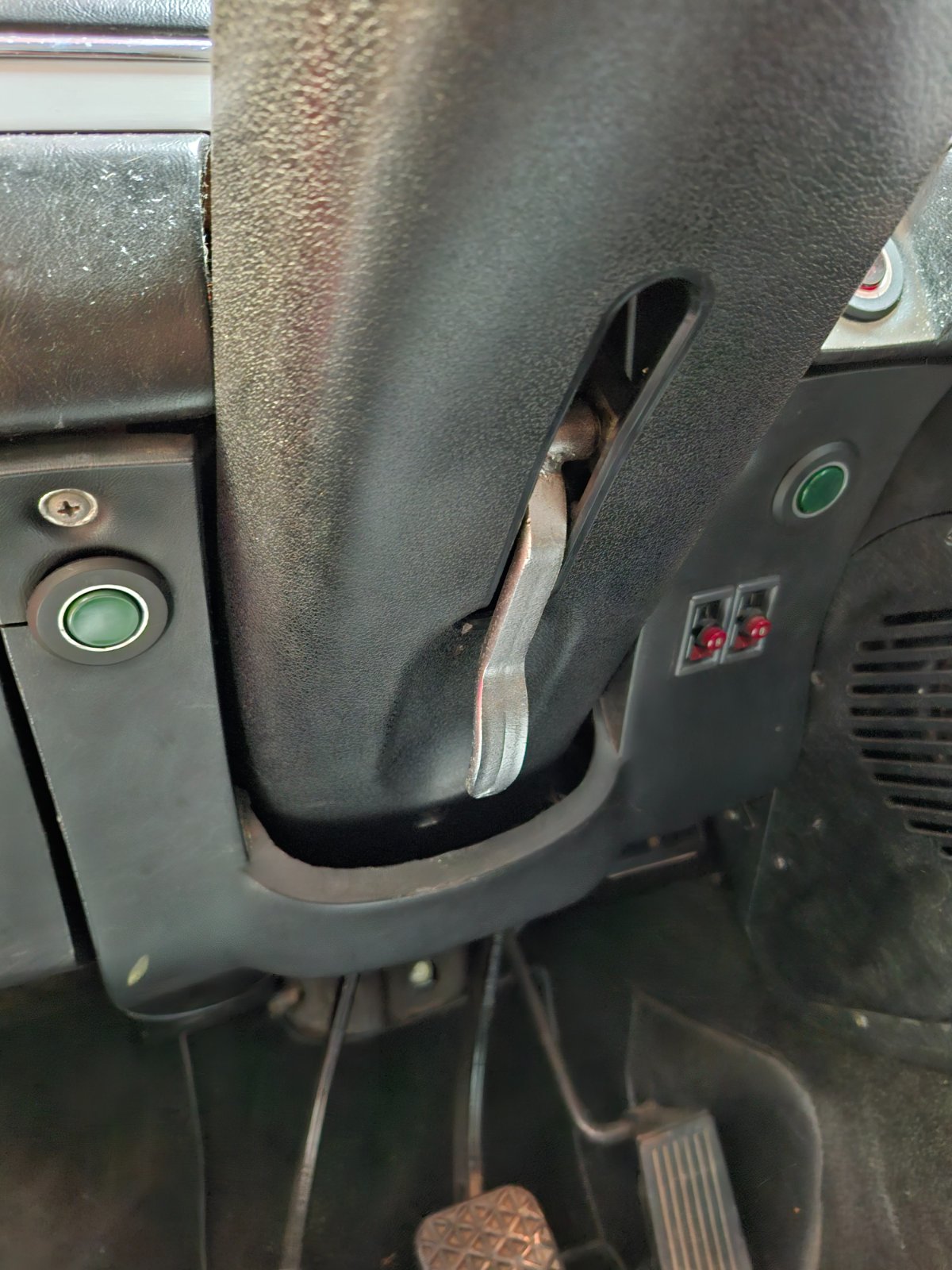

....for the adjustable column both parts are different. The upper lower part is made from plastic with an opening for the handle20250729_131814.jpg
The upper upper part is made from metal.
Note the trim line is a single strip, whereas on the non-adjustable column this comes as a two-piece-strip.20250729_133219.jpg
I have no knowledge of a third version of the lower part, at least not for E9.
20250729_131814.jpg20250729_133219.jpgThis is the non-adjustable column 20250729_170343.jpg20250729_170359.jpg

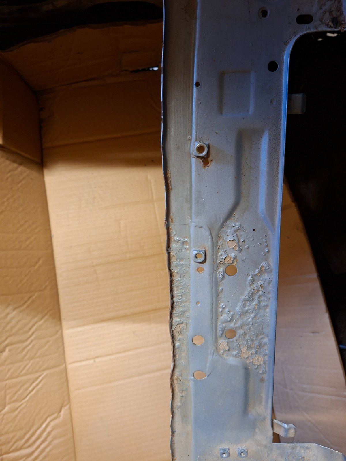

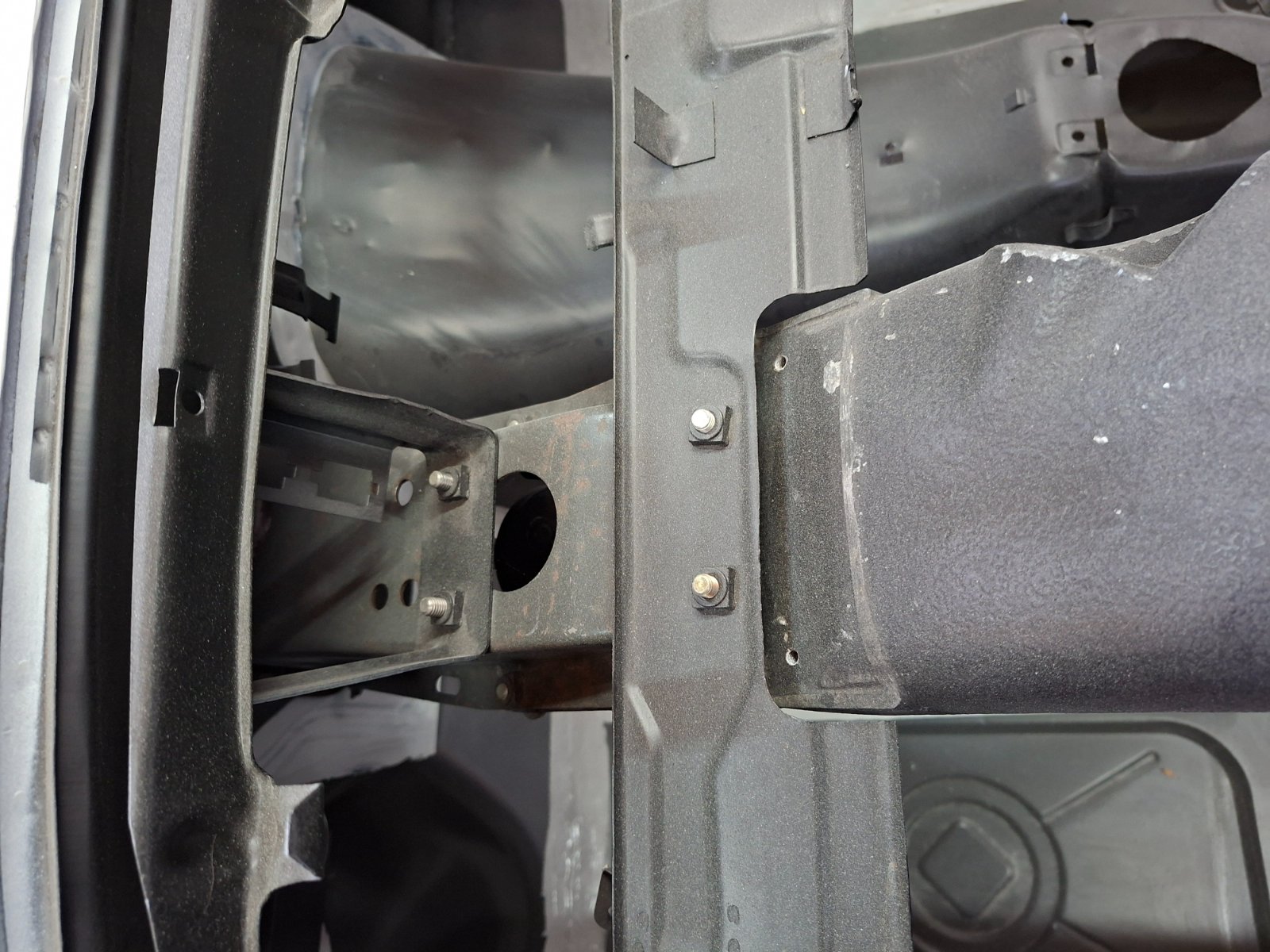

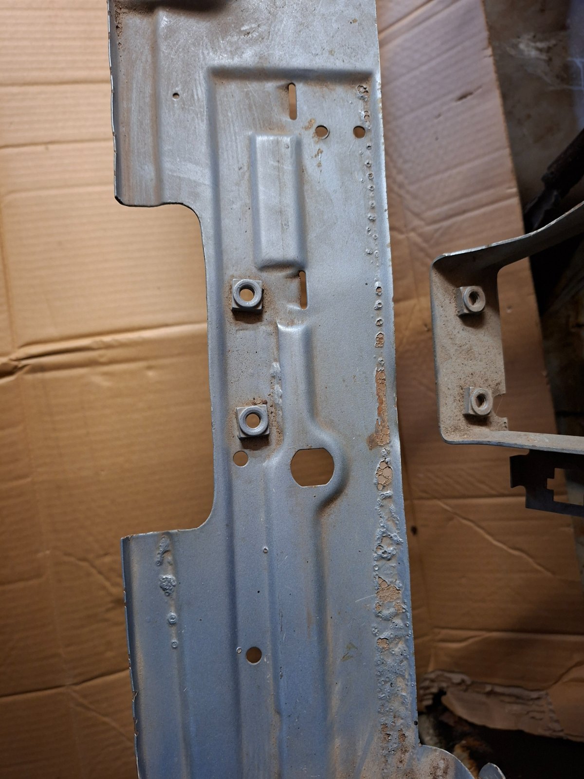

.....are you using the RHD pedal box on the left side!?
This is the mounting position RHD.
....and this for the LHD in a RHD car
....and in a LHD car .
Different positions, different pedal boxes

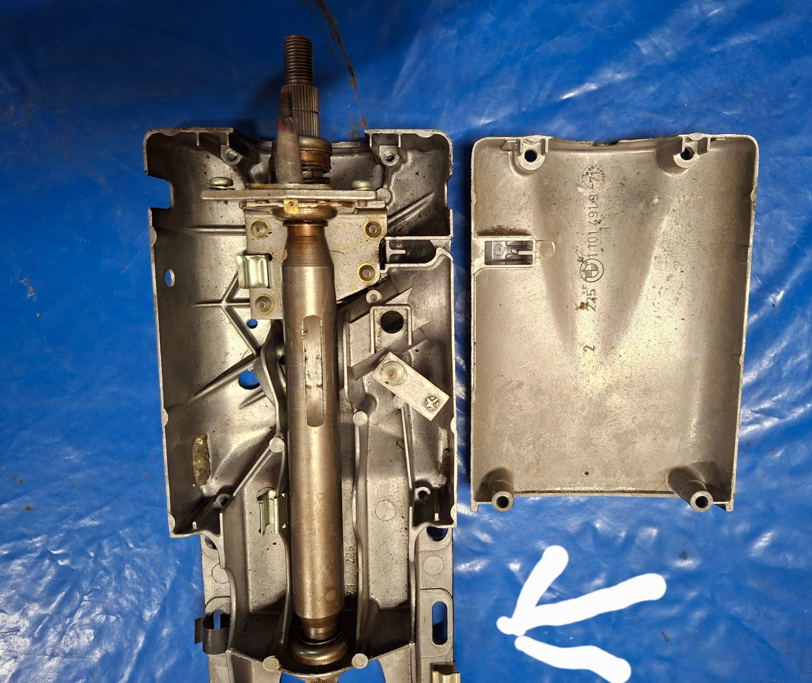

These long holes allow adjustment of the column. In which position is your column?
Is the lower half of the steering rod already connected to the steering gear?
