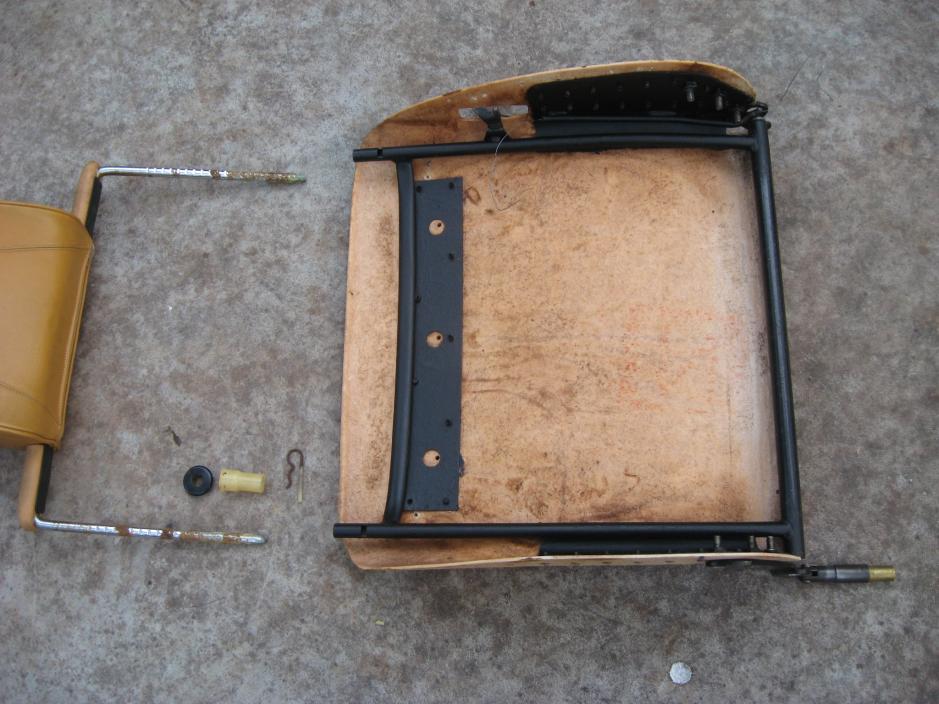

The headrests are mounted on 2 chromed serrated shafts that slide up and down in a metal tube inside the seat back.In the metal tube is a slot with a metal clip that catches the serration's to hold the shaft in the desired position you manually force the headrest into by pushing or pulling on it.No springs or anything else clever.The shafts and especially the clip get rusty and then won't move.Your only hope is to spray with good rust dissolver/lubricant like PB Blaster or Kroil.As DeQuincey says this will take some time to act.After time try pushing down on headrest then pulling up and out and clean the shafts.There is no way to access clip without taking covering off seat back.
