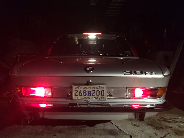

In my quest to find the brightest bulbs possible for my brake lights I saw a tip on the 2002faq about using a Honda bulb to replace the stock 21w bulbs in our cars. It's made by Stanley and it is part number 34903SF1A01. Available at dealerships but I got mine online from eBay Honda dealer southblvdhondaparts for $7 each. Because they are higher wattage I am only using them for the intermittent stop lights to avoid a possible overheating issue. Here is a pic of the bulb on the left and my existing LED on the right (which was bright in itself). This bulb also comes in the 21/5w version for the blinkers but I didn't want to go there. That is number 34906SL0A01. Make sure they are Stanley brand.

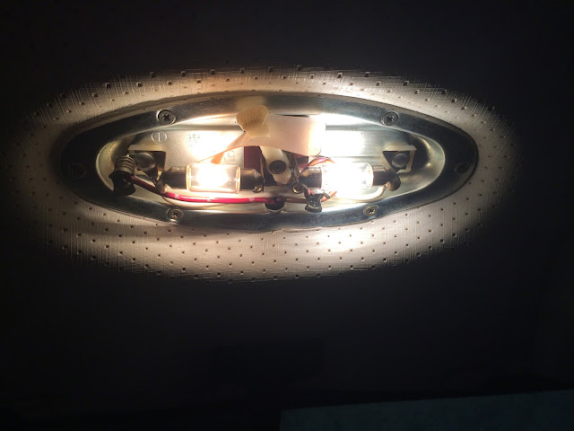

I also upgraded all the festoon bulbs to a brighter one from Candlepower http://store.candlepower.com/64xefifedola.html and you can see the brighter one on the right:

The ones I bought were recommended by Gary W. here when I followed him on the freeway in the early morning hours last year. The running lights are noticeably brighter but not too bright, the stop light was a huge improvement. These LEDs have elements around the entire bulb so work well with the existing reflector and generate no heat unlike a higher wattage standard bulb. I have added them to my NK and e12, my wife has commented that she likes the increased visibility they provide.

I use, sell, and recommend the 'Stanley' bulbs used in US Honda cars. They are not made by Stanley, but another supplier makes them to the same spec. I install them in about all my restoration work for front and rear - brake, turn, reverse lights - tails excepted, they get the high output German Narva bulbs. So far (16 years) I've had one complaint - a brake light switch failed 'ON' and melted the plastic socket (the reflector and lens were OK). This was a late E30 with plastic bulb carriers.
