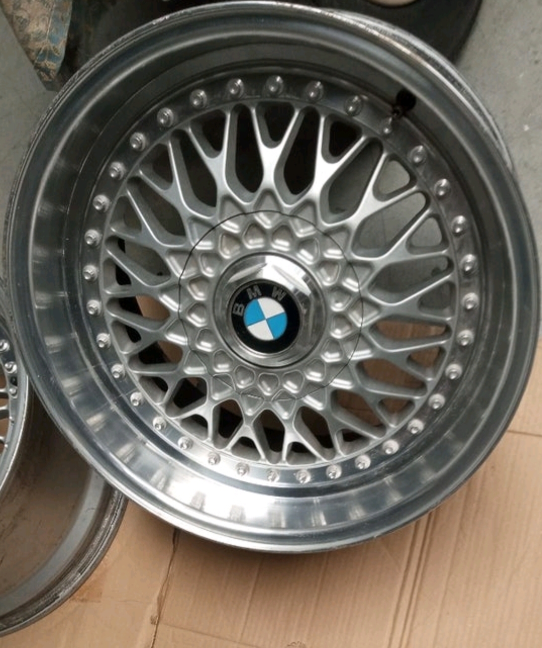

Buenas he visto algunos post sobre el tema pero no con esta medida.
Creen que entraran sin modificaciones y con los muelles deportivos que esta bajado.
Están en venta a buen precio y no puedo probarlas antes de comprar
Gracias

Just too wide front and rear unfortunately. Even with a different offset you would be rubbing metal everywhere.

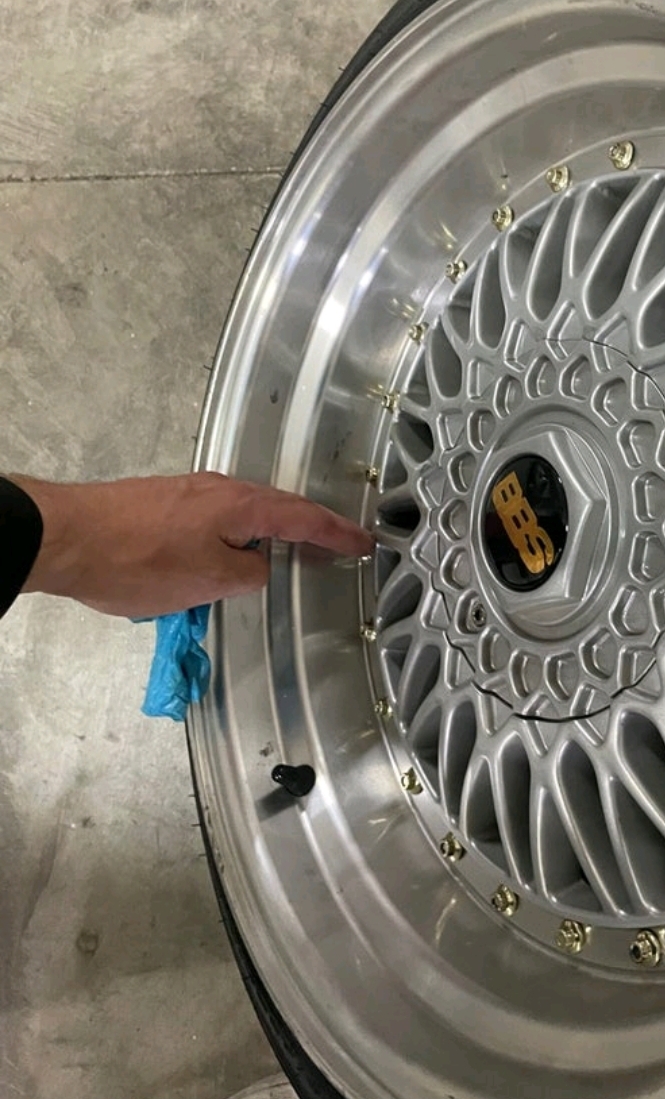

Also note that those aren’t genuine BBS. If you like the look of these wheels, you can find a set of BBS RC090 for a good price.
Si se pueden con separadores de unos 20mm ya cnt el compañero gracias
You simply aren’t going to get 9” to fit well up front. 8” fit up front IF you get the offset correct, AND roll the fenders. A 9” ET35. Yes, with a 20mm spacer you would clear the strut, but your wheels are going to be sticking out nearly 30mm past a factory 7” wheel up front. That is the approximate width of the fender lip that you would roll, and you would ultimately destroy your wheel arch while turning over any type of bump.
I’m the rear, you CAN fit 9” wheels, even 9.5. You have a lot more wiggle room on the inner fender. You might be able to fit ET34 9” rears. You will want to run 245’s though, and it is likely that the front part of your tire may hit the trailing arm, or the rear of the tire hits the exhaust pipe.

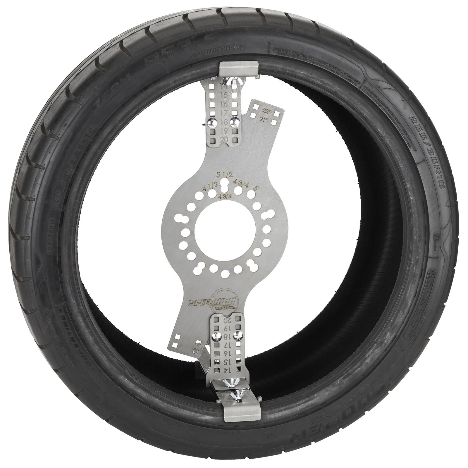

Buy one of these and borrow a target tire from a local tire shop. Buy the tires feom said shop after you identify wheel specs that get you the early 2000’s look you are going for.
