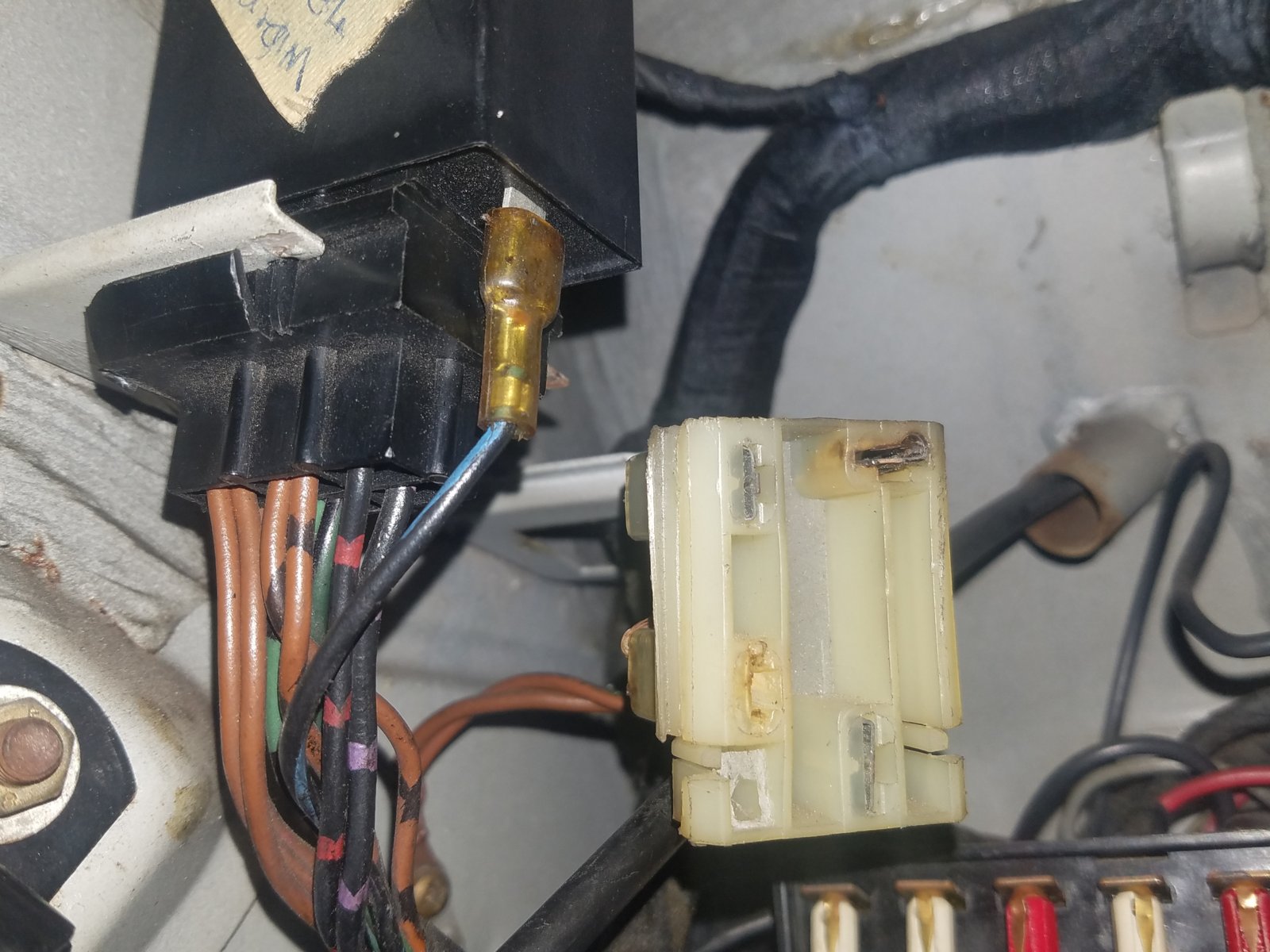

under dash by the fuse panel. Don’t have car here right now, perhaps someone else can detail location. I’ll try to send a photo.I can look on mine, where is it?
Steve, links are in my posts above. Push the door jamb switch in and out and you can feel the relay as it clicks.I can look on mine, where is it?
This is what is in that spot:
Keshav ,If someone is looking for this one, Joachim at bts has it
Entlastungsrelais
Entlastungsrelais Fahrzeug-Elektrik / Scheibenwaschanlage Entlastungsrelaiswww.bts-autoteile.de
