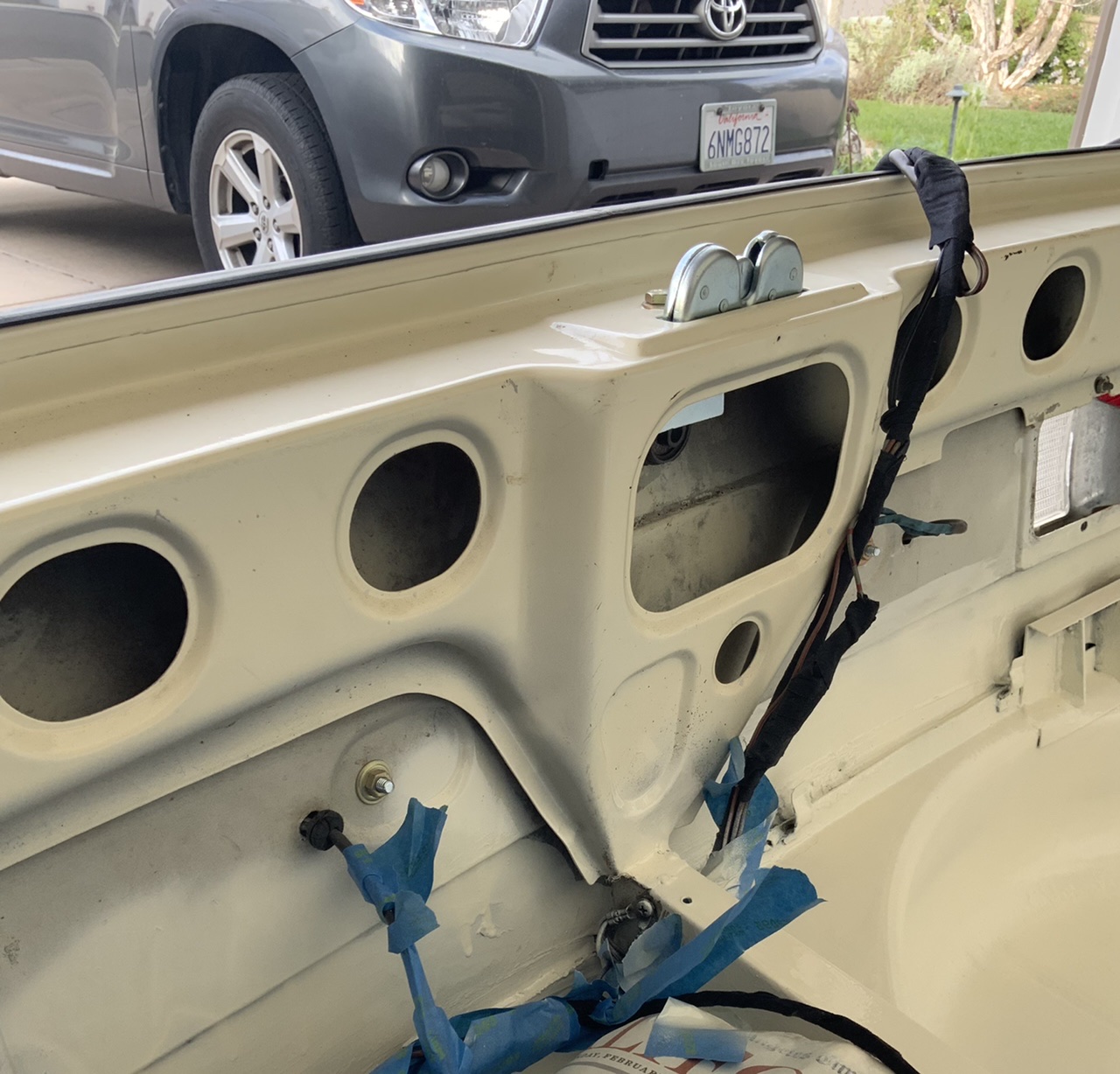

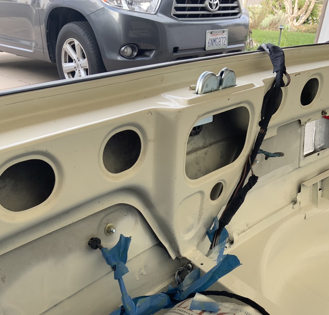

If the vinyl covered tail panel is still in place I don’t know how you will be able to reach the lock itself. The lock tab has to be in the vertical position at 12:00 to hit the horizontal striker visible in second photo.
h
When the lock is locked it touches nothing and provides no resistance. When unlocked there is resistance as it hits the striker. The key only turns 90 degrees, are you having trouble turning the key or pushing in on the lock?
View attachment 136657View attachment 136658 h
The key is currently horizontal. I turned it from vertical to the right to lock. There was resistance but it popped into full horizontal position. That’s where it is stuck. The button presses in like it should but in locked position does nothing

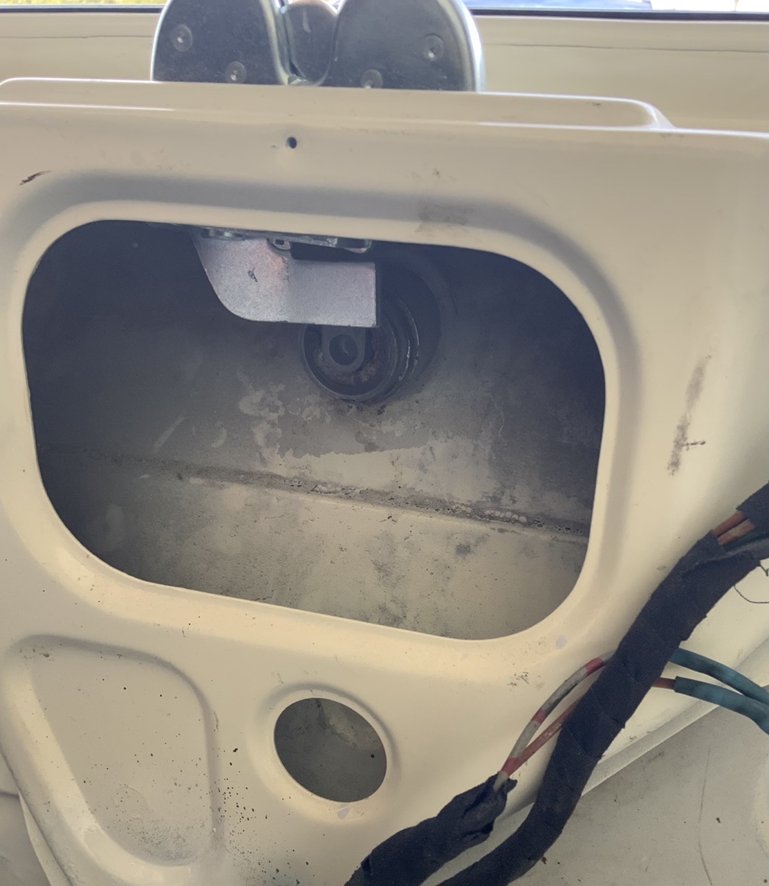

I wonder if the striker is bent and the lock tab is trying to get behind instead of in front of it.
With tail panel in place it is tough. If gas boot is off, you would need to reach in with a short screwdriver and remove the filler pipe clamp to have room for your arm.

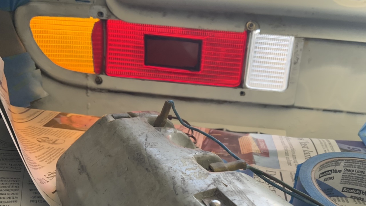

Long studs removed in this pic.

Thank you. Great pic. I have the vinyl cover to contend with but may be able to get around. So there are 4 nuts on the bezel inside I need to remove total correct ? Then the lens just pops off ?

Relooking it appears 2 nuts on opposing corners have long bolts. Removing the 2 inside nuts off them should release bezel. Then remove nuts holding lenses to the body which are also removed from inside. Sound about right ? Can’t tell you how appreciative I am
You got it!
