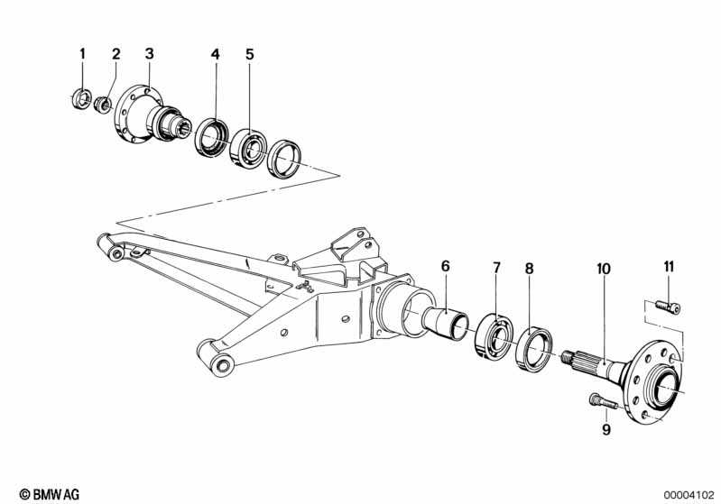

I have a set of vintage BWA 16" wheels I'd like to install on my coupe this spring. They require longer wheel studs to fit. They had be previously mounted on an e12 so they came with a set of longer e12 wheel bolts.
I have a set of e12 front hubs. They look like the should fit on my e9. Anyone know if the e12 rear hub (item 10 below)would fit?
I personally like the option of being able to use wheel bolts incase I decide to go back to stock wheels I can just use stock e12 wheel bolts.
If you decide on longer studs-
Use- ARP 100-7715
Available e-bay, jegs etc... $30-50 for a set of 5 depending on source.
Worked great for me.
