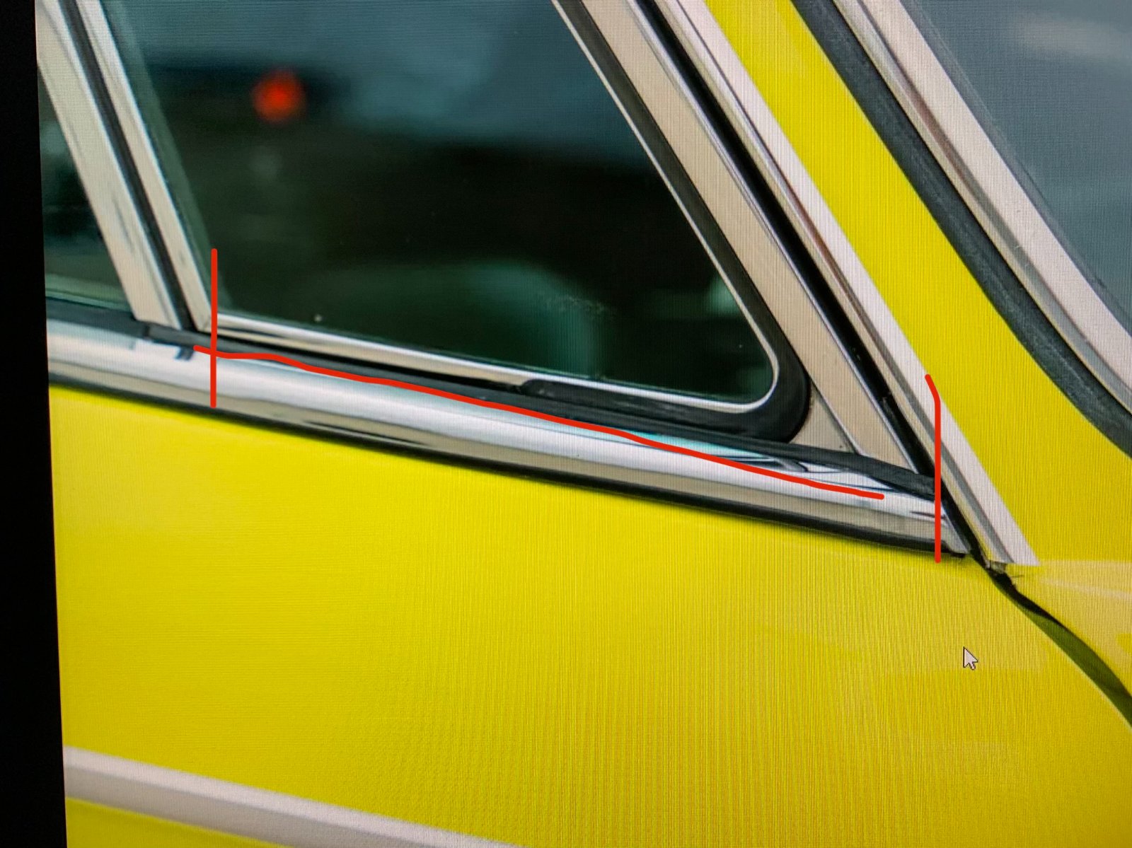

Hi,
I replaced the rubber seal part no. 51211813193 on the door trim piece but I'm missing the seal at the end of the trim piece by the vent window, look at picture with the red marker.
Appreciate the help,
Best regards

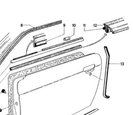

What you are looking for?
or that one?

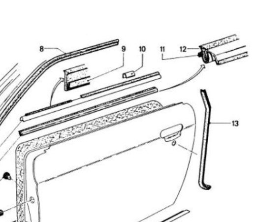

Maybe you talk about number 12?
51 211 813 195

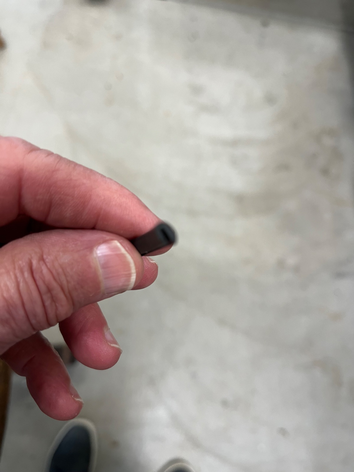

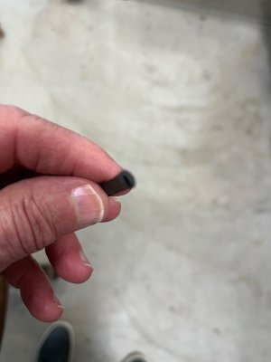

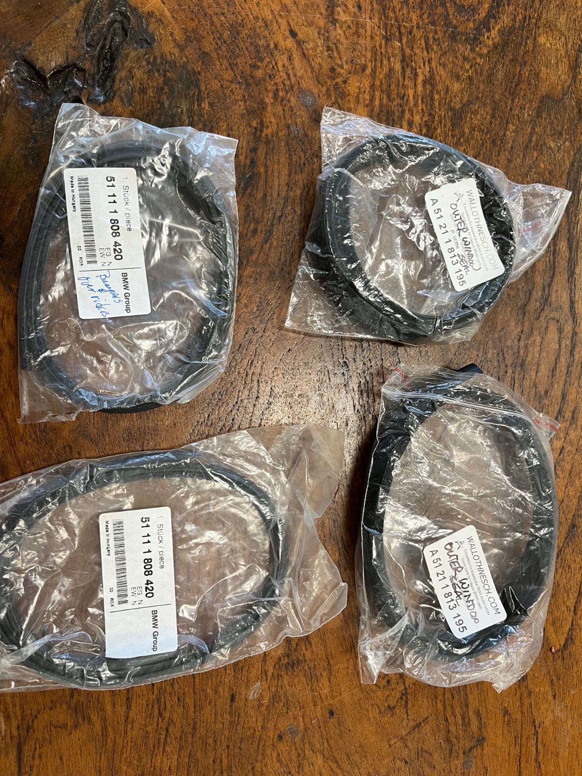

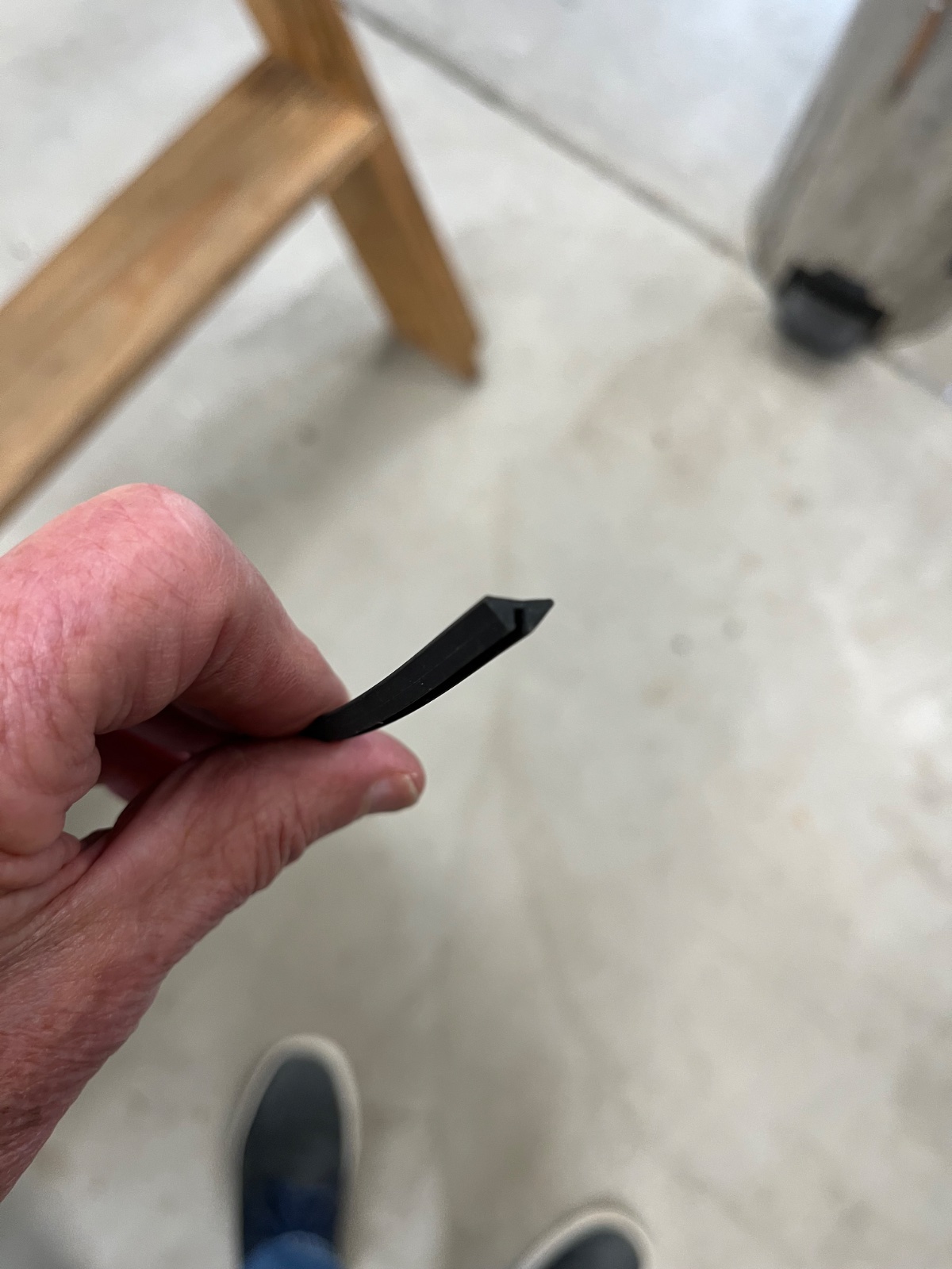

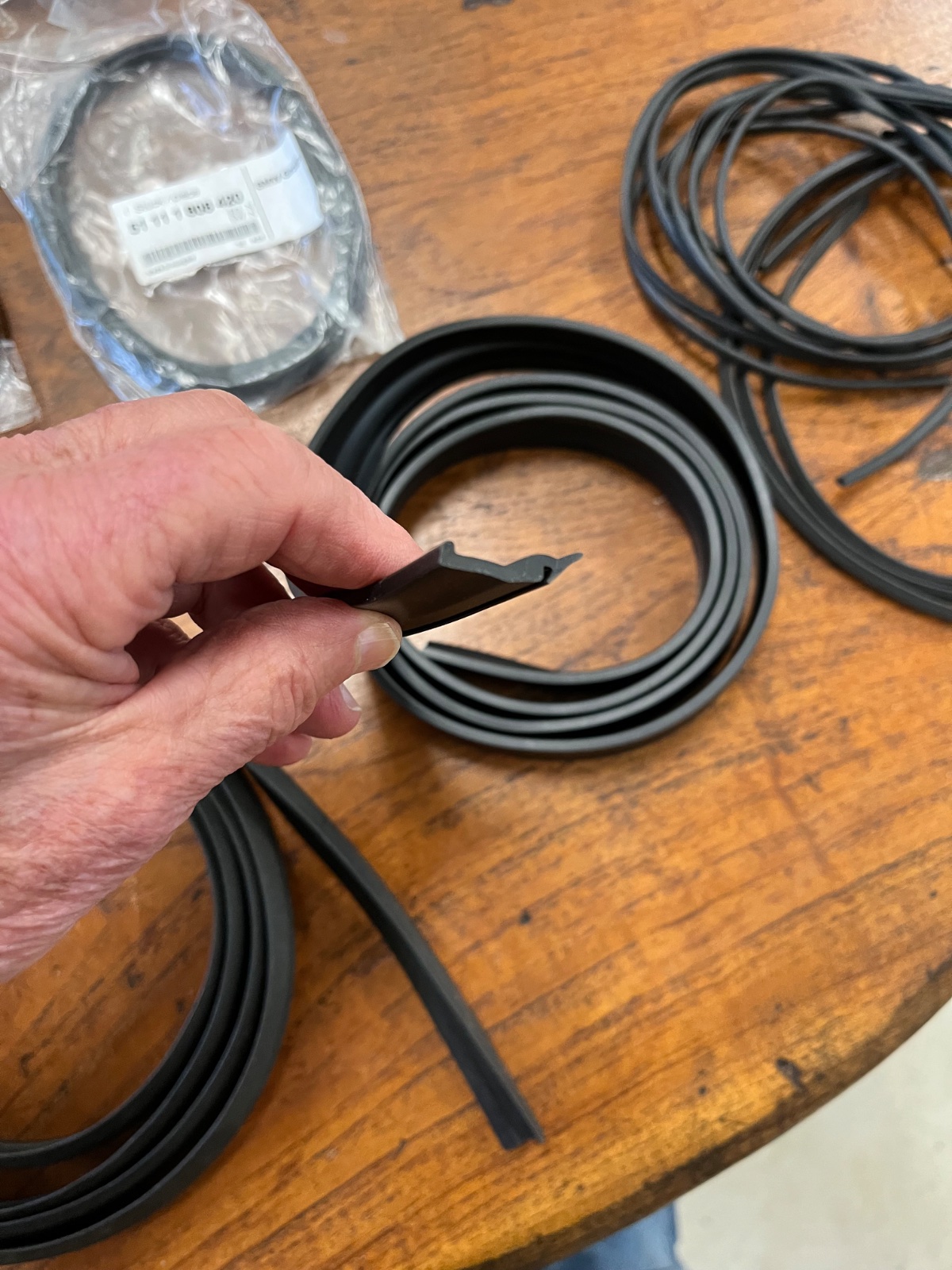

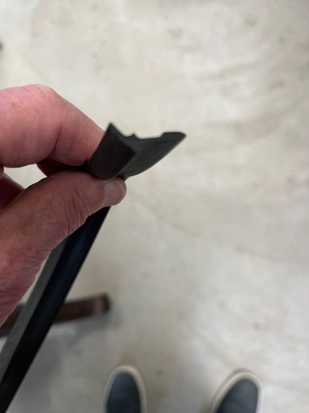

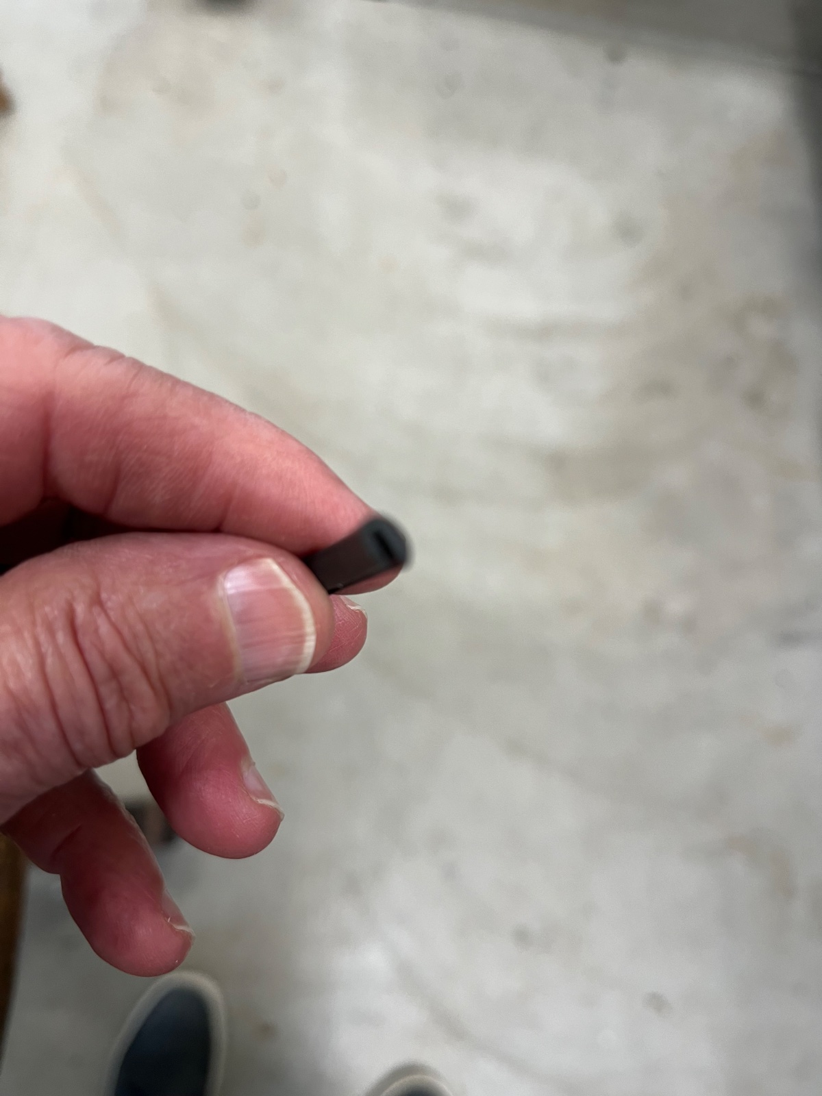

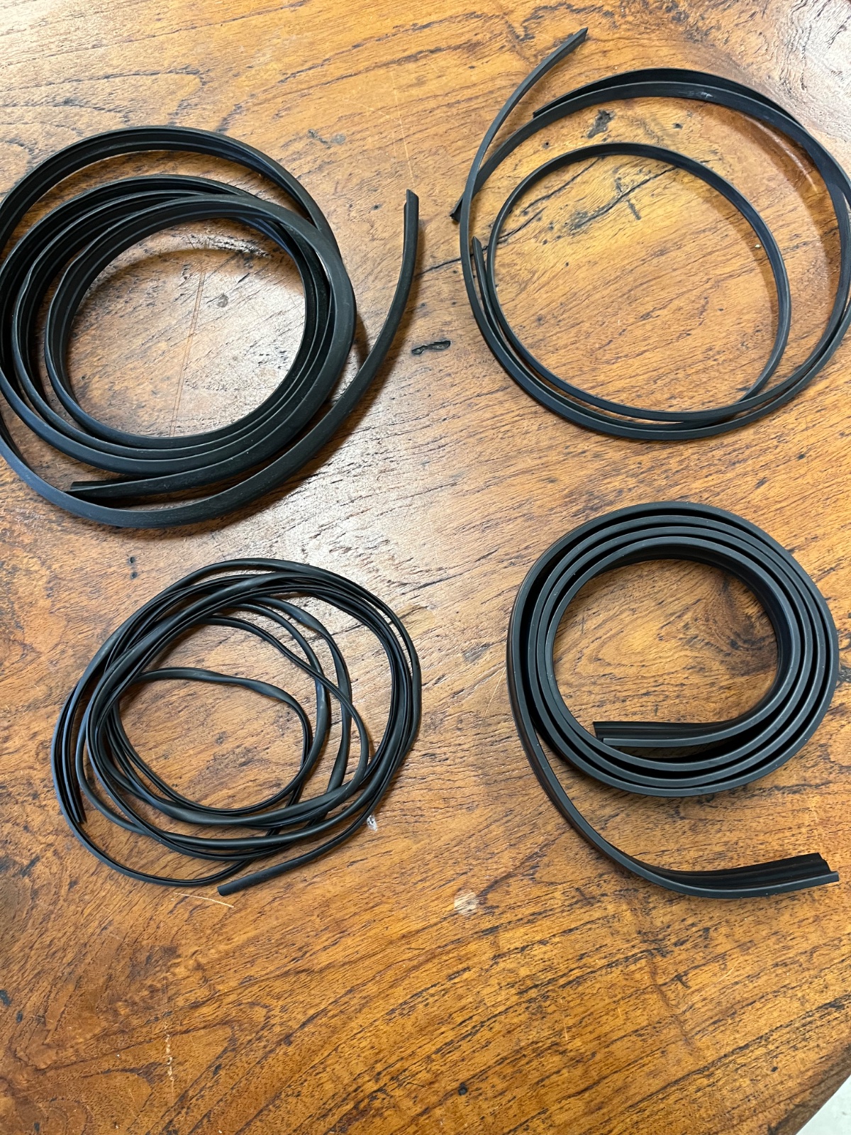

Here are pictures of some of the black rubber trim I have for our Coupes. All new not been installed or used. I tried to get a good profile shot of the ones that were not labeled. Don’t know what to change but it will be reasonable.
Regards, Jon

I believe that the piece that he is looking for is in the second picture ( L to R ) goes just under the outer chrome door molding only under the vent window. ( if you used the larger stuff all the way thru, it would interfere with the opening of the vent window ) 3rd picture is the seal for outside chrome molding on the door that scrapes the glass That piece only goes as far as the vent window, where the other smaller stuff goes The last picture on the top row is the seal that goes between the overriders and the bumper ( chrome bumpers only ) 1st one on the bottom row, not sure
Thanks, Rick

Thanks everyone for the response, I agree with Rick about the rubber on the second picture, IMG 8591
@Ives
img8593 is i think a relatively stiff, not rubber but pvc profile?
If so, then I think it is also used on the chrome, outside window scraper on the front door and on the banana shaped outside chrome part on the rear glass.
On those parts, it is located between the paint and the chrome strip to avoid contact of chrome-paint.
the piece that goes on the outer edge of the window sill trim (under the window / vent window) is a rubber 'U' channel
Jon,
51111808420 is the rubber that goes between the front bumper and the overrider / and between the rear bumper / underrider and the underrider and rear valance.
51211813195 is the rubber that goes on the bottom edge of the chrome sill seat at the glass
img8591 looks to be 51131827359 - seal at rocker cover to body
img8595 is 51211813195
my guess is img8593 is 51111808420
