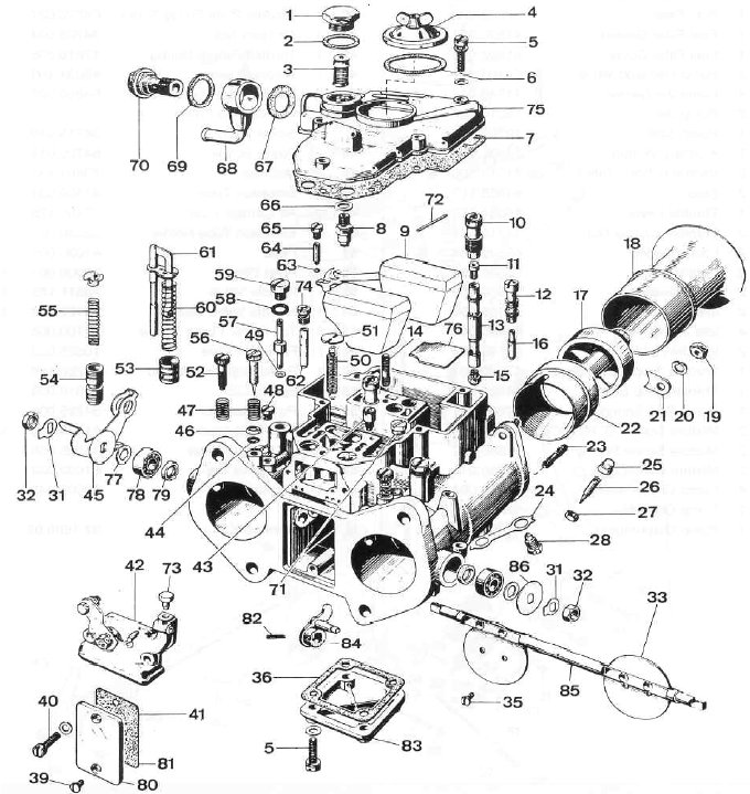

Where / what is pump bleed jets
Each carb has one pump bleed jet, located at the bototm of the fuel well. I believe it's #43. Do you have an AFR gauge installed? This will help tremendously. For DCOE 45's and 36mm chokes your jetting seems small, as if they were jetting down from a larger carb than typically fits the engine. Have you driven it yet with the existing jettings?
