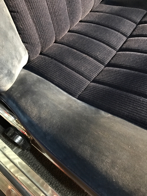

My 2800 cs has the classic blue velour upholstery. I am planning to change the front seats one but at worlduph.com it is NLA.
Any hint?

If NLA, anyone had ever tried to have this upholstery professionally colored? The texture is perfect, but the color is faded on the sides.
I used rit dye on a sponge and came out perfect including color match. You have to wait a few weeks so the dye dries and does not stain. Maybe about $3 t0 $4. Cheap fix with excellant results. I would try to use the dye on a small piece of Dk Blue fabric( heavy weight ) and see how it matches. If it's too light hade a small amount of blk dye and if it's too dark,,which I'm sureit won't be ad a touch of a lighter Blue dye.

This is the information you need for the velour replacement material:
The corduroy type material used in the middle of the seats is BMW part #
51 92 1 817 333. Only available directly from BMW in Germany.
The velour type material for the can be matched from Döpper in Germany.
http://www.doepper-oldtimerstoffe-gummiprofile.de
Their part number is Blaue Wollen Stoff P 91 11 322.
