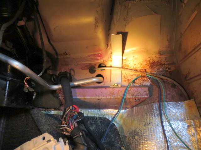

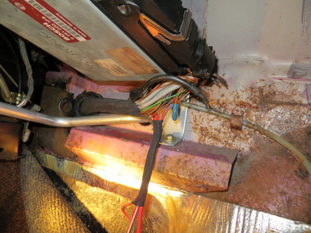

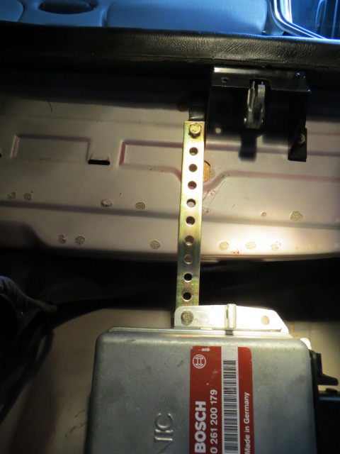

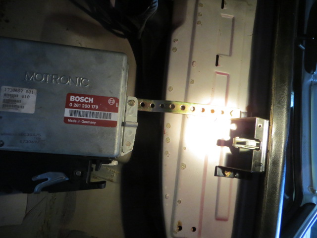

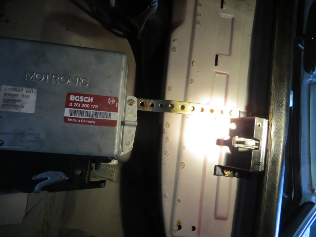

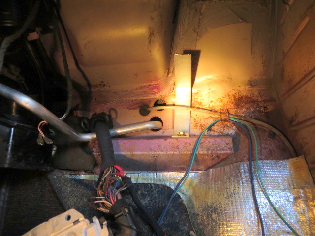

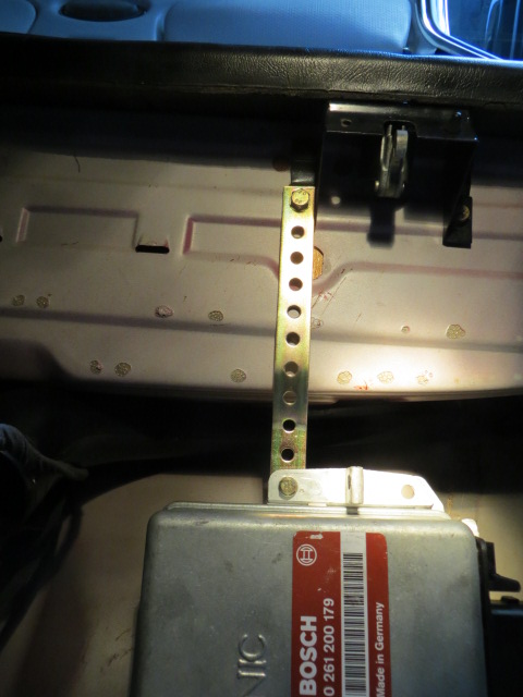

Mounting pictures and options. I am thinking of taking on that task soon. Has anyone found good options on Amazon of premade products that might work well in creating a shelf or mounting for the ECU in the E9 glovebox. Just wondering?
I just used metal strap/brackets from Ace Hardware and used the glovebox hinge shelf and the latch itself to suspend it above the glovebox.

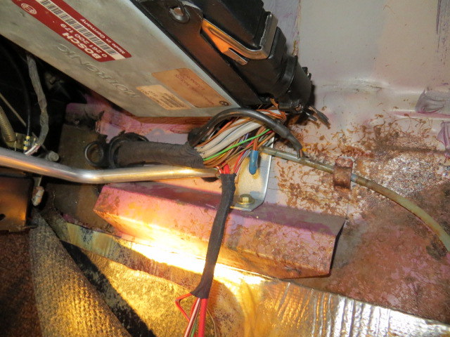

Juan made two that I know of, he does not make them to sell. Here are my pics, very simple, if I can do anyone can.

Juan made two that I know of, he does not make them to sell. Here are my pics, very simple, if I can do anyone can.View attachment 158922View attachment 158923View attachment 158924View attachment 158925
Chris,
Thanks. This does looks straight forward and I can angle the box so it is facing the wire harness plug to make things easier.
