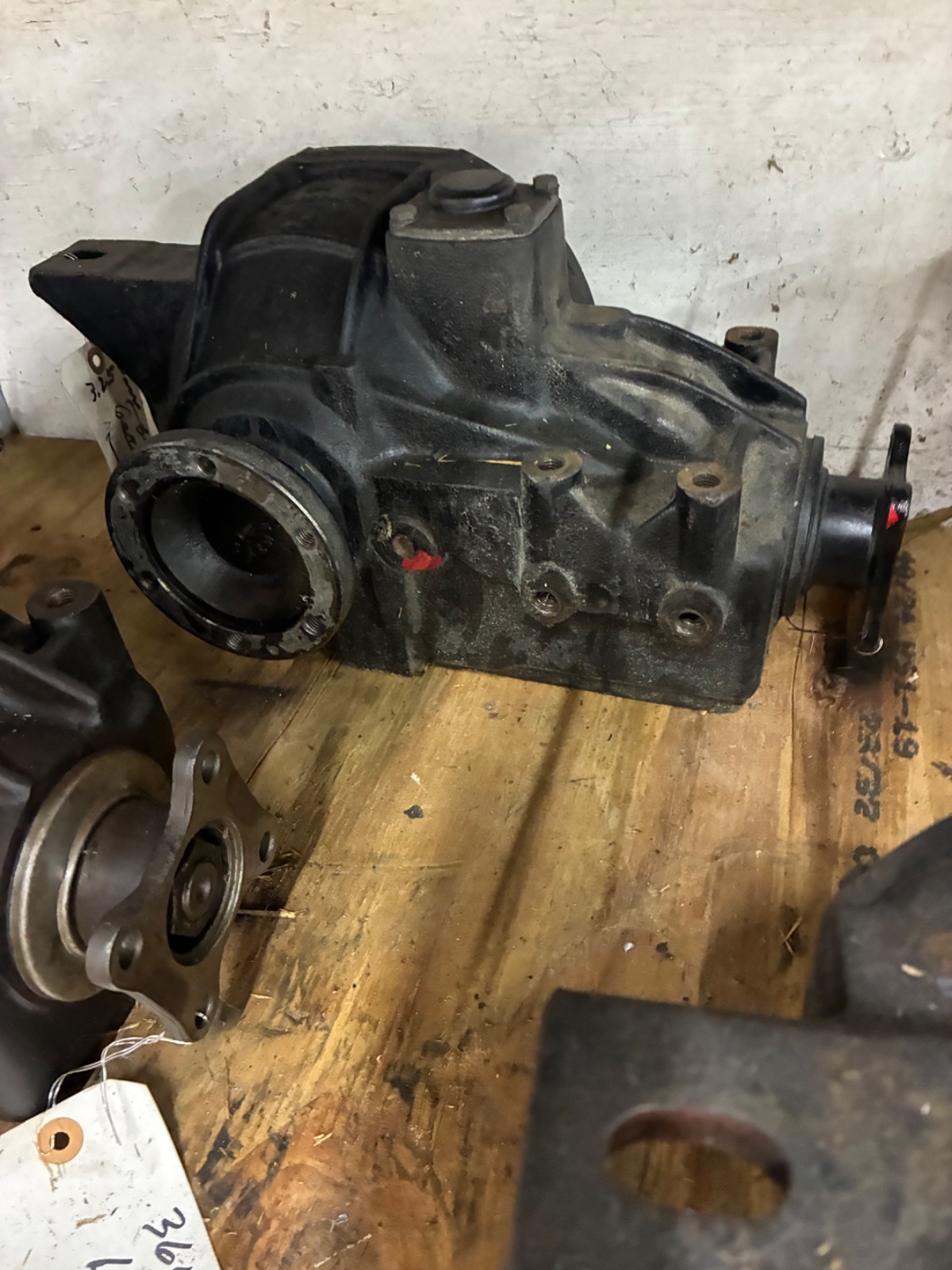

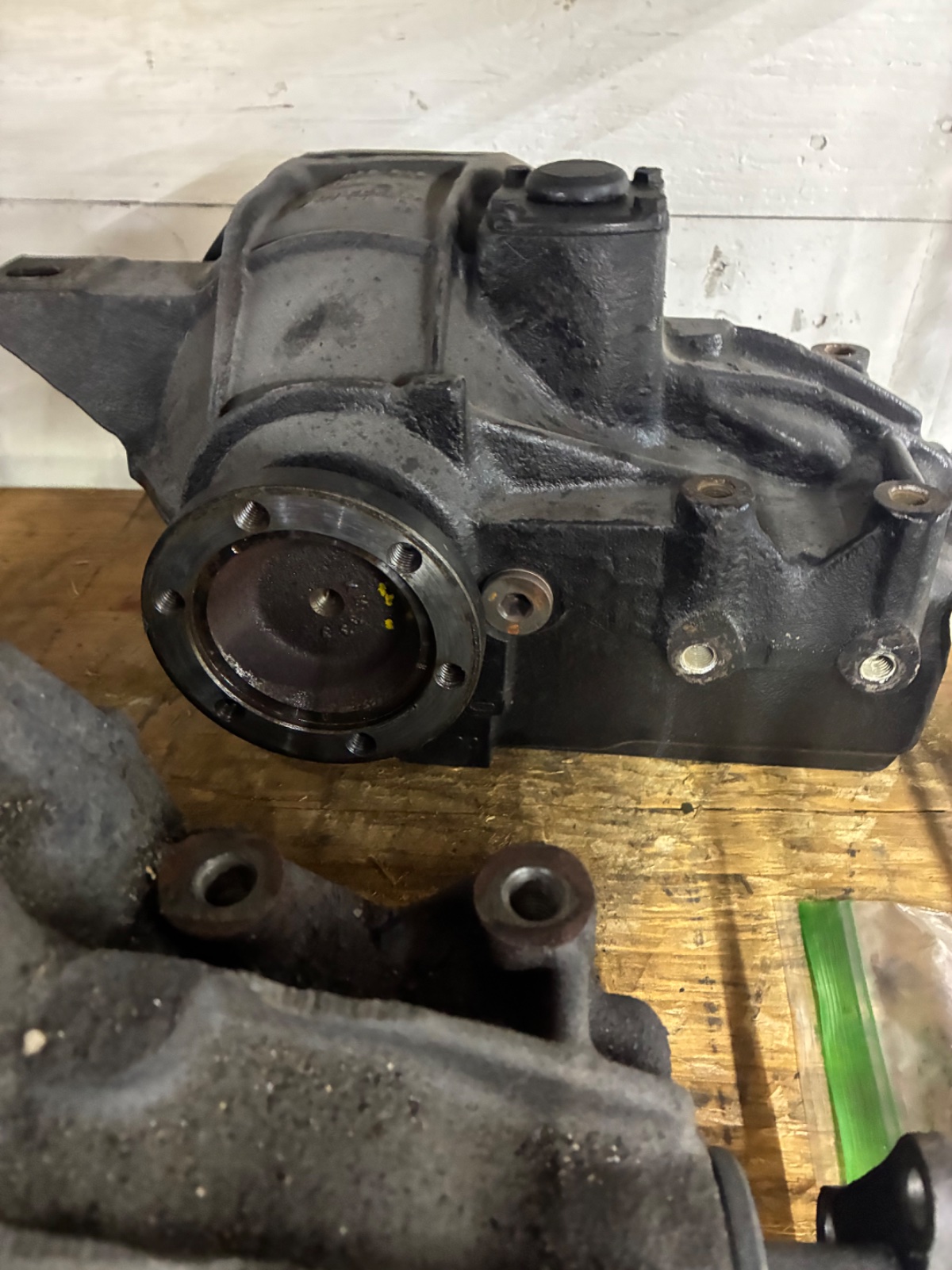

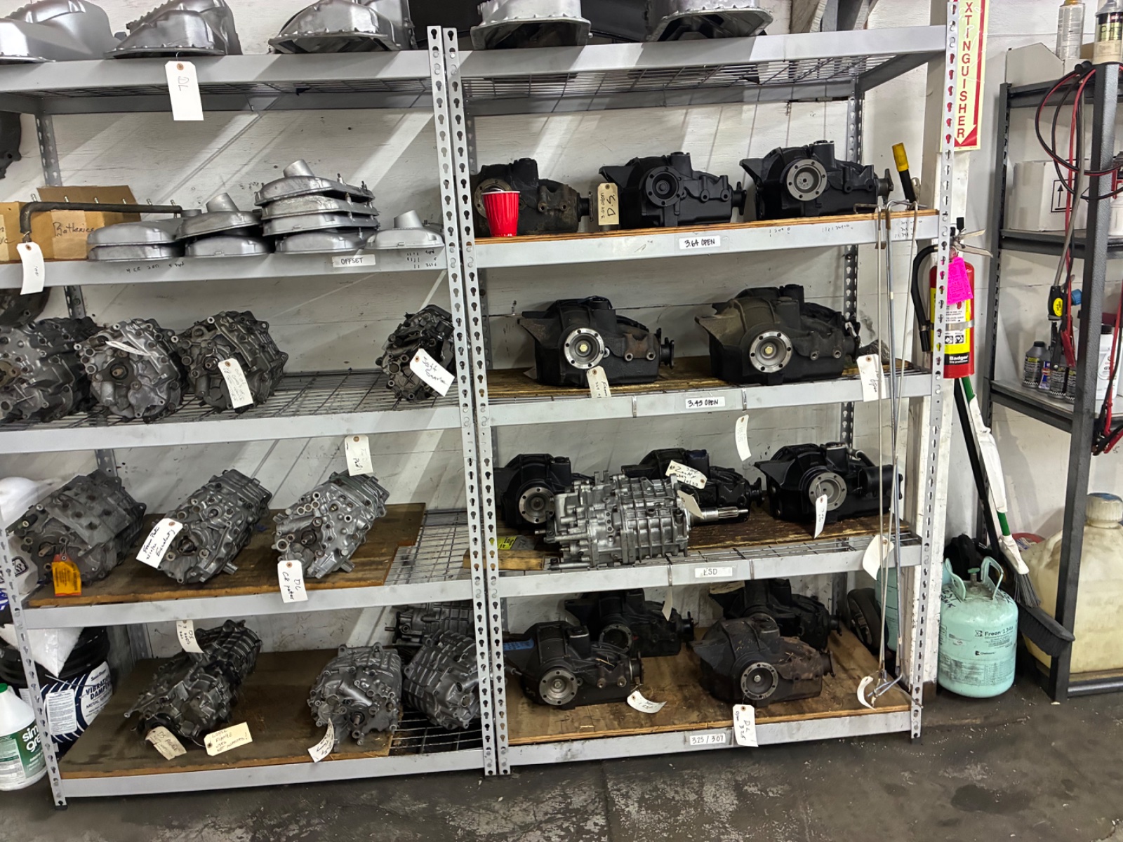

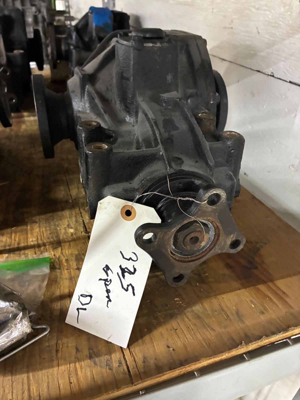

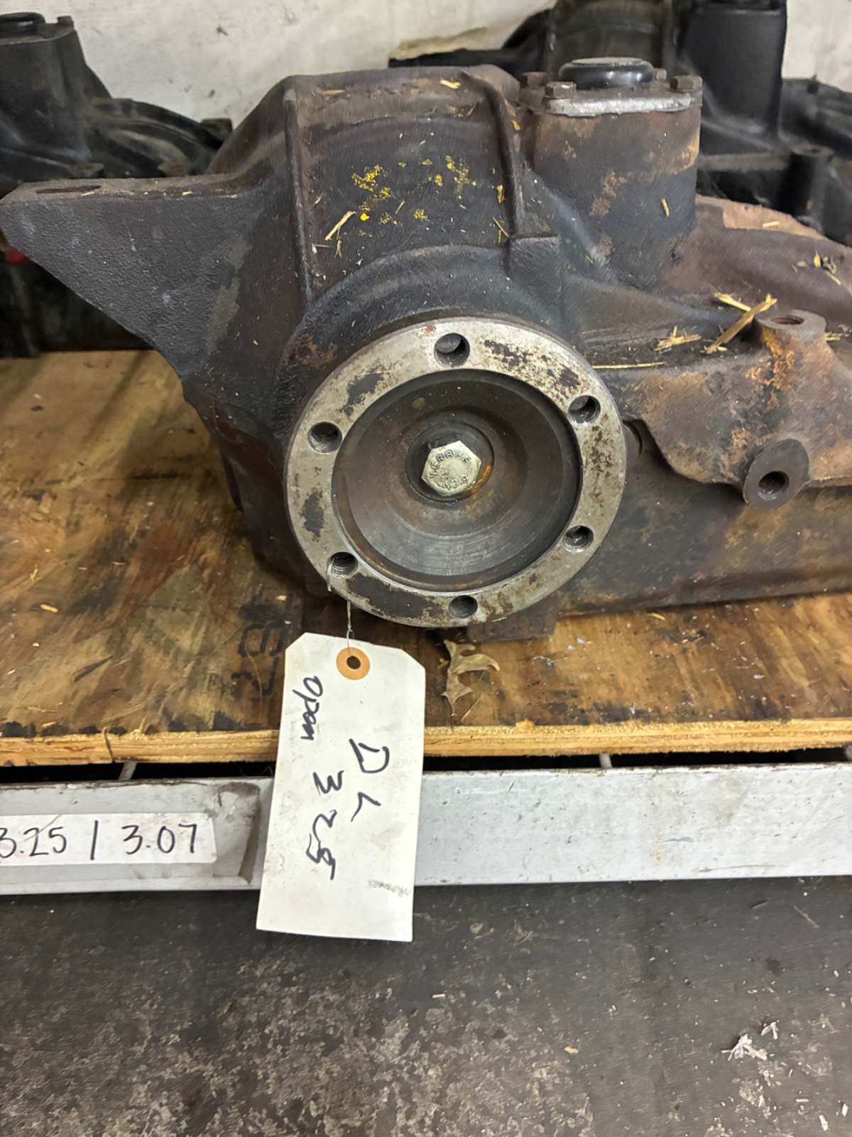

There are several diffs listed under the e9coupe parts for sale section for a variety of prices. You may also find some at wrecking yards or FB marketplace near you.

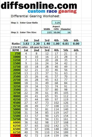

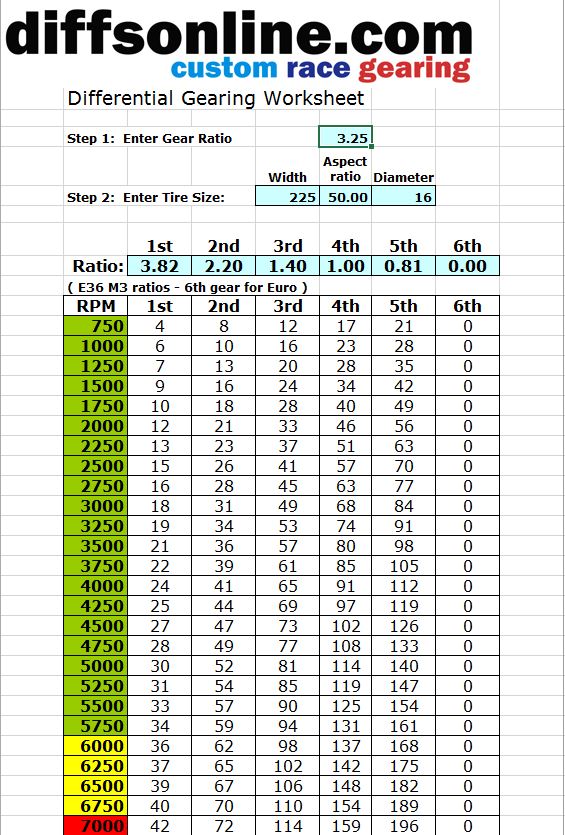

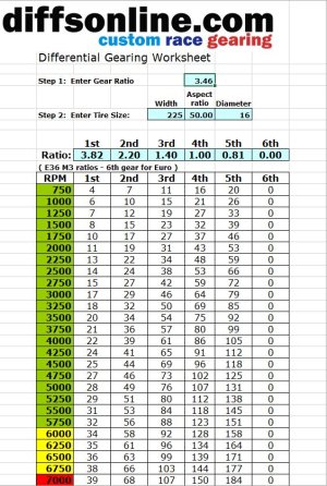

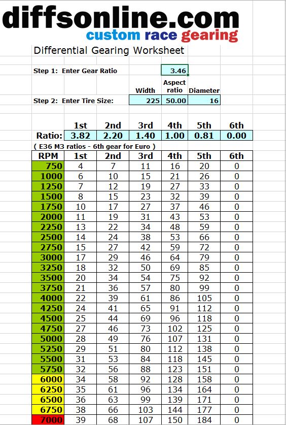

And speed by gear ratios here:
From the replies so far it sounds like the 3.25 LSD is what would be best - but I don't see any right now~
