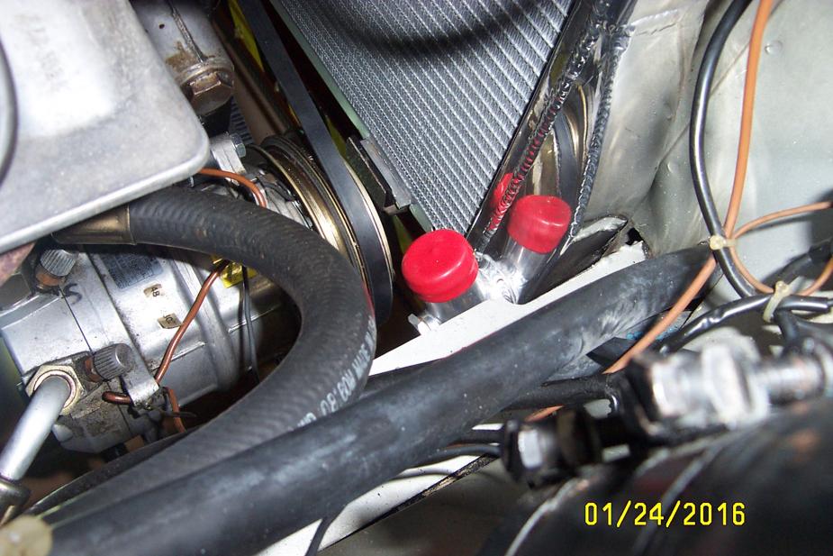

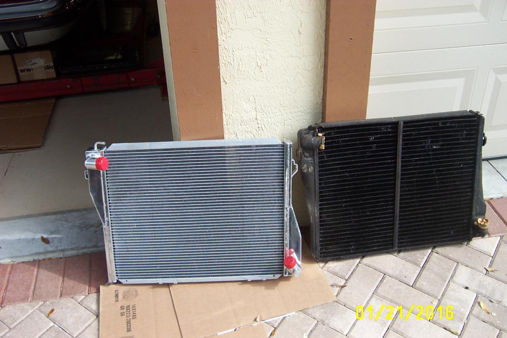

Made the decision to go with an AL radiator from Ireland Engineering (have no affiliation) over getting mine re-cored. It ended up being almost $100 cheaper and not being "original" is not as important to me as functionality. The rad has over 40 horizontal pairs of passages as it is a two row.
Here is a picture of the radiator as received, which appears to be very well made and does look great. It is sitting next to the original manual shift radiator. Note the position of the lower right hose attachment. The AL rad attachment is welded at a higher angle than the original which did present an interference with the AC compressor. But by adjusting the AC compressor mount and using shorter belt moved the compressor enough to clear. Other than that it fit perfectly with some minor trimming to the bottom tangs evident in the photo.
Also note how many more rows the AL has over the manual rad which has 30. The auto rad that was in the car has 32 rows of 2.
