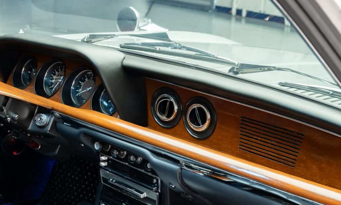

Shouldn't be a big deal as long as they fit in the standard E9 loudspeaker cover frame.
This piece should be a piece of cake for someone to 3D print and even add some texture.
Needs to be wood in my opinion to match the dash, perhaps slight round bevel on the edge.....
not too sure about mounting it on a wood plate - the plate won't match the dash wood + grain. i guess you could make the dash panel with 'speaker delete' and mount the gauges into the wood ... if you made a wood panel that fits into the speaker recess ... the wood is going to make it look like it belongs there ... its not easy to make look good.

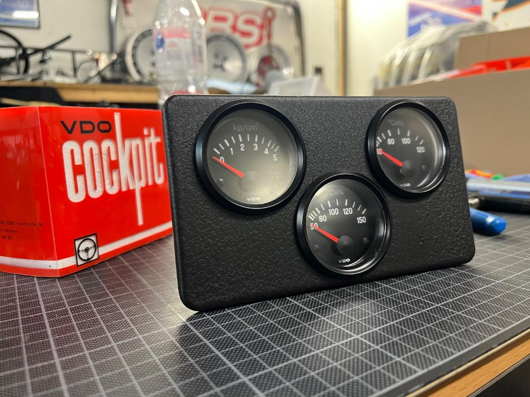

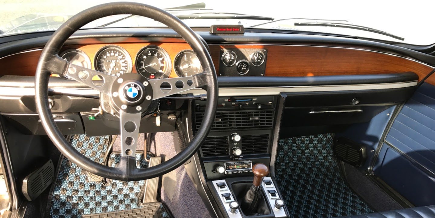

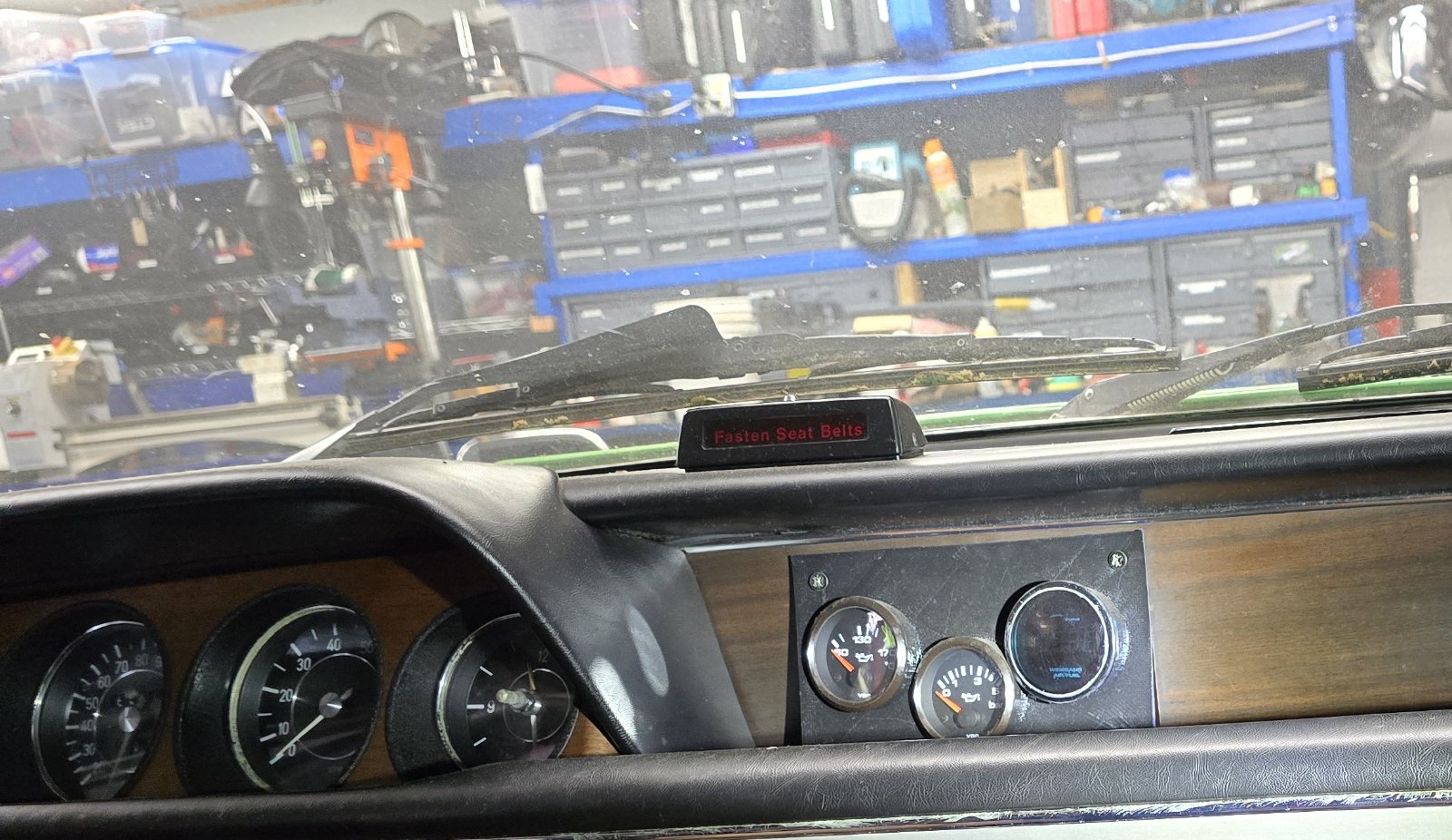

it looks quite good in metal with a textured paint finish ... kind of a charcoal black color. the first one is from an unidentified car (upside down) ... an Alpina style plate. the next
one is an Alpina plate with VDO series 1 guages. the last one is @Stevehose interior with an Alpina plate with VDO series 1 gauges.

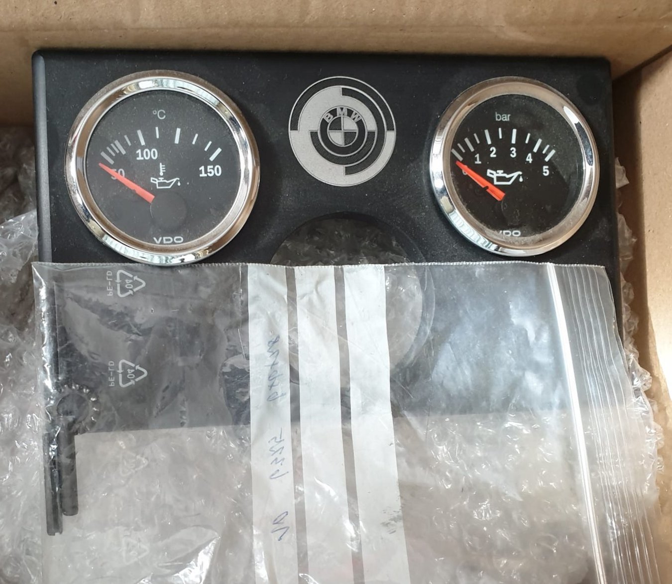

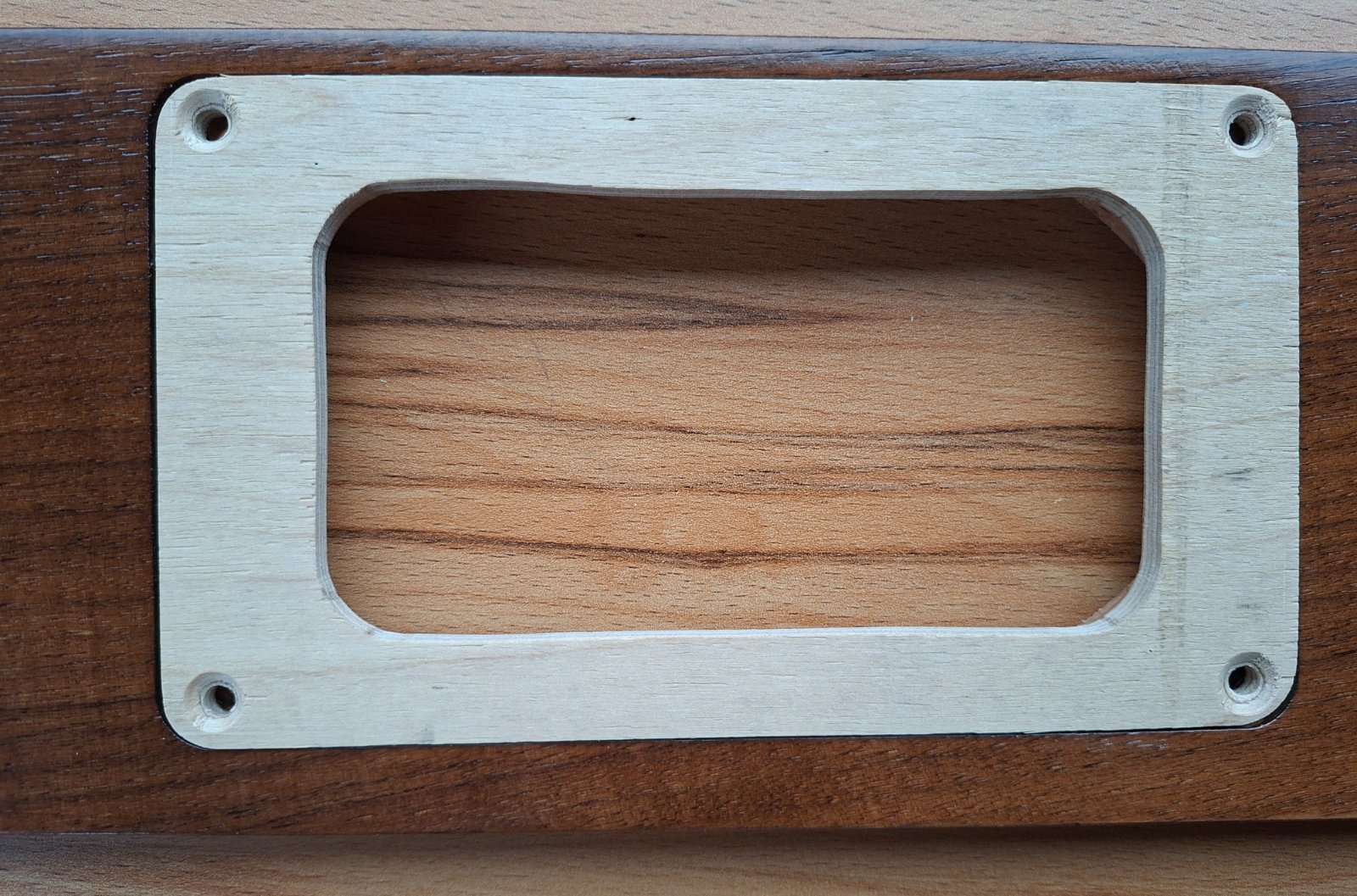

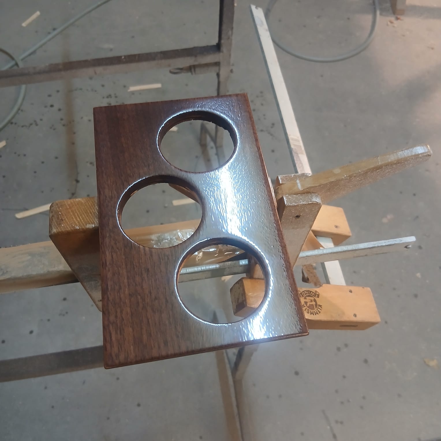

This is made from two plates:
- the base plate which fits exactly into the loudspeaker opening of the dashboard. It's fixed by the metal anchors, if these are not available we use the PVC type.
- the front plate, either plain wood or with a layer of veneer, american walnut stained in the original tone followed by three layers of coating
Both plates are glued together, the openings drilled afterwards.
Now waiting for 3rd layer of laquer to dry.
And for the VDO instruments to receive the chrome rings and white needles
