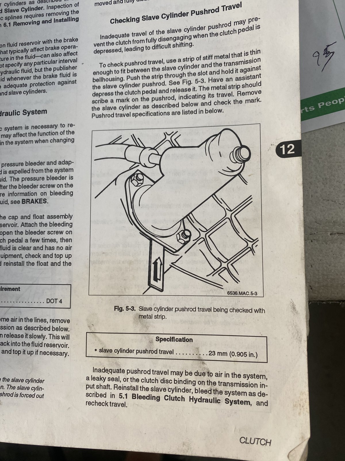

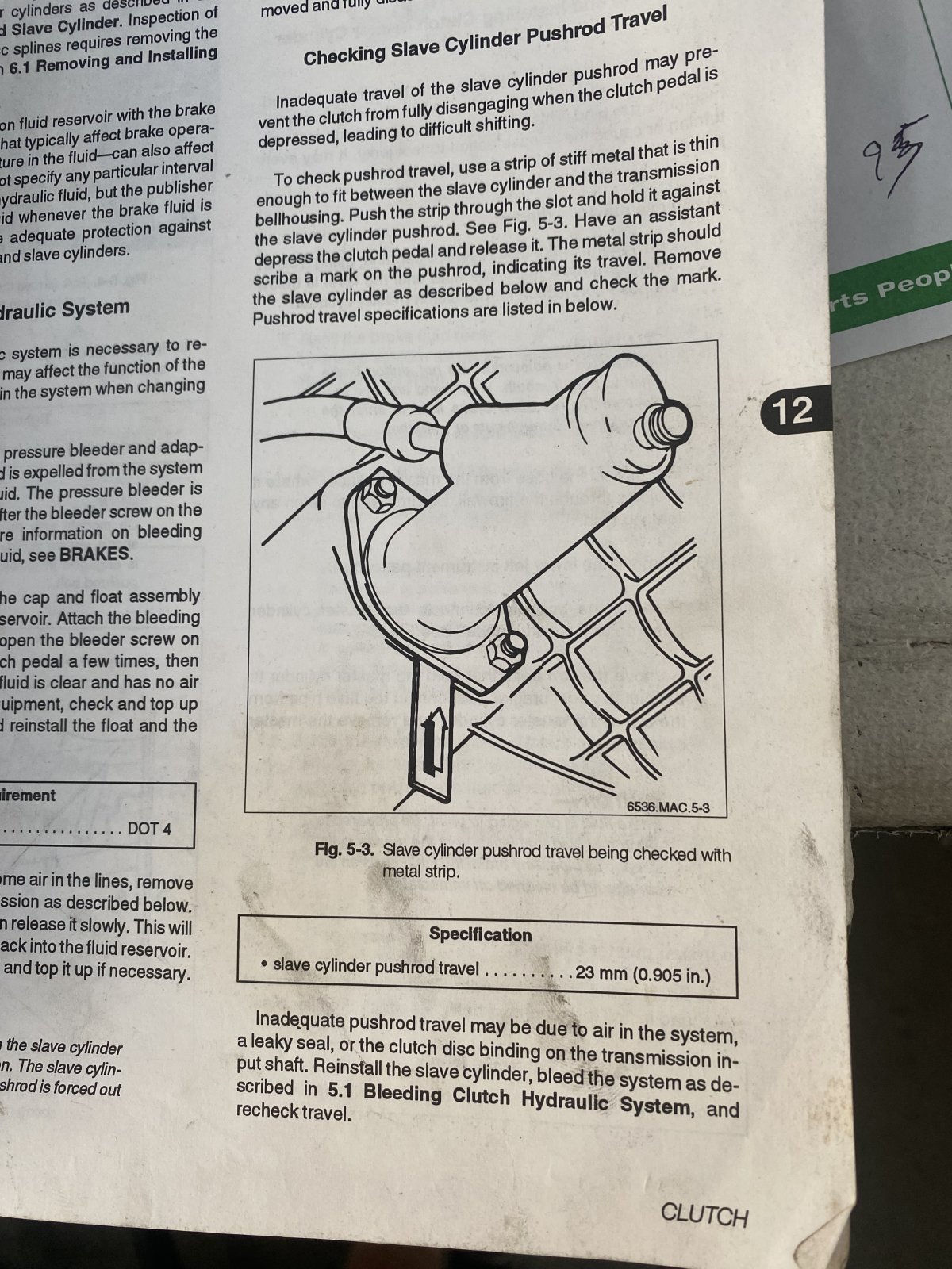

Had a difficult problem with another person's bimmer - evenutally it was discovered that the piston in the clutch slave was stuck in the fully depressed condition. You'd have to disassemble the clutch slave to assess this, or know from experience how much of the clutch actuating rod should be visible when operating normally.
Yeah, I have a clutch slave rebuild kit and a core, but at $18 for a new one I haven't bothered to open up the one that failed.

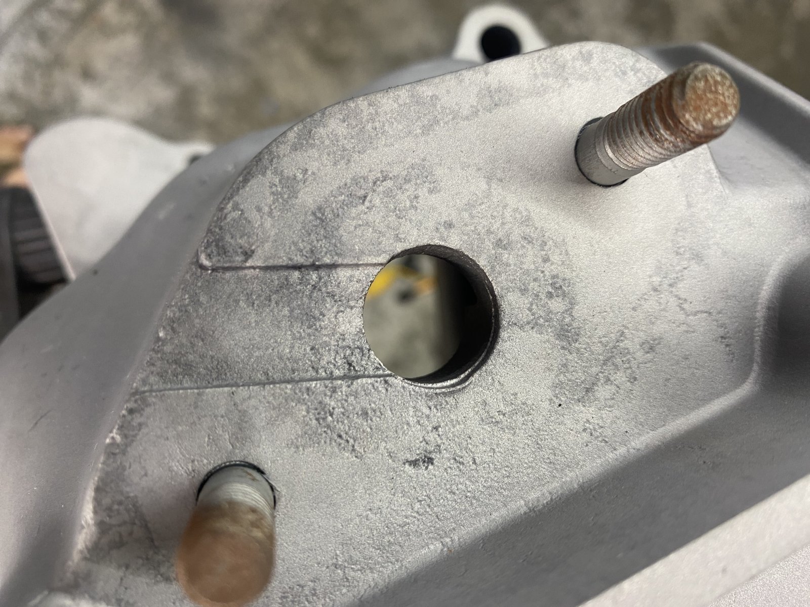

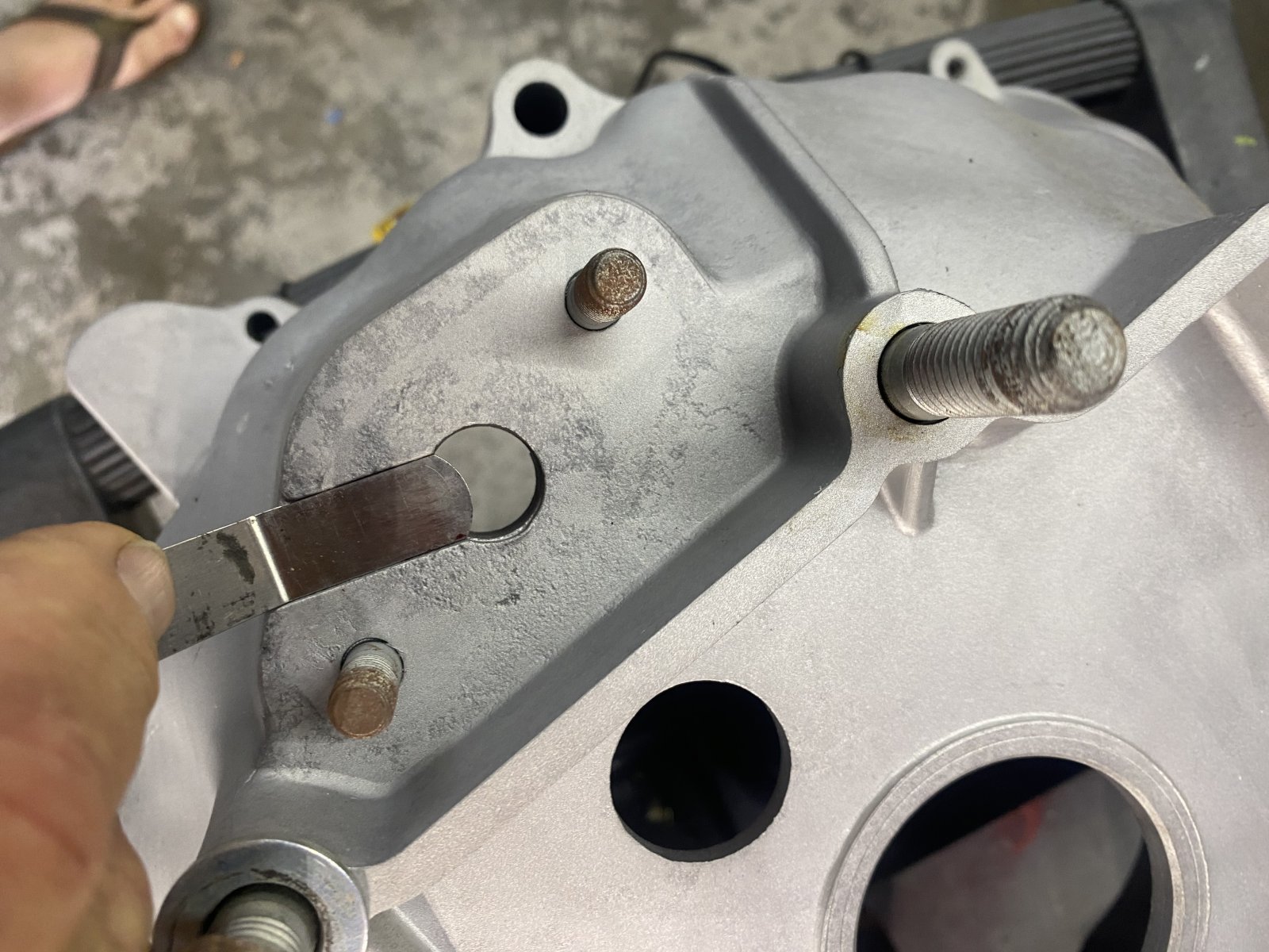

I have an “inside” slave so I can’t see what it’s doing. Yet another one of those quirks we ‘74 owners have to deal with…
There is an indent right there so you can measure shaft travel. Read the book- it gives instructions.
