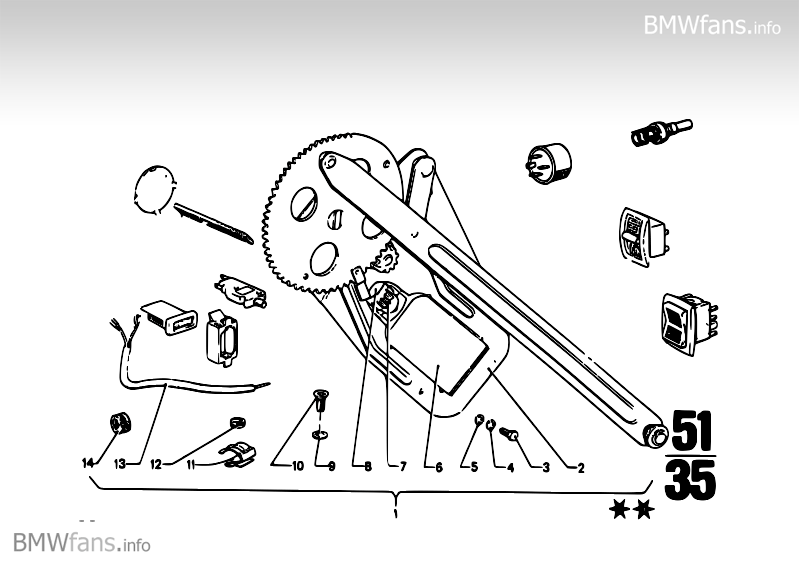

I have not closely examined either the front or rear window motors for quite some time, but I vaguely remember the rears had a semi hard black rubber "nose" above the white pinion gear. The rubber nose was shaped differently from the fronts. I could be mixing up motors with those used in newer models. Any idea if the rubber portions are interchangeable (front and rear) and whether they are a "slipon" or "friction" fit?
The realoem diagram does not depict the "nose" (No.8 ) the way I remember it, but it does indicate "production discontinued." As I tried the windows today, and they function quietly and smoothly, I will leave well enough alone.
