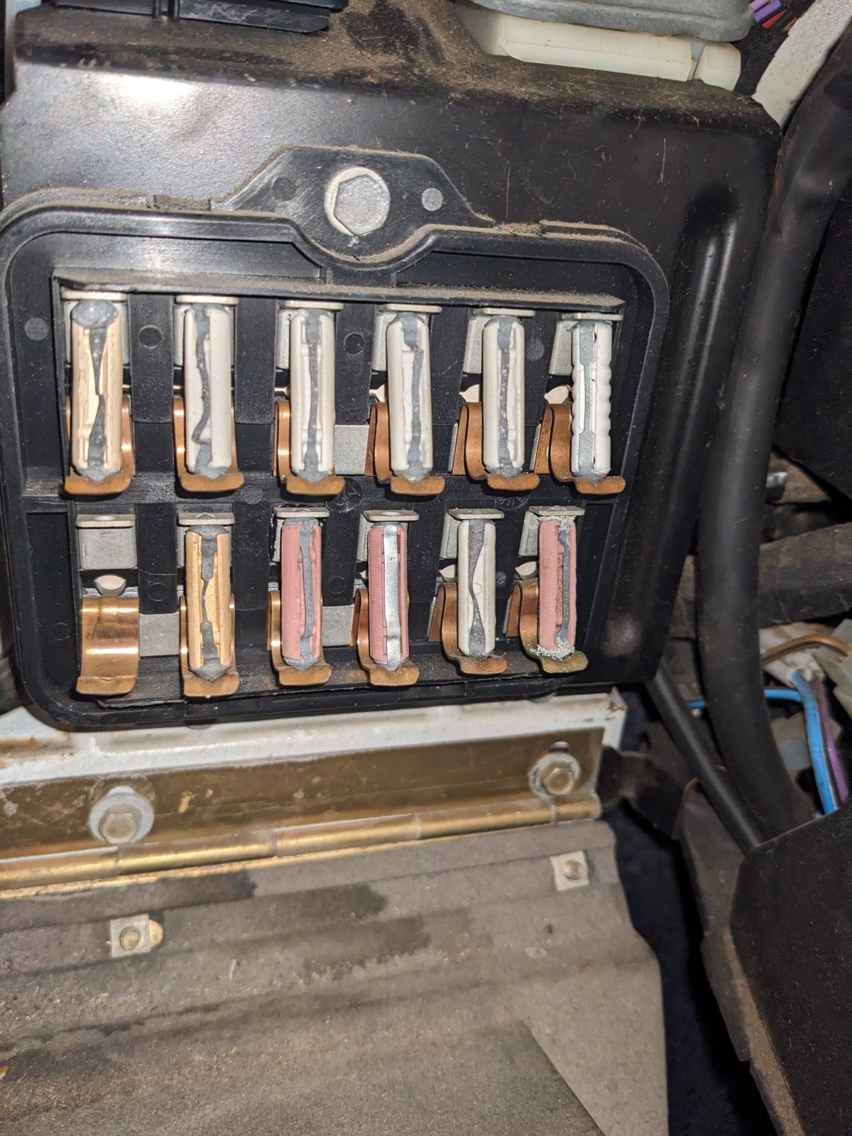

Fuse 11 (bottom row, second from right) looked a little suspect. Wasn't blown, but looks tired (image attached). Swapped out for new 8a fuse.
Still have the hose connected that goes from air filter housing to valve cover.
Can't imagine a simple fuse change will solve this, but worth a shot. Will try a start up in the AM as to not wake the sleeping baby and toddler tonight.

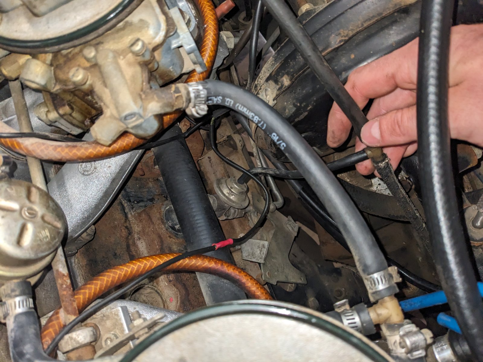

I'll drop in a picture of the T setup I am referring to. Likely wrong with my terminology and description, still learning my way around these older cars.

As to the T, that line you describe as a fuel line is actually the line to the reservoir in the trunk above the right rear tire that collects gasoline fumes from a hose connected to the fuel tank filler neck. The system is designed to hold fumes when the car isn't running, and then to draw them into the engine through that small connection on the air filter housing.
Dick - picture attached of the T connector with the lines running from charcoal canister, air filter housing, and a control valve?

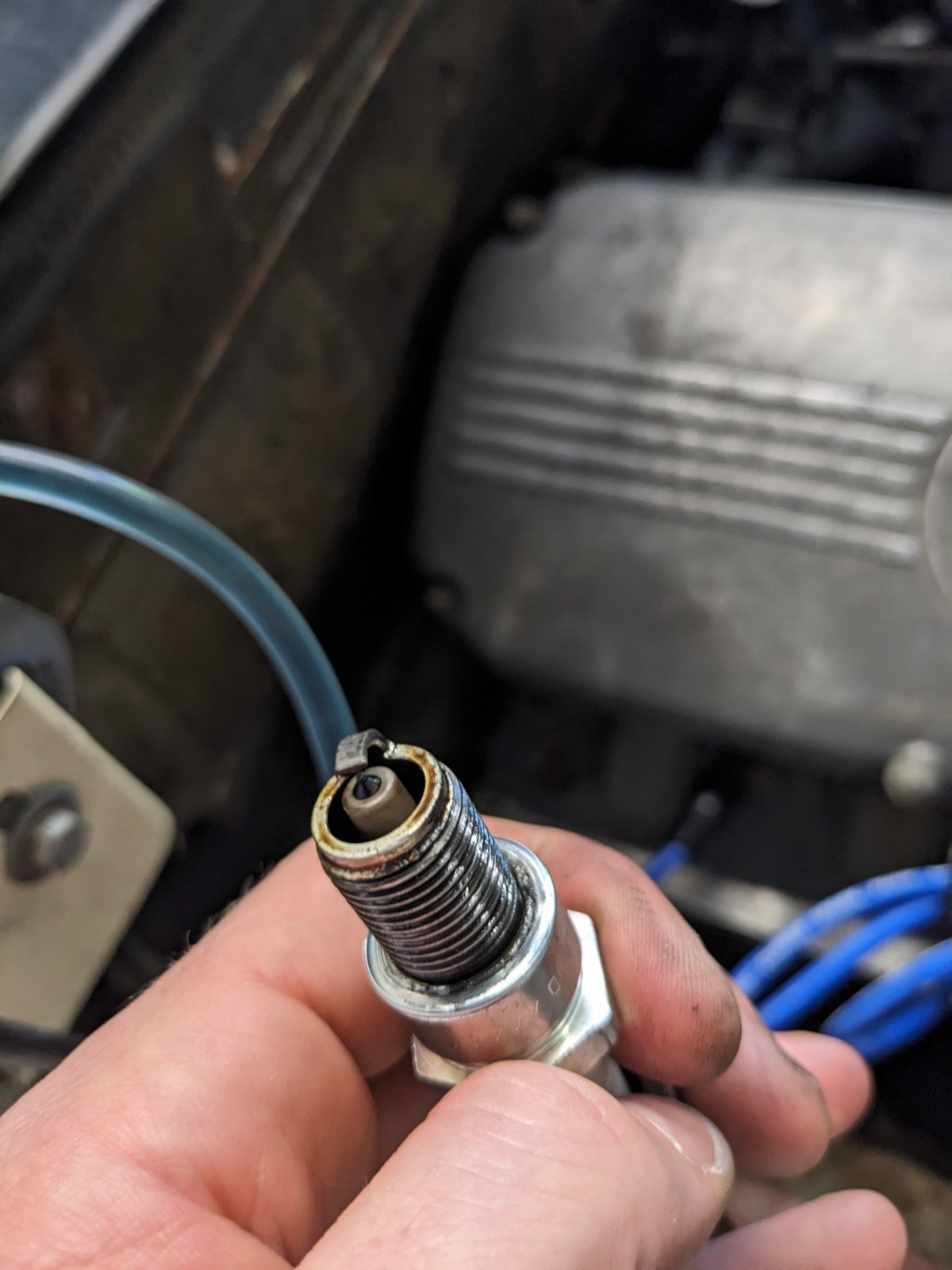

Plugs have only been in the car for maybe 75 miles, and look a little wet :(
Picture attached of plug example. All look about the same.

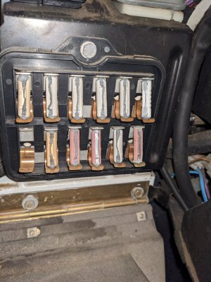

This probably isn't connected to your idle issue, but look closely at the fuse on the right end of the lower row of fuses. It's got corrosion at both the top and bottom. In addition, all the fuse links look pretty oxidized and the copper contacts are dirty. All the fuses should be removed and their ends cleaned. A bit of very fine sandpaper or even a pencil eraser should do the job, and the copper contacts should be cleaned as well. This is why the later blade style fuses are superior.
Good call out, thanks for the recommendation. Should clean them all. I did notice tho corrosion on terminal 12. Replaced that fuse the other night when I did #11.

Next, reasonable minds may differ but you might consider changing to a more conventional spark plug for reasons discussed here: https://e9coupe.com/forum/threads/spark-plug-recommendation-pls.14155/ One suspects that your Allison optically triggered ignition should have no problem with fine wire plugs. Nevertheless, the chorus of conventional wisdom seems to think otherwise.

My small screen limits my ability to fully explore your image and whether the “control valve” you reference is for fuel return or possibly part of an EGR system. It may be the former, since I cannot discern the existence of EGR ductwork. Needless to say, if any part of an egr system is stuck open, it can negatively impact engine operation, including the ability to achieve a smooth idle.
