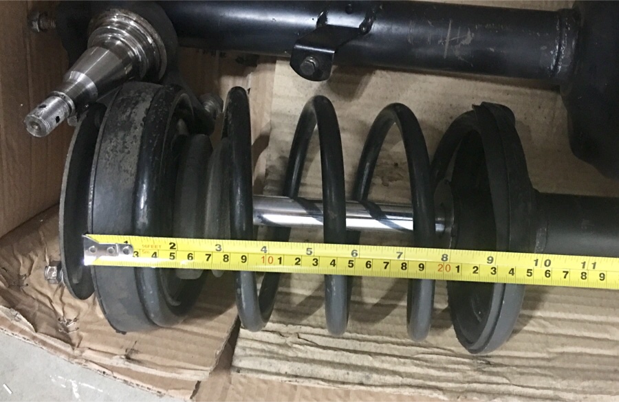

Hi,
I just recieved a set of lowering springs for my car, and there seems to be a problem with the uncompressed lenght of the front springs. They measure 18,5cm (7,28 inches) uncompressed which leads me to believe the springs will get loose between the spring perches when the car is lifted from the ground = won't pass MOT. Now, I still haven't contacted the company that I purchased them from, as I want to have some measurements of the minimum uncompressed spring lenght that I need for them to sit tight between the perches when the car is lifted from the ground before I do that.
Note that I haven't tried these 18,5cm long springs in my struts, but I strongly suspect that they are too short.
My car is in storage and not easy accessible at the moment, and even harder would it be to remove the front struts and start measuring. So I thought maybe someone here knows or can measure for me.
It would be great to know the lenght of other lowering springs, for example Carl Nelson springs.
Any input appreciated!

So, I have Carl Nelson springs, and right now my car is on jack stands awaiting front rotors. I estimate the springs (hanging with no weight on them) at 250mm.
The springs in your picture look way too short to me.
Thanks alot for measuring, Chris!
And so I understand correctly, the CN springs don't rattle between the perches while the car is on jackstands?
Thank you both so much! Exactly what I needed. Now I can discuss the problem with the seller.:)
