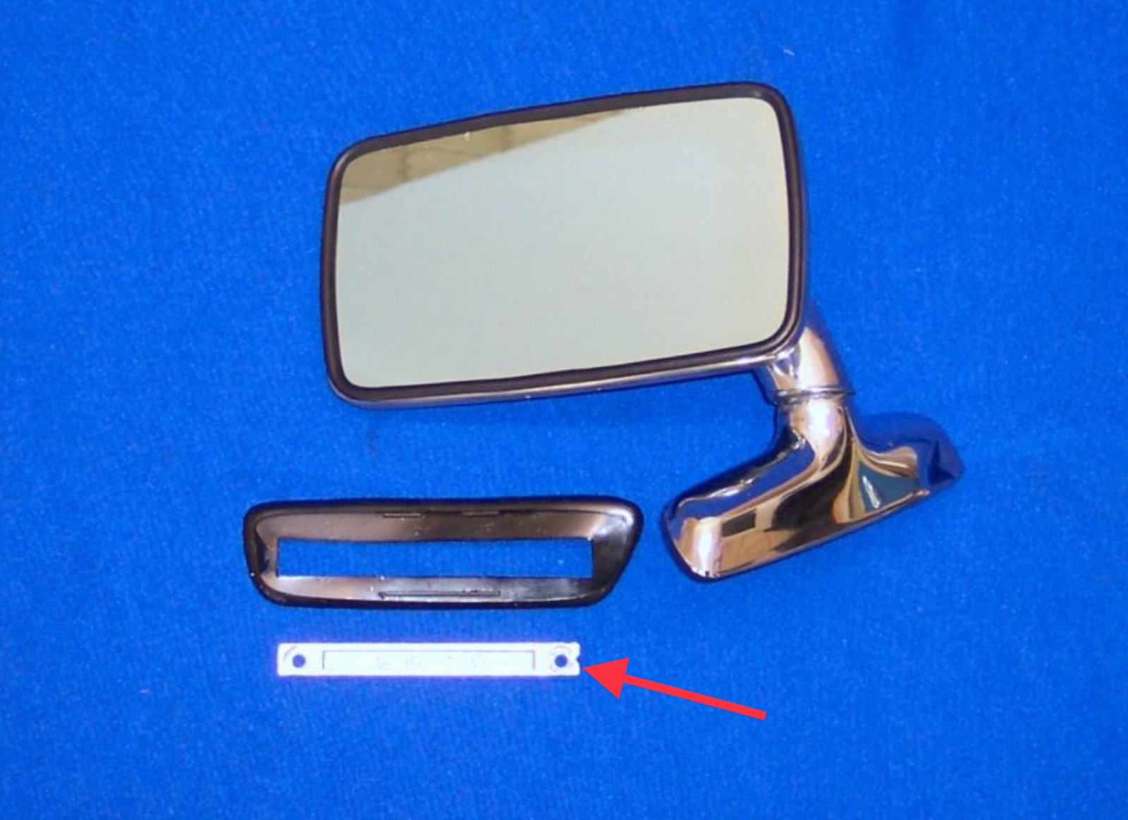

There’s a support bracket on the inside which has got loose
Pic shows it
Be careful when tightening that screw. The lock/cage with nut behind it could fail and/or the metal on the door skin could get compromised.
It was either on this forum or the o2FAQ where someone posted that they drilled two holes into and put a band of sheet metal (e.g., 1/2" x 5") on the inside of the door to distribute the tension and protect the door skin. If mine were to fail, I'd remove the door panel and window to the same.
Torque lightly. If the nut cage is broken, I believe all the usual vendors have it. If not, check Vintage Autobahn.
