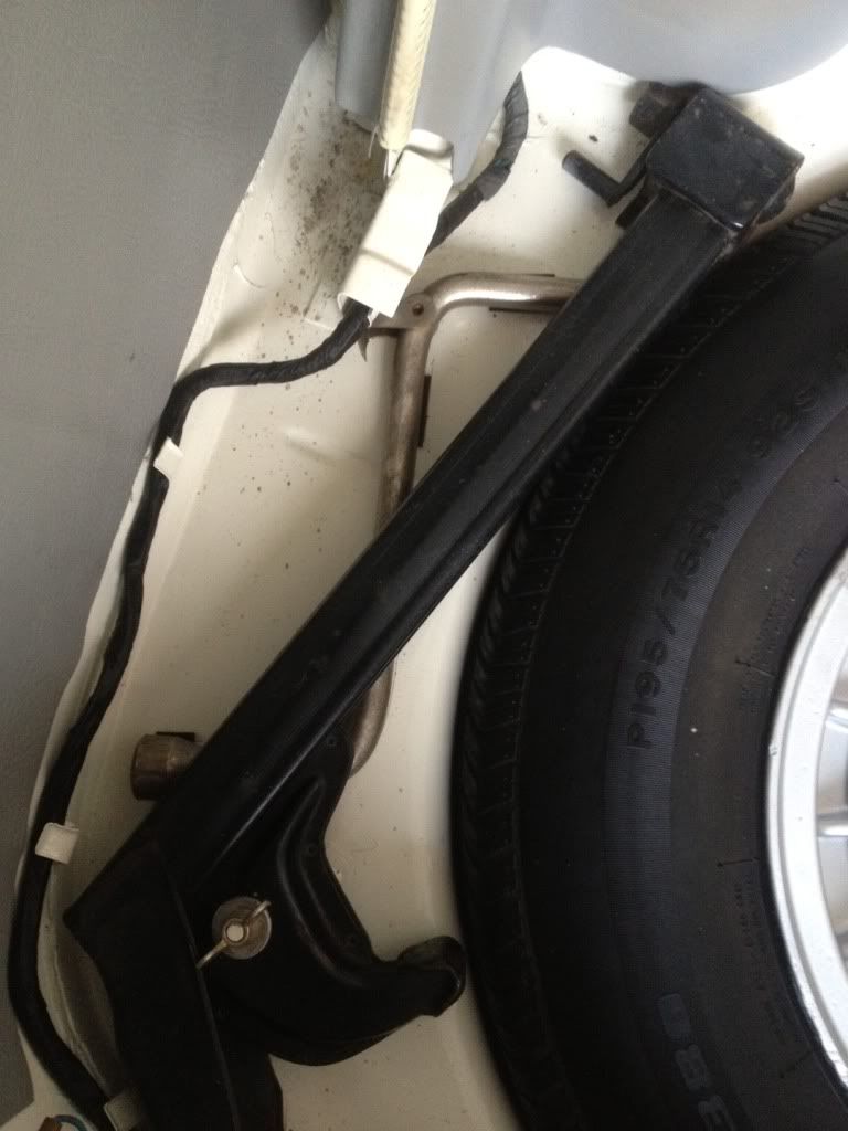

post it here! Mine is secured under the jack but am not sure it's exactly correct.
That looks good towel keeps everything from scratching finish and would come in handy for a tire change hand wipe. I'm in the process of cleaning up the trunk , adding new wheelwell covers and generally spiffing everything up with vinyl paint.

yea i actually wrap the towel around the entire jack to keep it snug - pulled it away for the pic

The original storage method used 1/2" X 3" foam pieces to cushion at both ends of jack with lug wrench located beneath the jack and also padded to prevent metal to metal contact--was too soft and would absorb moisture. Today 1/2" closed cell foam would be best to use.
Correct hold down hardware is and should be with a wingnut for a finger tight fit--not with a standard nut!
