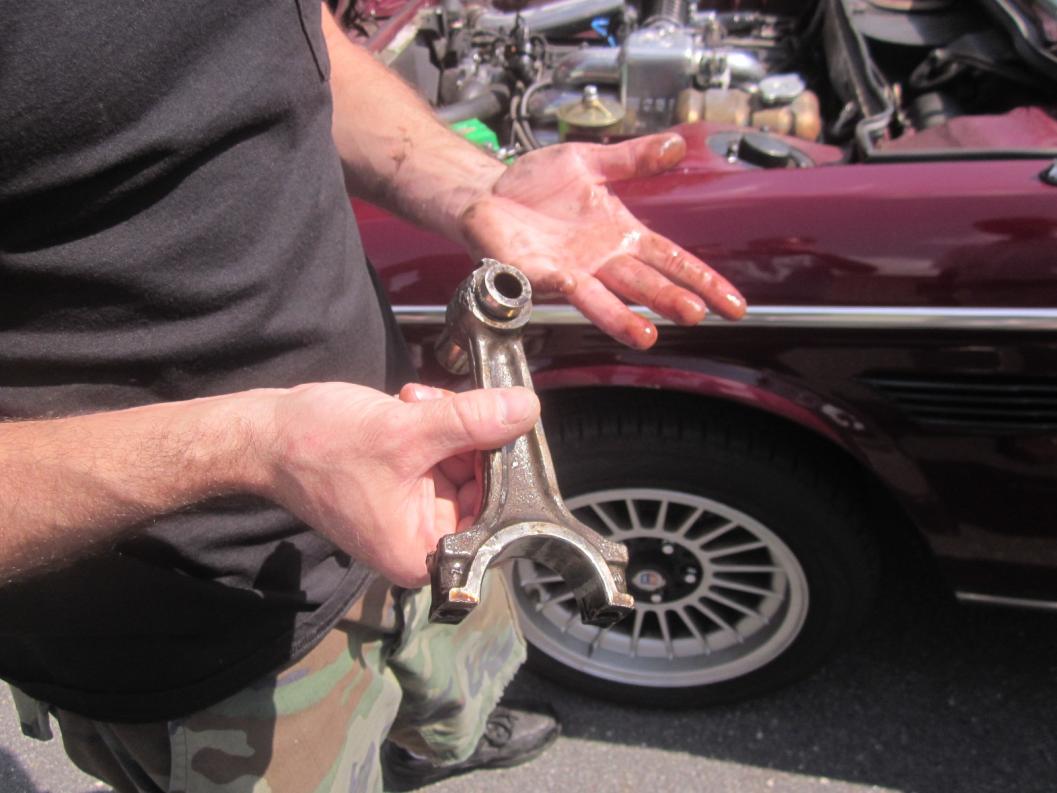

I am sorry to report that we lost the motor in my Luigi CSL today at the Rolex Pre-reunion race.
The #1 rod bearing failed coming out of Turn 4 at about 6500 RPM. The cap came apart and punched holes in both sides of the block.
The car will still be in the paddock next week if you are attending the races and would like to come by and lay a wreath on his now dented hood. Something hit it pretty hard from the underside.

Same thing happened to my friend Bow Gray just before The Vintage in NC 2014.

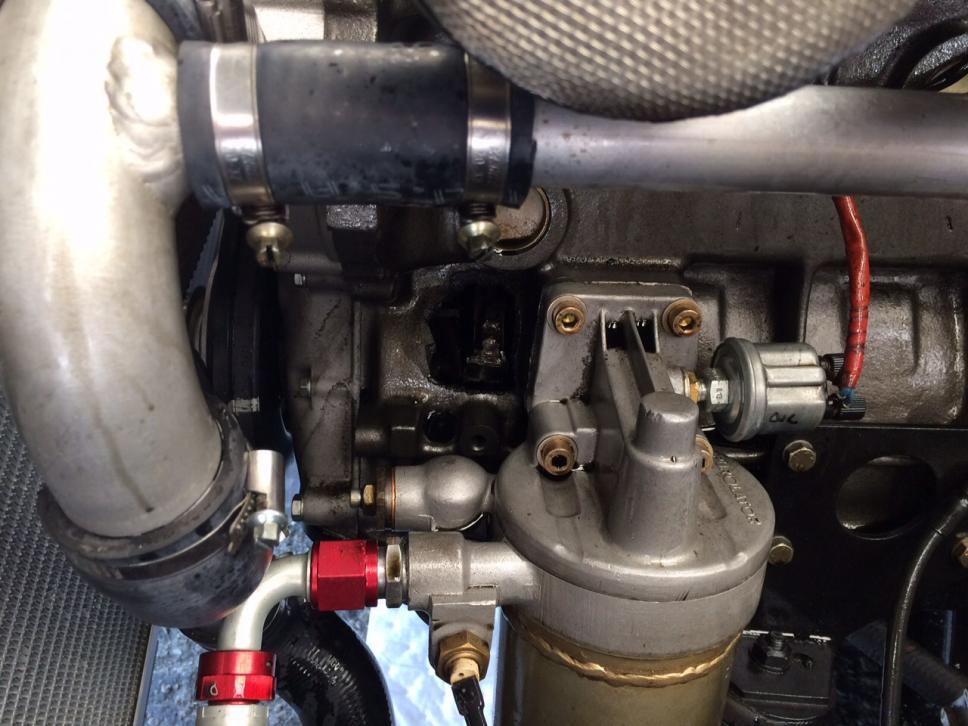

It looks like the head is fine, and all the Alpina induction bits are fine. Hopefully the Alpina oil pump didn't suck in any shrapnel. I'm guessing the crank is toast, and we will be looking for a well seasoned M30 block.
Since the car is dry sumped we are at a loss for why it starved for oil. One thought is an air leak somewhere in the line running back to the reservoir tank in the trunk. Once we get the car back home we will be able to do a full post mortum.
