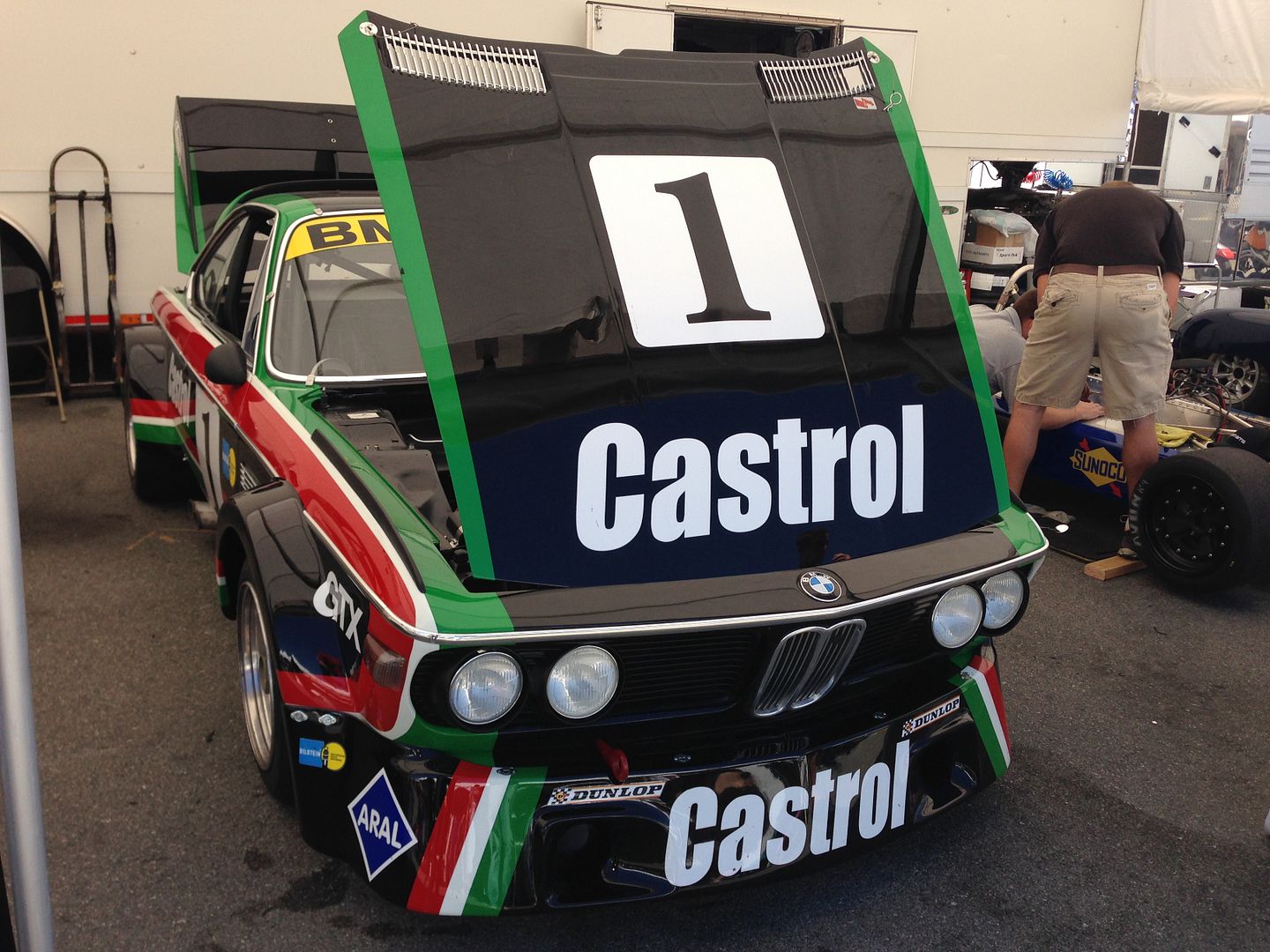

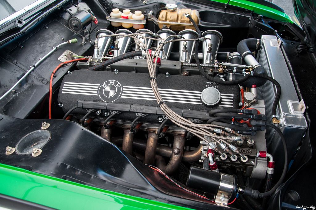

Steve, sorry I missed you when I came by. Took a few shots of your glorious car- I especially like the underhood view! (My own Alpina lump, from Finotto's shed, is about to get on a boat to California at last…)

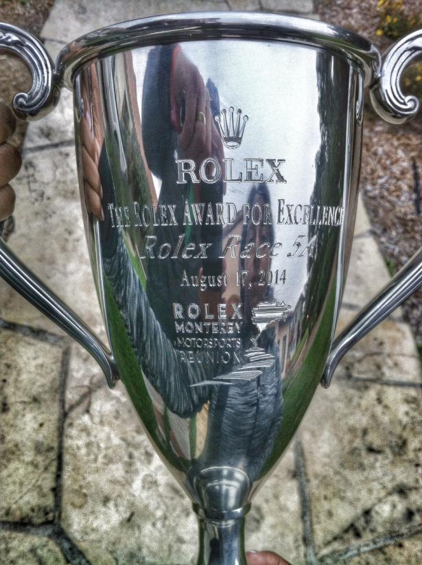

Well, the cherry on the weekend came at the awards ceremony Sunday evening. Luigi was awarded the Rolex Award for Excellence for Group 5A!
Much thanks to Terry and Jim from Racecraft for all their hard work. The award is a reflection of their dedication and expertise.

A friend of mine asked a question I couldn't answer. What is that green tipped hose on the firewall for?
Congrats! I'm used to seeing haggard 10 footer race cars, but your Coupe is immaculate.
Thanks for your kind words.
It is the discharge nozzle for the fire system.
