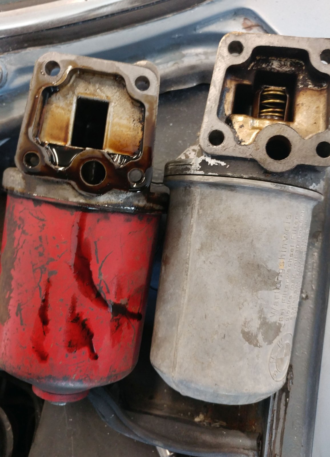

So the one on the right is what we want, right?
Came off an E12.
