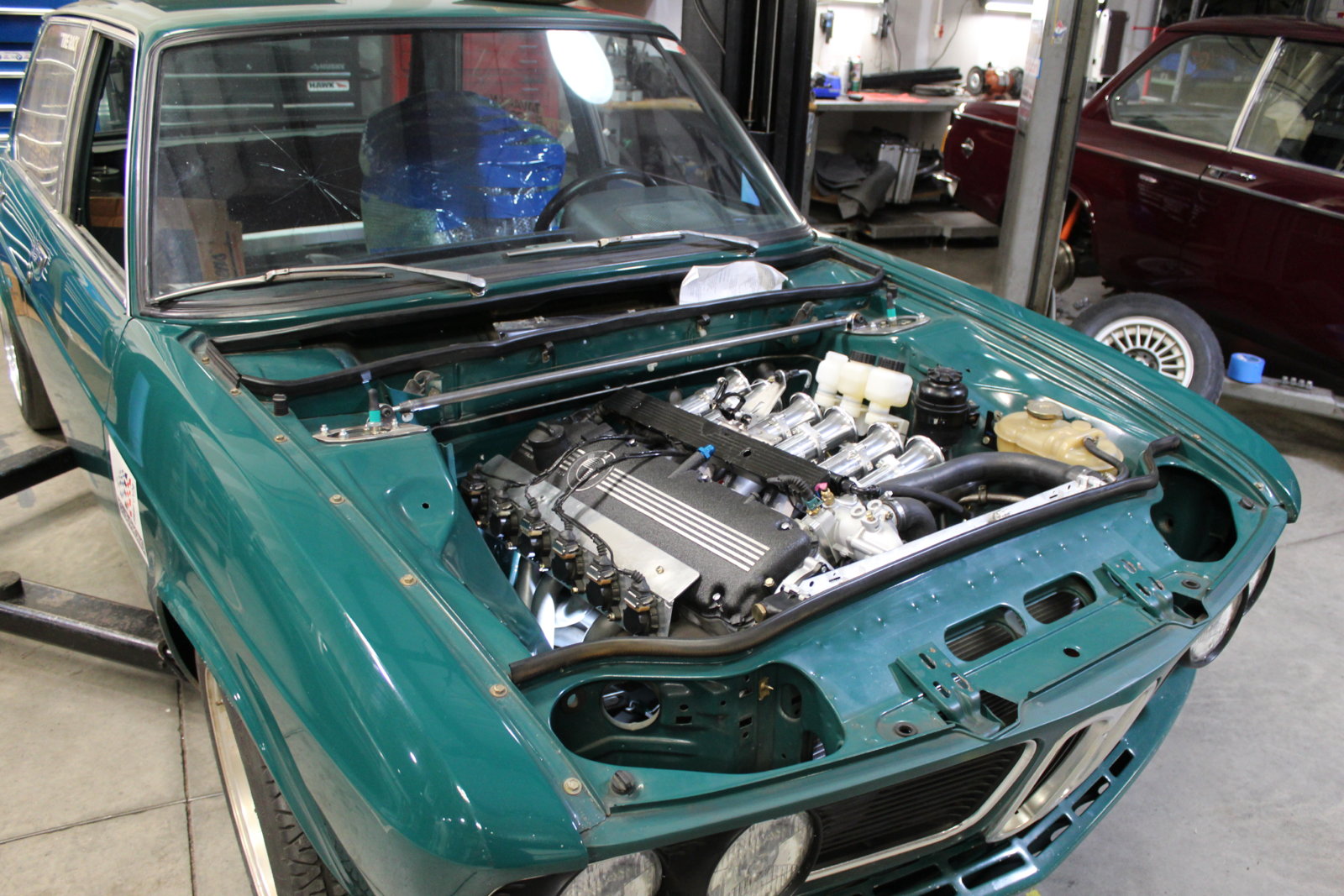

this is my currant project , restoring / modernizing this 72 race bavaria , I should have some data in a month or so

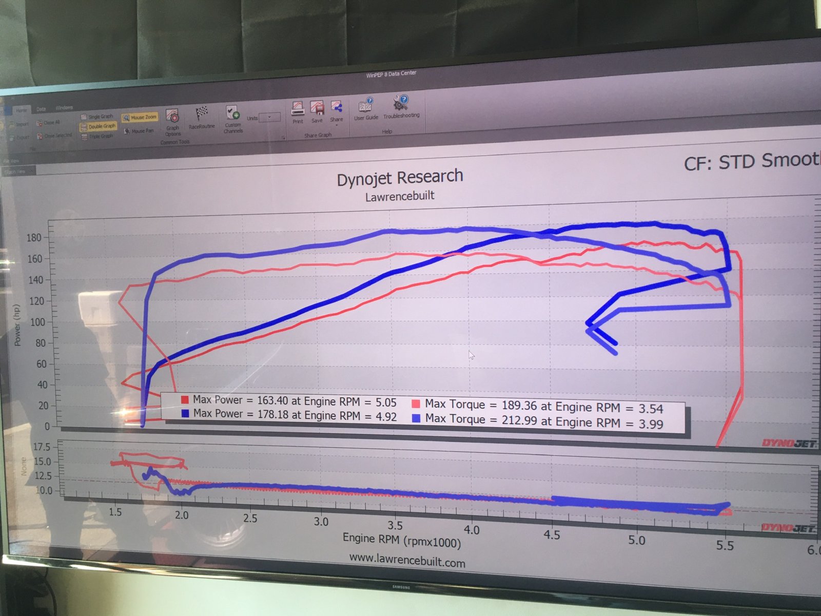

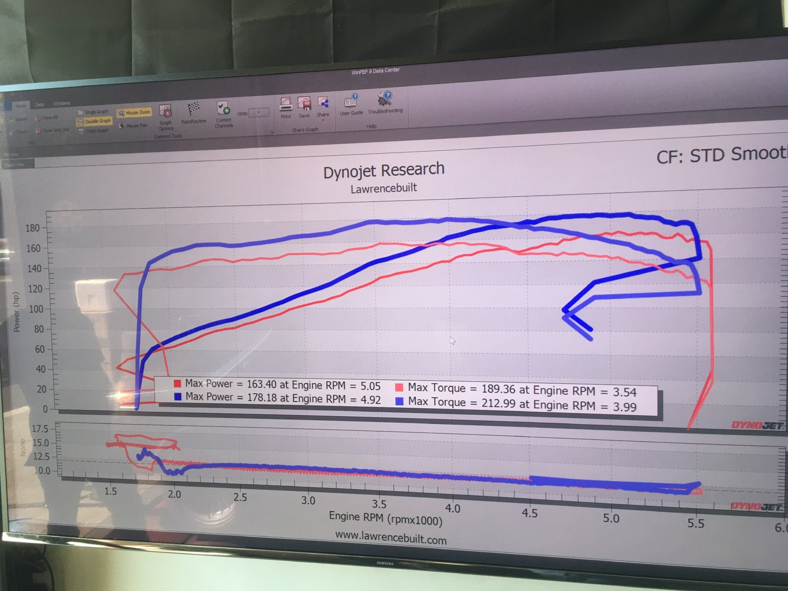

Megasquirt, M90, big C-tubes, mild cam…. 2 weeks ago Dyno
about 250 ft/lbs at the crank. I build and tune for torque and drivability.
In my opinion- 250, that’s plenty for a daily driver.

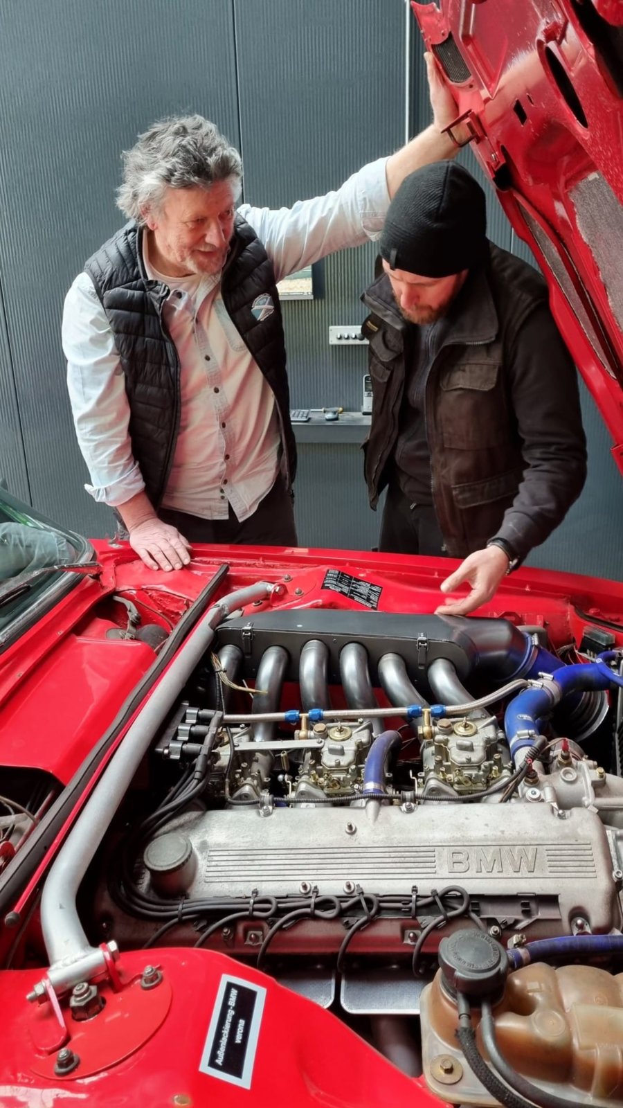

i have 236 ft/lbs and 225 HP with a stock 3.5 L( '86) , triple webers , KMS ingnition ECU & coilpacks , and Schnitzer headers. ( and big custom exhaust )
