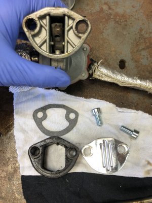

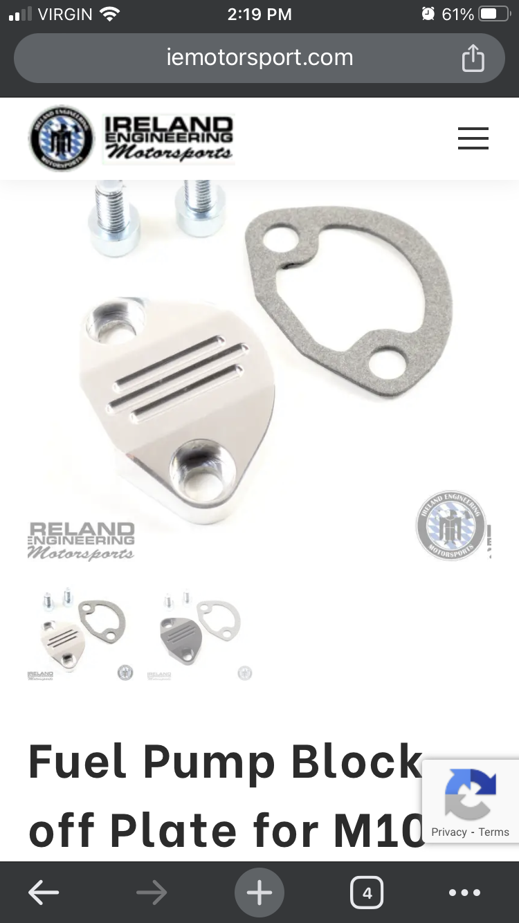

I’m having trouble finding any information in regards to the correct block off plate after deleting the old mechanic fuel pump off the M30 engine. On the forum or online. I’ve found a example for sale from Ireland engineering but it says that covers the M10 engine. Can these be interchanged with the M30?

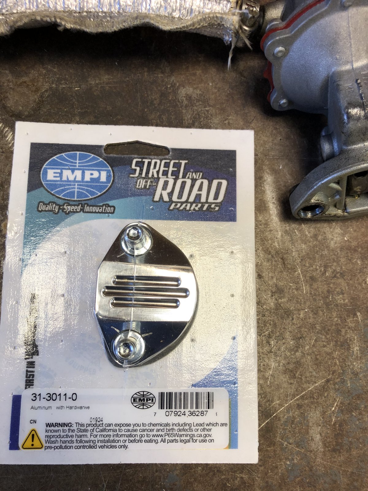

That will work. Also the same as VW air cooled as I recall.
I bought this one and it is a good fit.
Yes ok the EMPI did come up as well in my search. I just wanted to confirm before ordering. Cheers

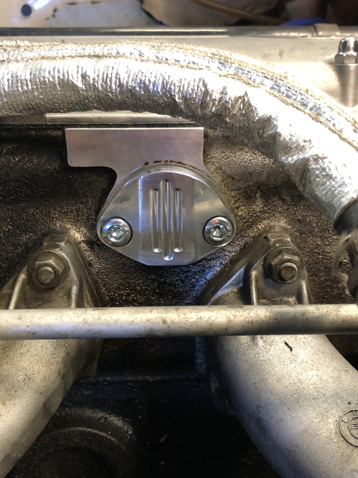

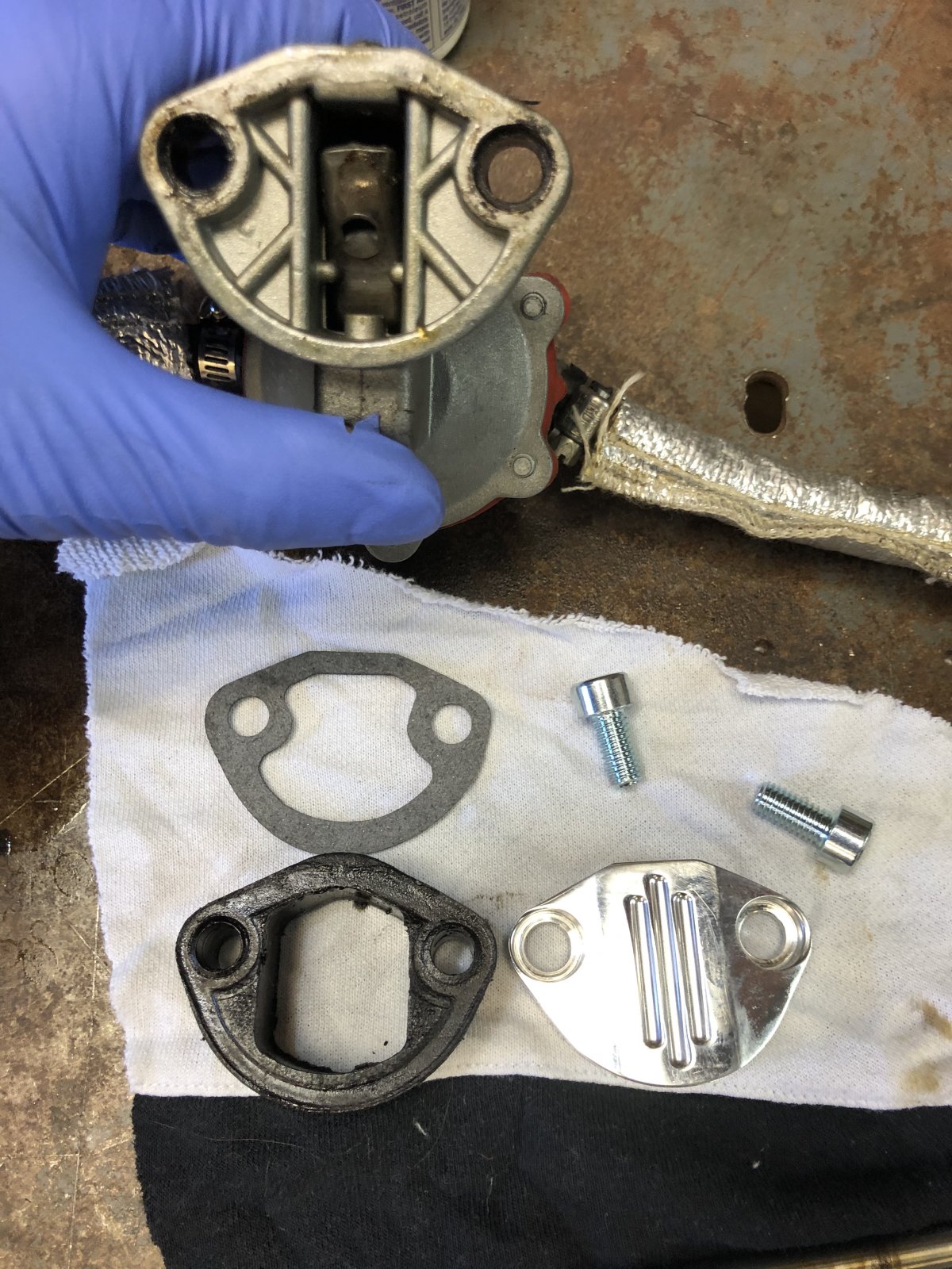

The EMPI 31-3011 looks like it’s going to work out just fine.
