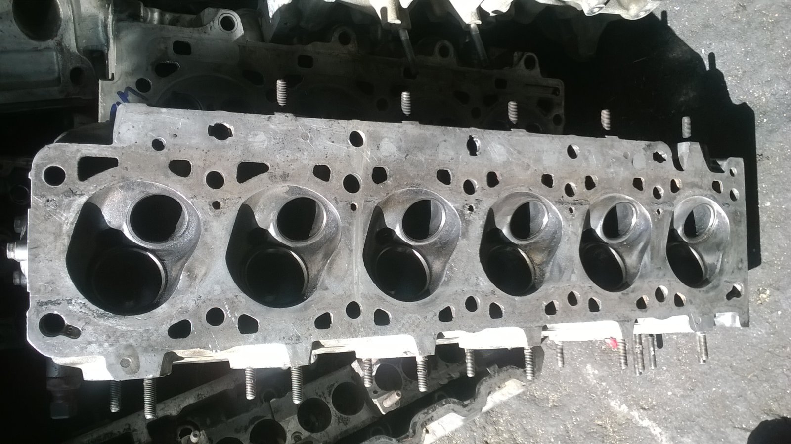

Now I am told somewhere in my engine block there is crack damage whatever... It is in the picture.

Yep, crack between the water channel and the head bolt hole, also looks like someone welded up another similar crack or several, before.
Unfortunately you can't use B30 89mm pistons in a B35 which uses 92mm pistons.

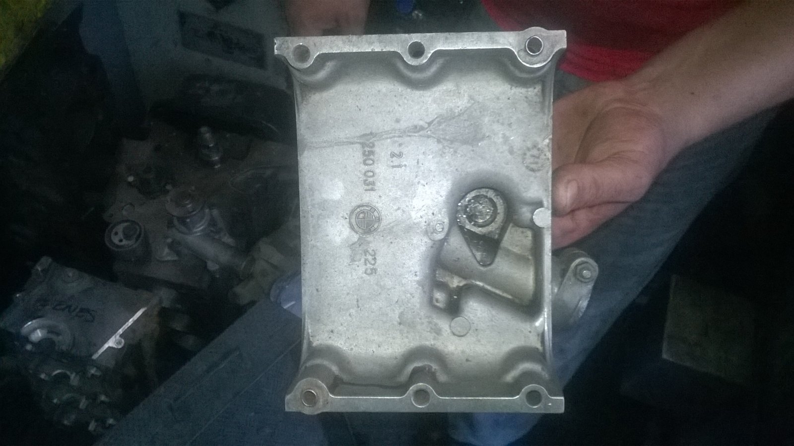

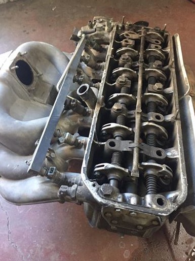

Current head was not good so I bought a good used one. We did a water test before buying it.

Okay, that's the -82 or newer head, which is better than all the pre -82 heads (less prone to cracking). There's dimples visible, so it's not shaved too much and still within spec.
If you could provide the year casting, it would be easier to know which head it is, and if it would fit on a B35.
Somebody tightened head bolts that still had oil in them.
Block is junk I think.
