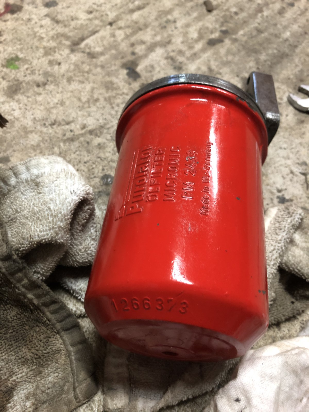

then I remove the oil filter and activate the starter and the oil comes out

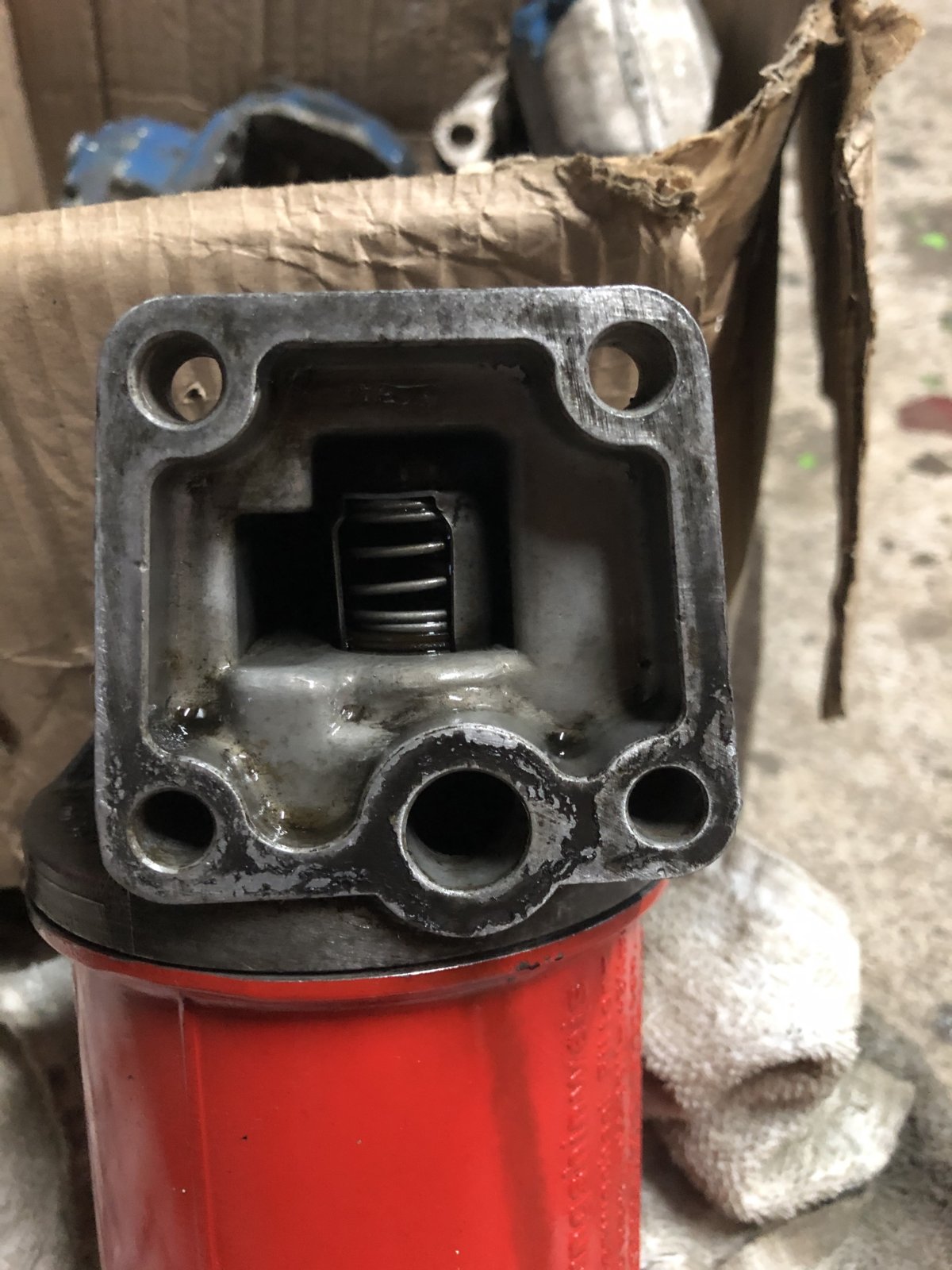

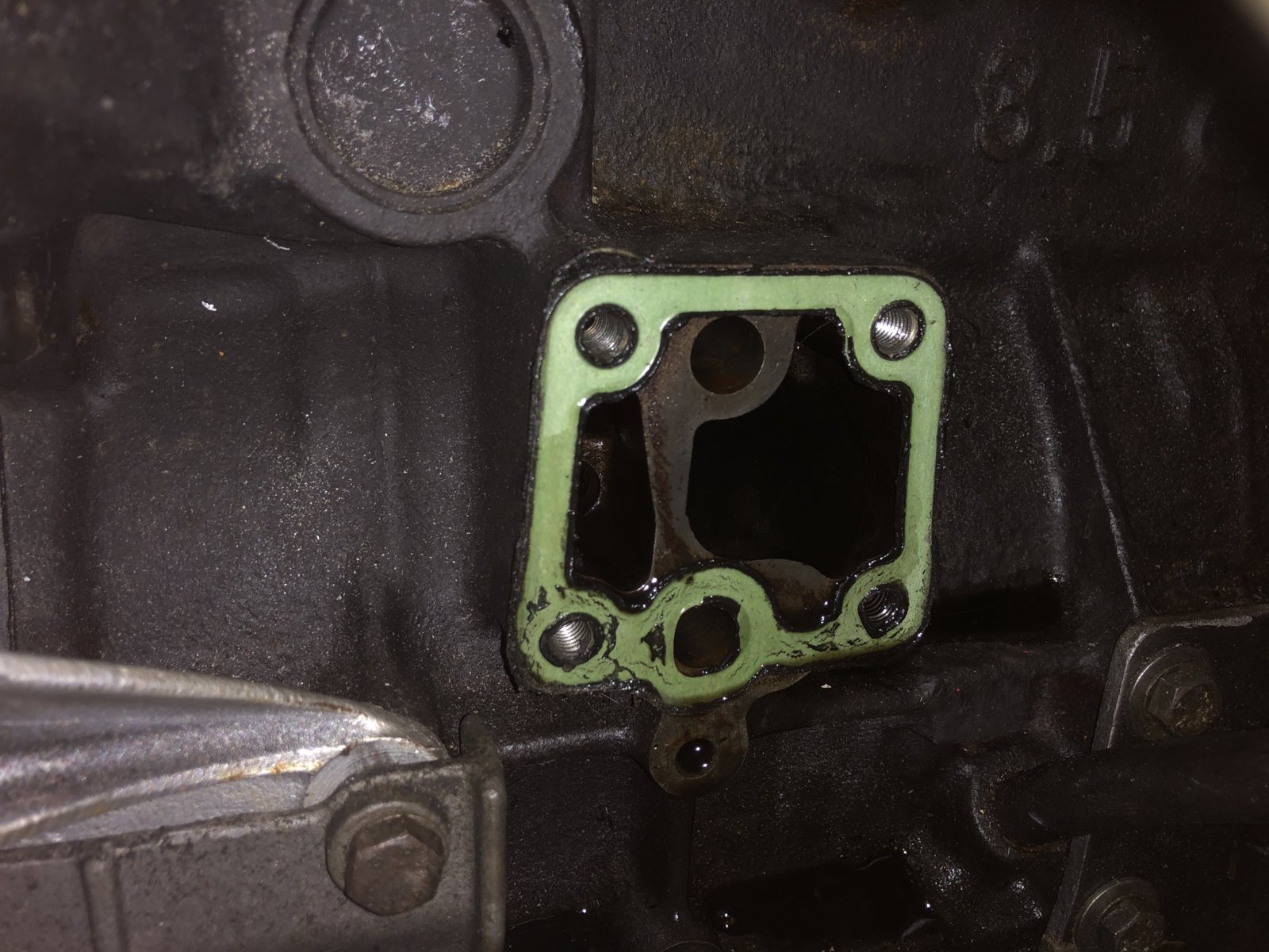

I replaced the oil filter support of my late m30b35 for an older one, and the gaskets do not really match, can my concern come from there?
I will recover the original filter holder from the m30b35 and compare them

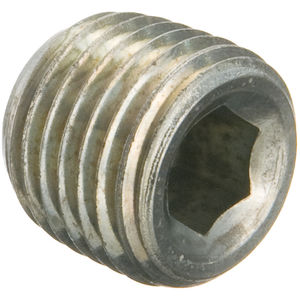

at the bottom of the left hole, the smallest, there is a threaded hole in which I can put a screw to force the oil to rise
I had thought of putting back the original oil filter support to solve my problem
A 1/8th NPT pipe plug works perfectly. Get the internal hex driven one because you can't get a wrench in the hole.
