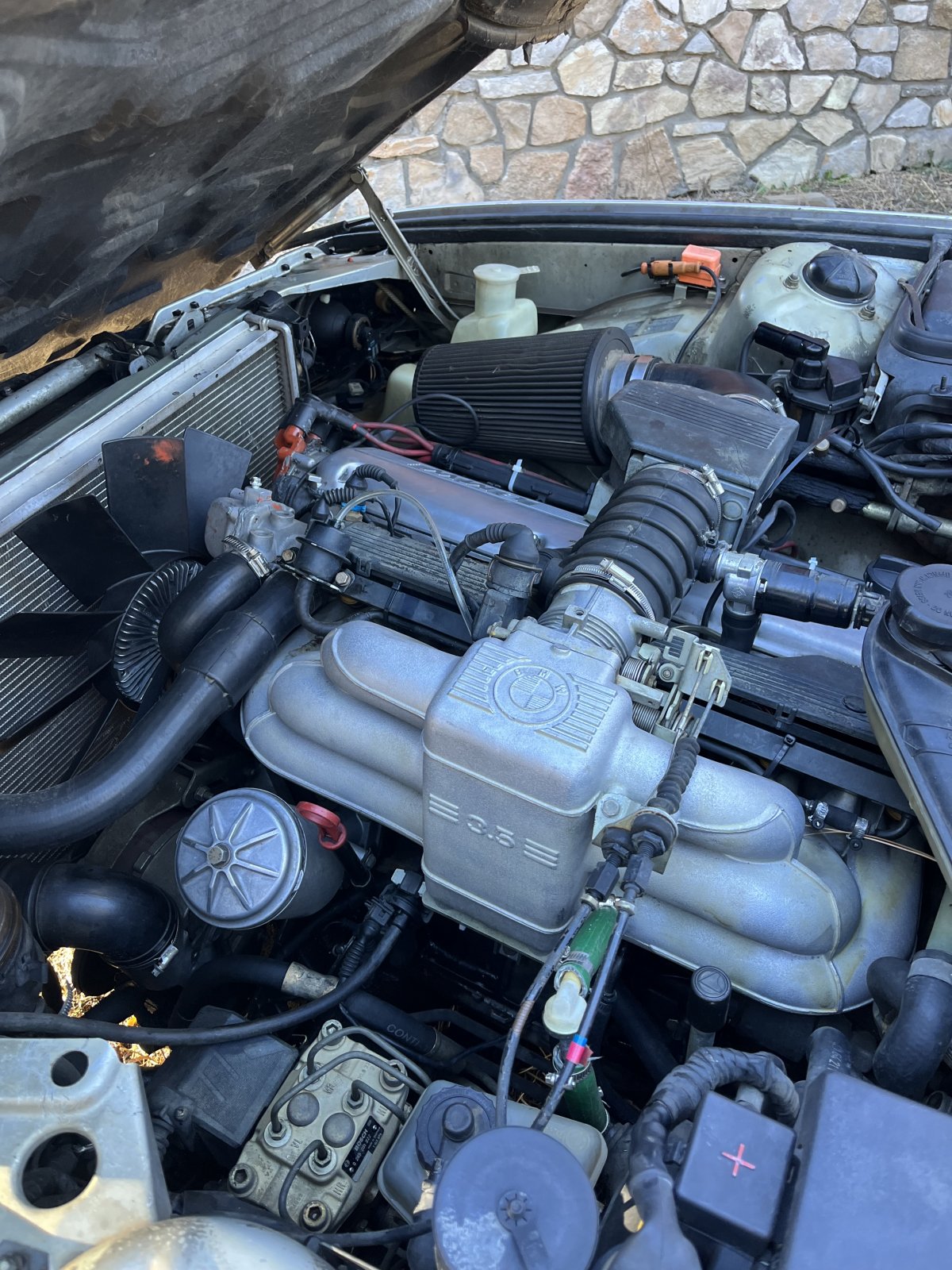

Good luck with the engine swap. I did this about 5yrs ago using an M30B34 engine from an EU spec 535i mated to a 5sp box. We decided to go with direct to head throttle bodies from Jenvey and a new ECU (Emerald). Sounds awesome and adds some eye-candy to the engine bay. Something worth considering and it made all the electric/electronic integration you mention relatively straightforwards.
Not my car, but some info here.
