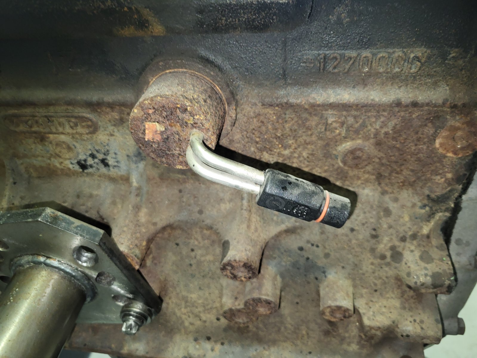

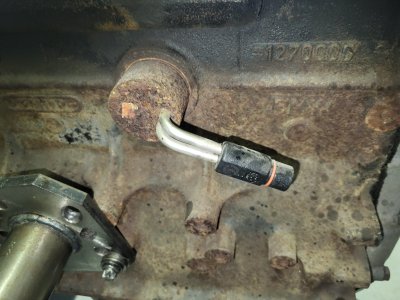

M90, confrimed by SFDon:
white painted 'L'
engine #

None of your photos seem to have posted.
